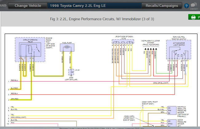

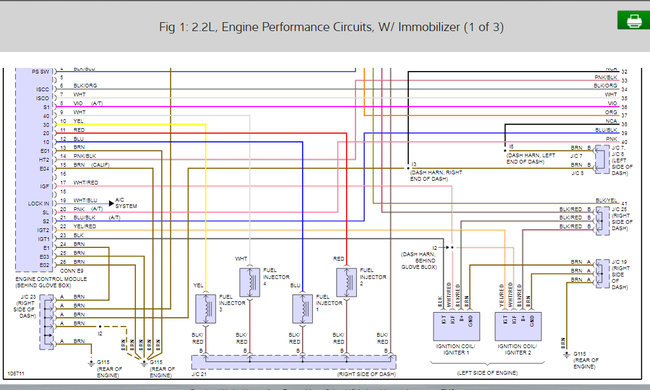

Last week in the morning the car started fine. Drove it ten miles to work. When I got off I went to start the car and it didn’t start unless I sprayed starting fluid. It would start for two to three seconds and turn off. I contacted three of four mechanics and auto part stores like AutoZone and all of them told me my fuel pump is bad. So I ended up getting the car towed and today I brought a new Bosh fuel pump and strainer. I connected the new fuel pump to the electric cable to see if it works. Not surprising the new fuel pump worked. So I ended up hooking the original fuel pump to the eclectic relay and to my surprise the original fuel pump worked the same way as the new one. So I ended up putting the old fuel pump back in the tank. Drove the car sixteen miles and it drove fine. I come home wash it and start it. The fuel pump went out again. I do no know what the issue is? The fuel pump worked fine and now I don’t hear anything. Could I need a whole new fuel pump module? If it was the fuel pulp fuse, then the fuel pump wouldn’t get power at all. Not even the new one.
Tuesday, April 9th, 2019 AT 6:02 PM
SCGRANTURISMO
  • 4,897 POSTS

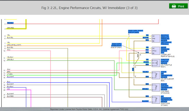

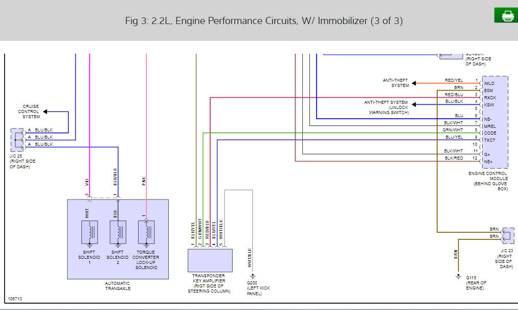

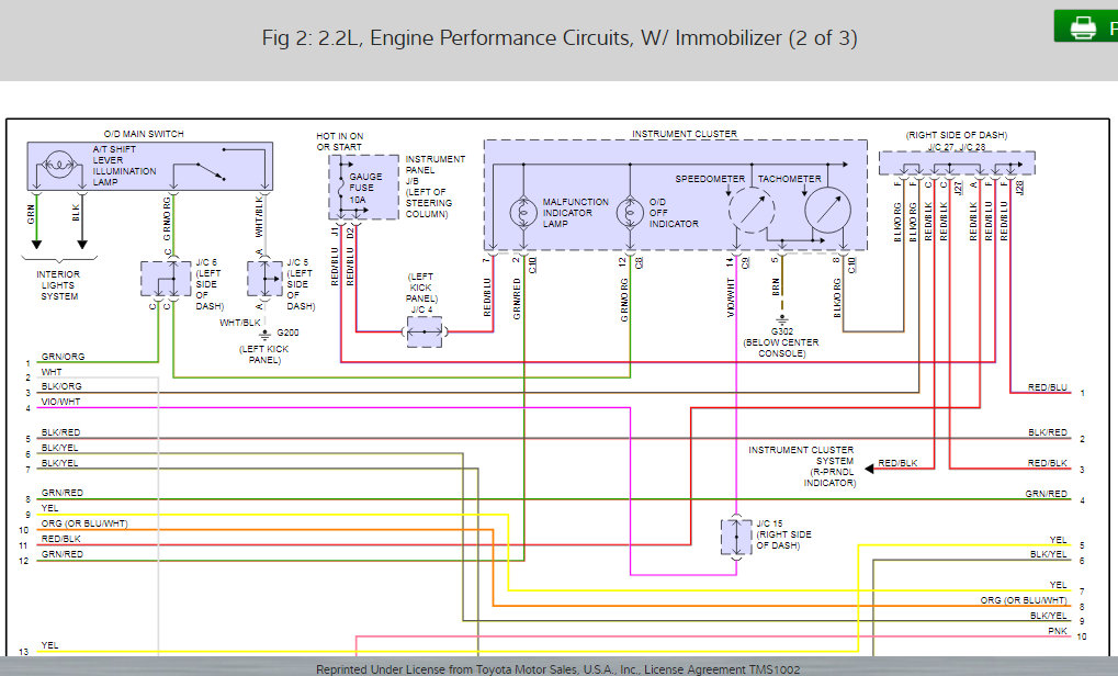

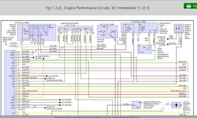

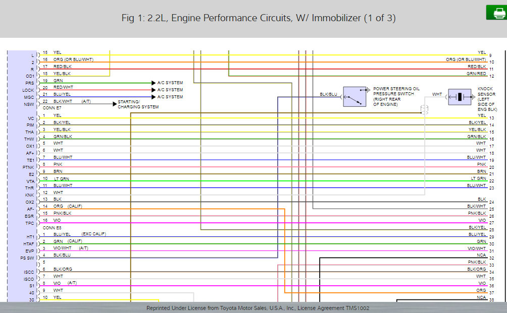

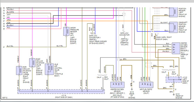

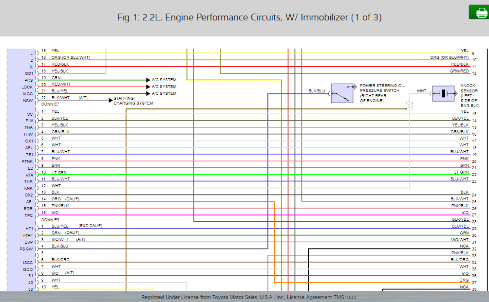

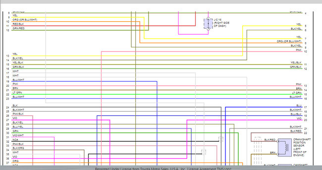

This could be a problem with the Circuit Opening Relay. It is located in the RB 1 on the left side of the engine compartment. I have included the wiring diagrams for you in the diagrams down below for the Engine Controls. The Fuel pump is on diagram #7. I have also included a link below for you to go to:
Please go through these guides and get back to us with what you are able to find out please.
