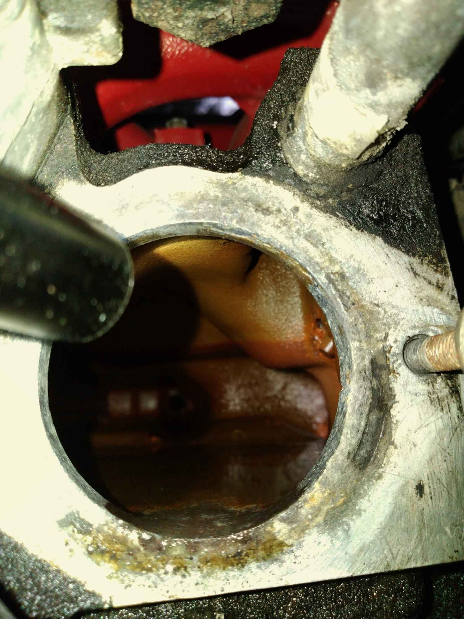

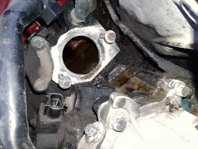

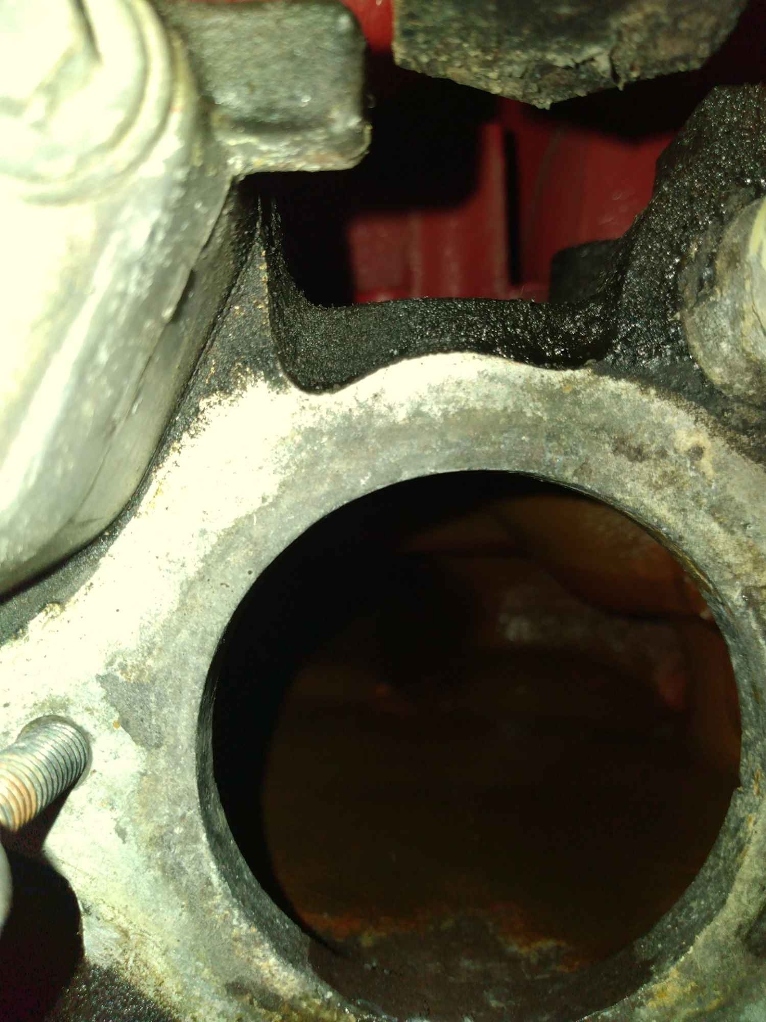

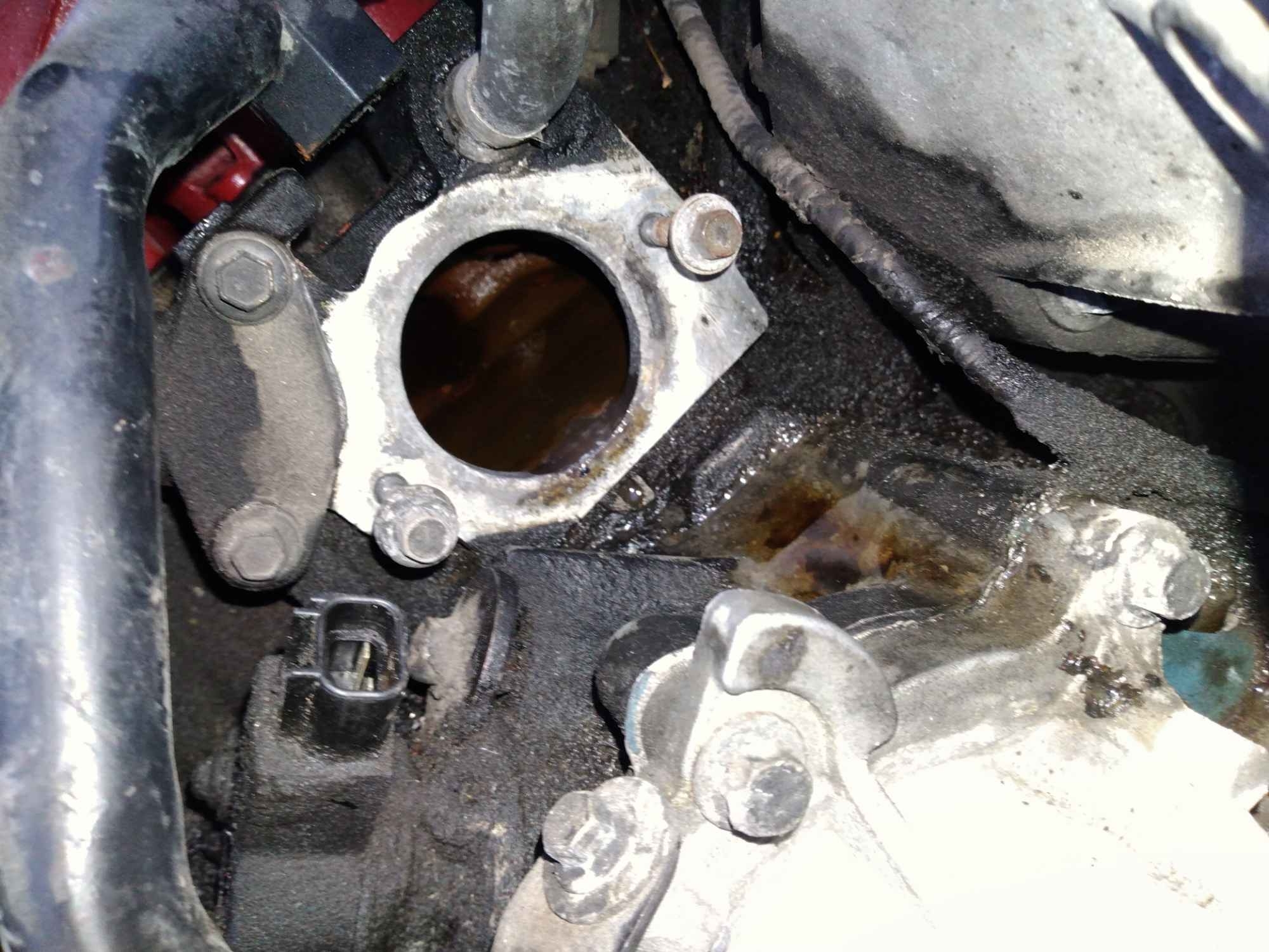

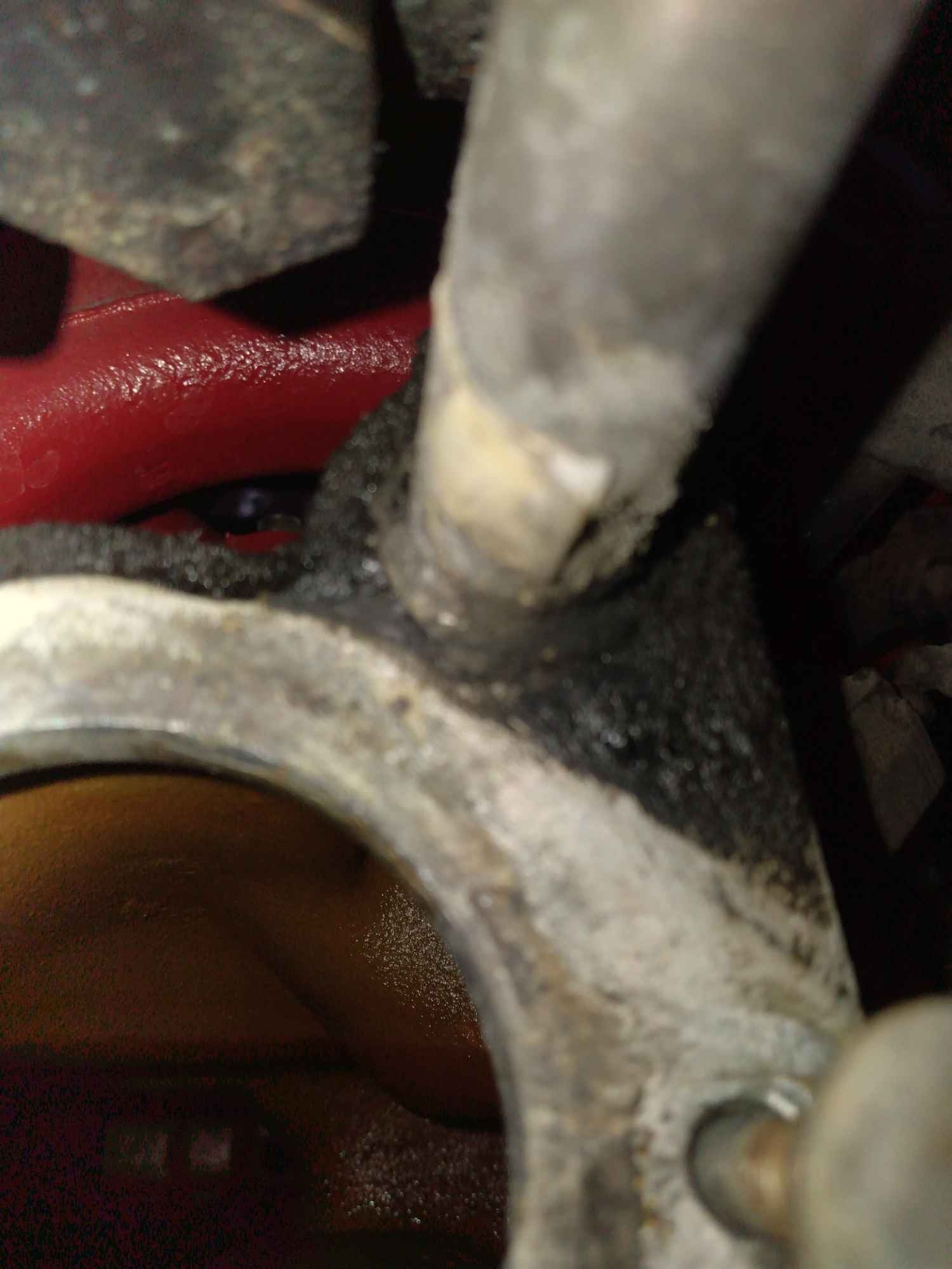

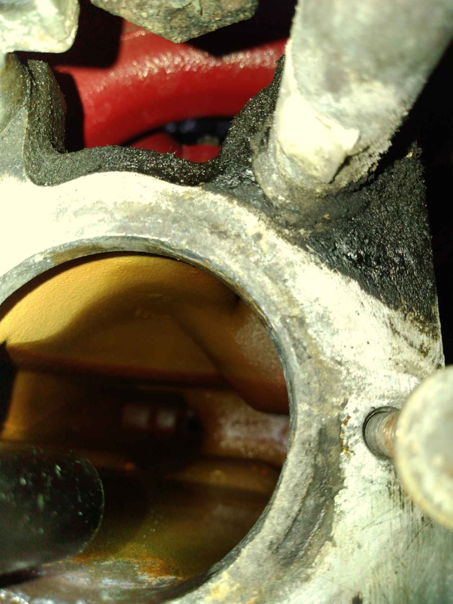

Is that too rusty?
Feb 5, 2023 at 8:25 AM
  • 110,240 POSTS
Actually, that looks really clean. There is no restriction there.
