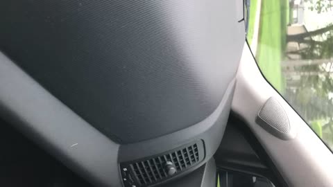

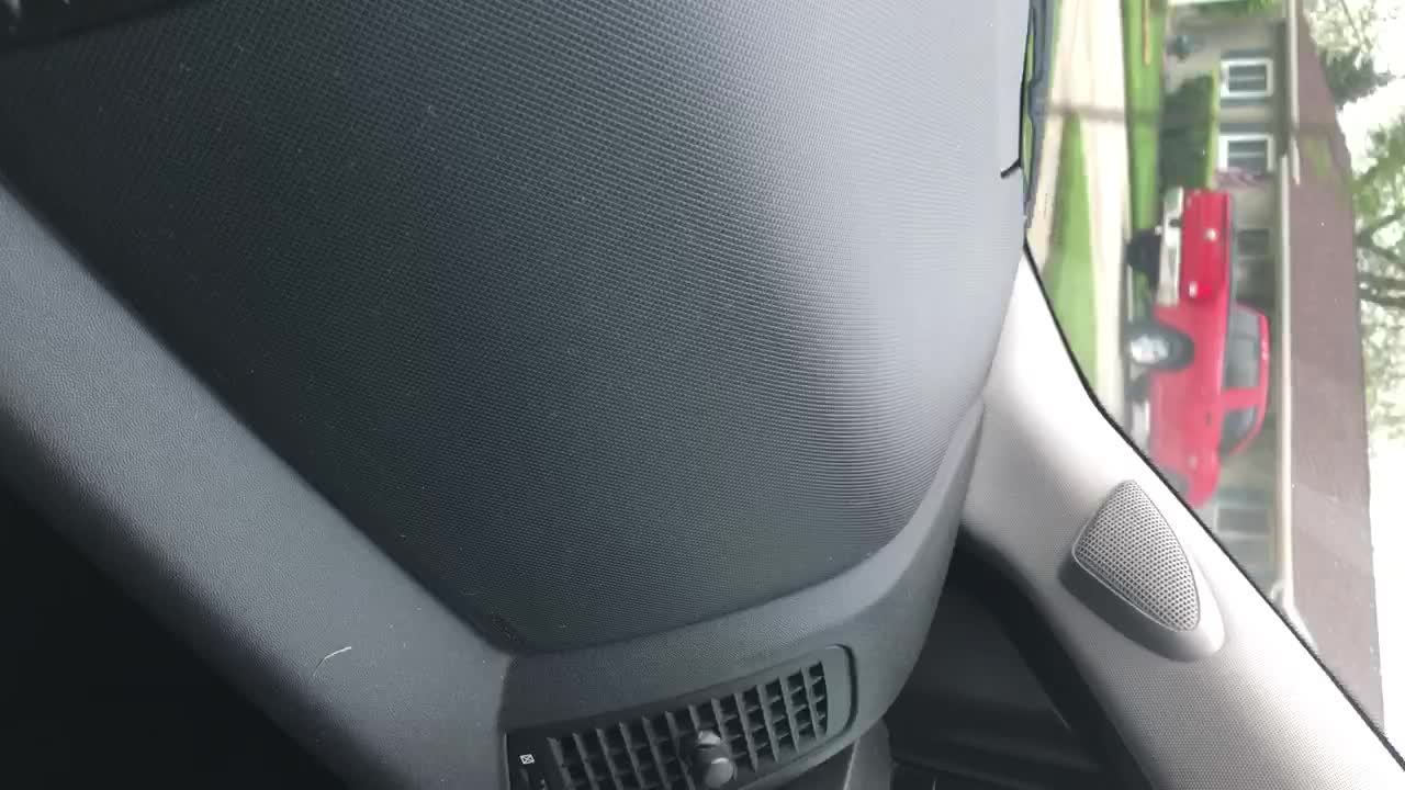

GODISGOOD2ME2020
Here is video of the noise I’m hearing from my car.
May 23, 2020 at 5:37 AM
I am assuming you have the 3.6L? The fact that this is only happening on acceleration, I suspect this video is going to address the issue. It is just a matter of determining which one.
https://youtu.be/OTeg2CUB5NE
What grade fuel are you using and when is the last oil change that you have done on the engine? Let's check the engine oil level and if that is okay, the next time you need fuel let's get an octane booster from a parts store and then put 5 gallons of high test (93 or better) then put the full bottle of booster in it. Give it about 25 miles and then see if the issue is better or gone. If it is then this is detonation or spark knock.
Let's start with these things and we can go from there. Thanks
