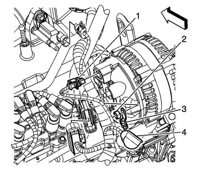

GENERATOR REPLACEMENT
Generator Replacement (LNJ) (3.4L)
Removal Procedure
pic 1
1. Disconnect the negative battery cable. Refer to Battery Negative Cable Disconnection and Connection (See: Battery Cable > Removal and Replacement).
2. Remove the drive belt. Refer to Drive Belt Replacement (See: Drive Belt > Removal and Replacement > Drive Belt Replacement).
3. Disconnect the engine wiring harness electrical connector (1) from the generator.
4. Reposition the engine wiring harness boot (4).
5. Remove the generator terminal nut (2).
6. Remove the engine wiring harness terminal lead (3) from the generator.

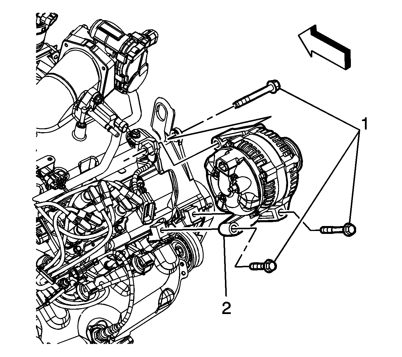

pic 2
7. Remove the generator bolts (1).
8. Remove the generator (2).

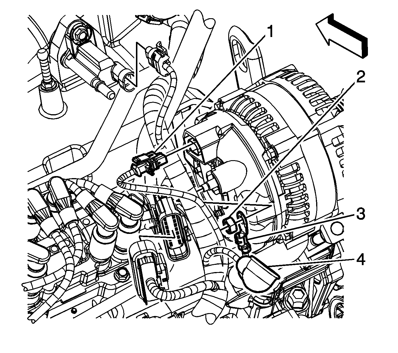

Installation Procedure
pic 3
1. Install the generator (2).
Caution: Refer to Fastener Caution (See: Vehicle > Vehicle Damage Warnings > Fastener Caution).
2. Install the generator bolts (1) and tighten to 50 Nm (37 lb ft).
pic 4
3. Install the engine wiring harness terminal lead (3) to the generator.
4. Install the generator terminal nut (2) and tighten to 20 Nm (15 lb ft).
5. Position the engine wiring harness boot (4).
6. Connect the engine wiring harness electrical connector (1) to the generator.
7. Install the drive belt. Refer to Drive Belt Replacement (See: Drive Belt > Removal and Replacement > Drive Belt Replacement).
8. Install the negative battery cable. Refer to Battery Negative Cable Disconnection and Connection (See: Battery Cable > Removal and Replacement).

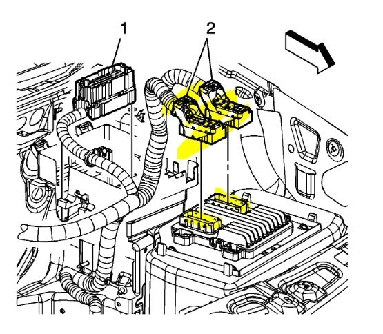

Okay, All the U codes are related to the serial data circuit. The serial data circuit is the means by which the control modules in the vehicle communicate with each other. So, if there is an issue, all kinds of things (as you experienced) can go haywire.
Now, you have P codes and one C code. The c code is related to the right front wheel speed sensor (ABS). The signal is erratic. The P0420 is related to the catalytic converter, P0700 transmission, and so on. The serial data circuit ties all of the modules together which control these components. Now, what really needs to be done is the vehicle needs driven with a live data scanner when the condition occurs. Live data on a scanner along with what is called freeze frame data can be used to determine where the initial problem starts.
Not to confuse you, but the only other thing that makes sense to me is the P0606. That code indicates there is engine control module (ECM) performance issues. When this code is present, either the ECM has an internal fault, needs reprogrammed, repaired, or replaced. The U2105 indicated there is lost communication with the ECM.
Please understand, I am not there and am providing information based on experience only. However, I think either you have a bad ECM or the connection to it is loose, corroded, or damaged in some way.
With all of that (sorry and hopefully I wasn't too confusing) the only thing you will be able to check at home is the ECM connections. Do Not disconnect any of the ECM wiring until the battery has been disconnected. Also, only reinstall the ECM wiring harness while the battery is disconnected. Once everything is back together with the ECM, then you can connect the battery.

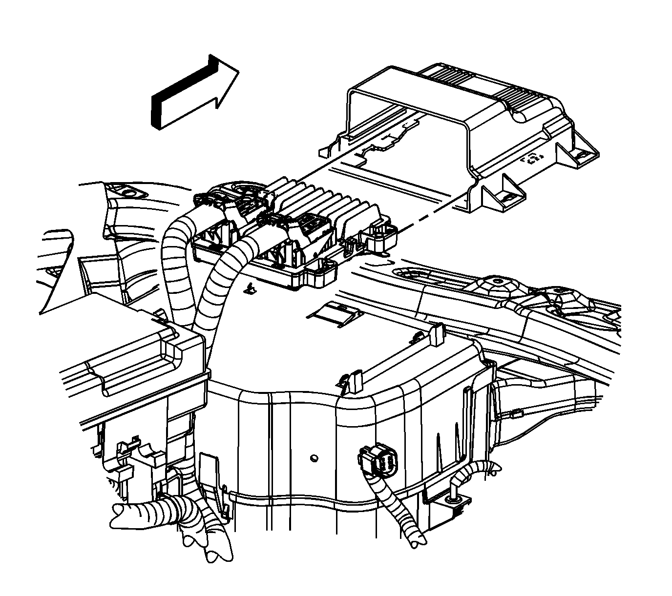

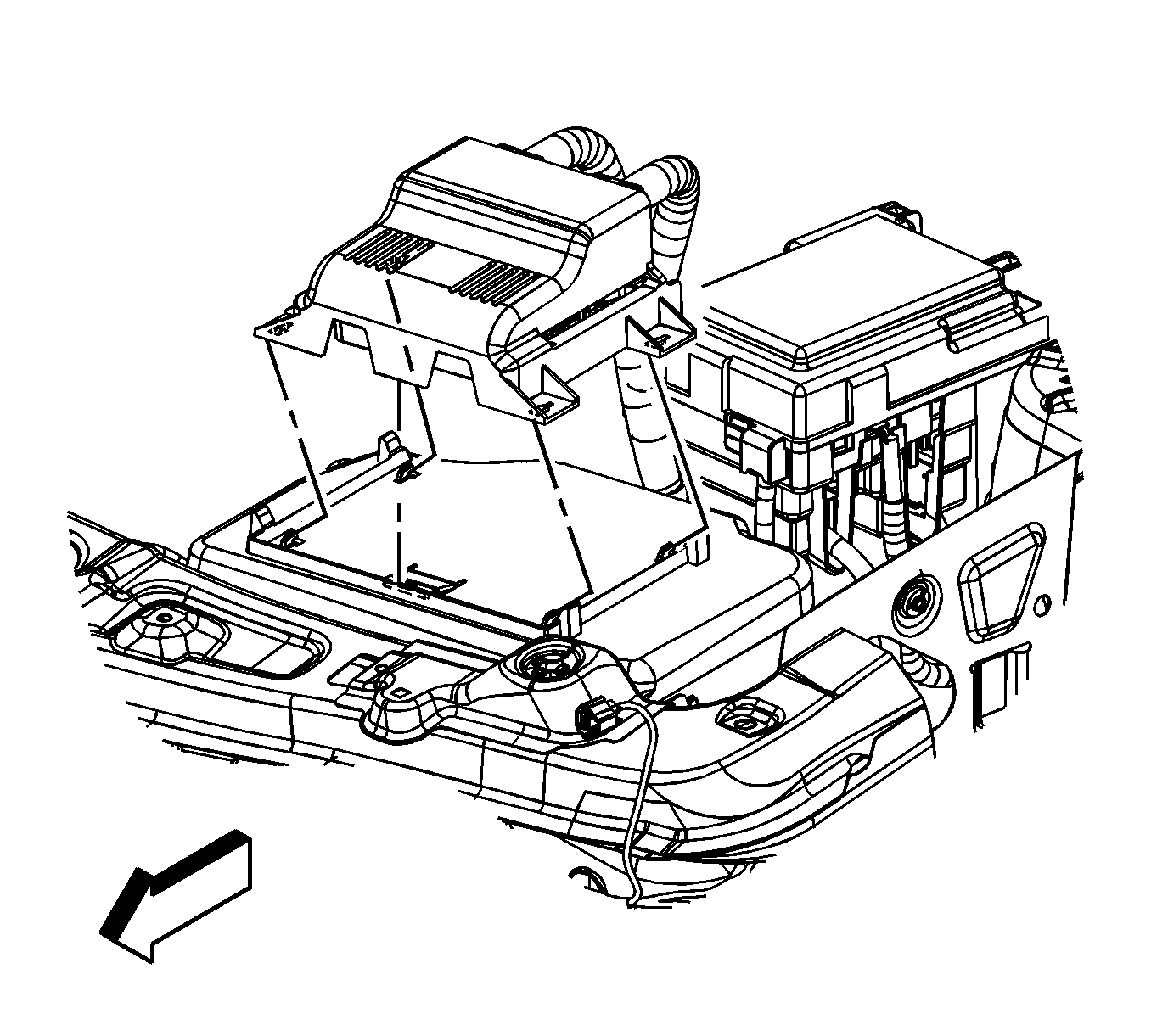

The ECM is on the battery shield and is covered with a plastic cover. I attached three pics below to show you what it looks like, how to remove it, and I highlighted the connections in question. Disconnect the battery, remove the wiring harness from the ECM and inspect for any damage, pushed in pins, corrosion, or anything that doesn't seem normal. Before you reattach it, I strongly recommend getting some dielectric grease at any parts store and put some on every pin and then carefully re-secure the wiring.
You could simply have a bad connection or something dirty. Once you do this, reconnect the battery and see if the vehicle still does the same thing. If it does, suspect the ECM may be bad and should be serviced or replaced.
Please let me know if this helps or if you have other questions.
