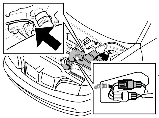

If you determine the sensor is bad, here are the directions specific to your vehicle for replacement. Picture 1 correlates with the directions.
ENGINE SPEED (RPM) SENSOR, REPLACING
Engine speed (RPM) sensor, replacing
Removing the engine speed (RPM) sensor
picture 1
Remove the pipe between the front cover plate and the air cleaner (ACL).
Disconnect the hose between the air cleaner (ACL) and the throttle body (TB). Put the hose to one side.
Remove the throttle body (TB).
Clean the gasket face.
Expose the wiring.
Disconnect the connectors.
Remove the sensor.
Installing the engine speed (RPM) sensor
Connect the connector.
Install
- the sensor. Tighten to 10 Nm
- wiring
- the throttle body (TB) with a new gasket. Tighten to 10 Nm
- the hose between the throttle body (TB) and the air cleaner
- the pipe between the front cover plate and the air cleaner (ACL) housing.
