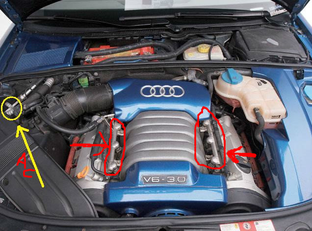

If the check engine light has come on, have the computer scanned. Also, pay attention to the security light. If it does it again, you may want to consider checking fuel pump pressure. Here is a video that will guide you:
https://www.youtube.com/watch?v=peh7-pFycyc
You will need to locate the schrader valves. I attached a picture of their locations.
