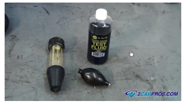

Let's start with using a laser temp gauge when it says it is overheating around the engine to see if the engine is actually overheating. The noises that you are hearing are typical of a cooling system on a turbo engine. However, the fact that it overheats so quickly sounds like a sensor issue or possibly a head gasket issue. If the head gasket is beginning to push out it would go pretty quickly like you are seeing because it is putting hot combustion chamber gases in to the cooling.
I would suggest getting the chemical test kit shown below and then getting the vehicle to the point you are describing and then performing this test to see if there are gases in the cooling system.
https://www.2carpros.com/articles/how-to-use-an-infrared-temperature-meter

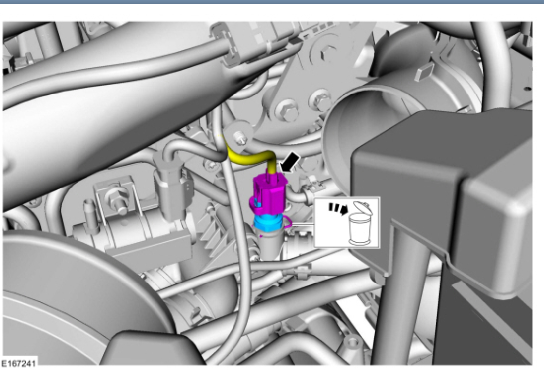

If you decide to replace the coolant temp sensor, here are the directions specific to your vehicle. The attached pics correlate with the directions.
_______________________________________________
2015 Ford Fusion FWD L4-1.5L Turbo
Engine Coolant Temperature (ECT) Sensor
ENGINE COOLANT TEMPERATURE (ECT) SENSOR
303-14A Electronic Engine Controls - 1.5L EcoBoost (118kW/160PS) 2015 Fusion
Removal and Installation
Base Part Number: 12A648
Materials
Name Specification
Motorcraft® Orange Prediluted Antifreeze/Coolant (U.S.)
VC-3DIL-B (U.S.) WSS-M97B44-D2
Removal
NOTE: Removal steps in this procedure may contain installation details.

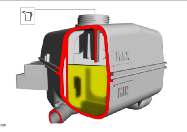

NOTE: When releasing the cooling system pressure, cover the coolant expansion tank cap with a thick cloth.
Loosen the coolant expansion tank cap.
Loosen: 2 turn(s)
Tighten the coolant expansion tank cap.
Torque : 2 turn(s)
Pic 1
Remove the air cleaner outlet pipe.
Refer to: Air Cleaner Outlet Pipe (303-12A Intake Air Distribution and Filtering - 1.5L EcoBoost (118kW/160PS), Removal and Installation) .
NOTE: Have the new component ready to install to reduce coolant loss.
NOTE: Be prepared to capture escaping fluid with a shop towel.

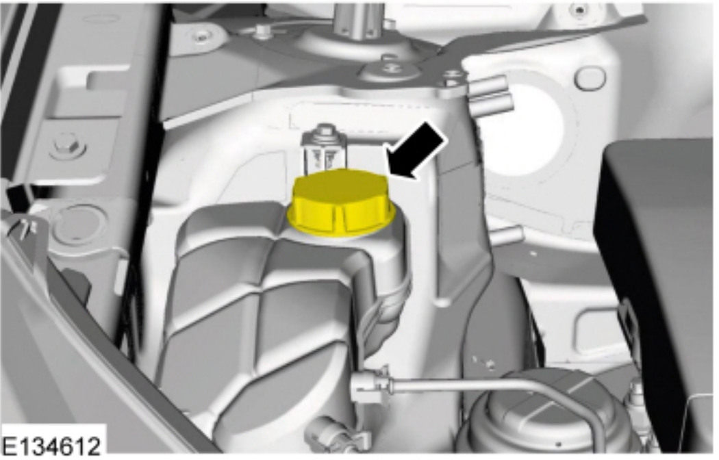

Disconnect the ECT electrical connector.
Release the retaining clip.
Remove the ECT sensor.
Pic 2
Installation
To install, reverse the removal procedure.
Check the coolant level in the degas bottle and add coolant as necessary.
Material : Motorcraft® Orange Prediluted Antifreeze/Coolant (U.S.) / VC-3DIL-B (U.S.) (WSS-M97B44-D2)
Pic 3

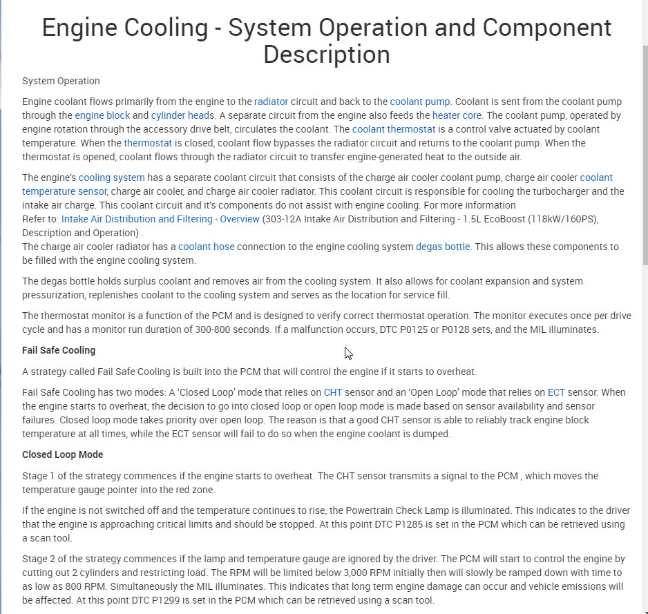

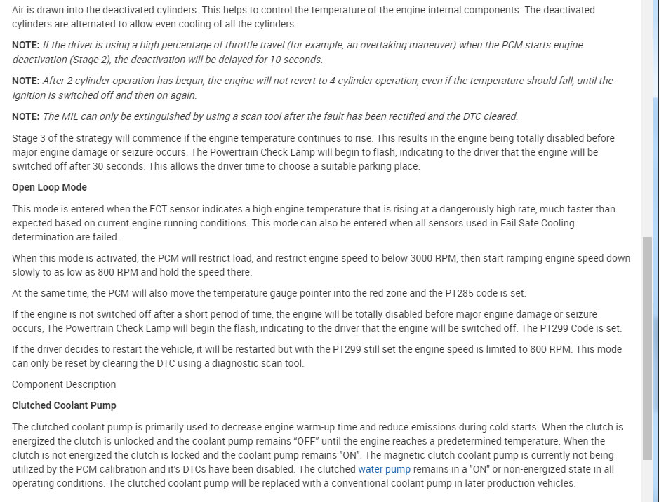

No. A temperature sensor will not cause coolant to overflow. I did not understand that this was happening. If you have coolant boiling out then you are actually overheating and this is not a sensor issue. That means we have heat coming from somewhere. Did I understand that the fans only kick on when you rev the engine? If the temp is getting to 220 the fans should be running.
It is odd that the temp jumps so quickly which makes me think there is a flow issue. Meaning the coolant in the radiator is getting cooled but not moving much. Then when you clear the code, it circulates and the temperature sensor picks up the cooler coolant and the gauge drops.

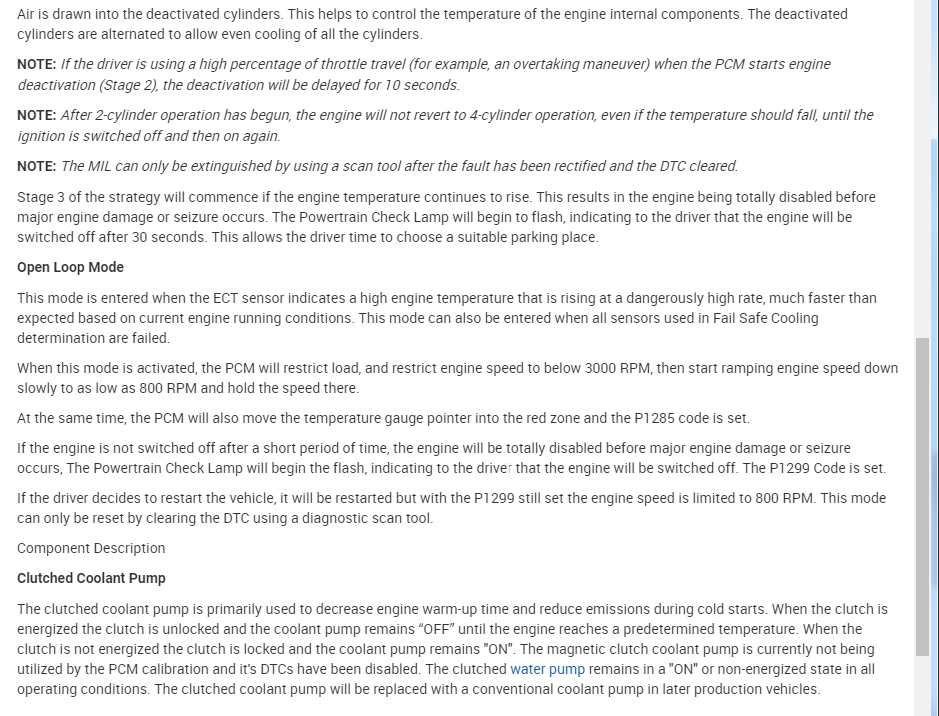

Can you check and see if you have a clutched coolant pump as described in the attachments? Reason is, it says the clutched water pump will be switch to a conventional pump in later production.
Along with getting a coolant pump, I would get this test kit and just make sure there are no hydro carbons in the coolant. The more I am hearing about this, I doubt that is the issue but it is cheap and easy to test.
Jan 9, 2020 at 10:18 AM
CHEVMAN421
Well did a pressure test on cooling system and it drops a pound about every 5 mins. Then turned and let it create its own pressure by running and it went up to 25psi. Which my system is only for 21psi.. So guessing blown head gasket. Will get the tester kit just to make sure.
