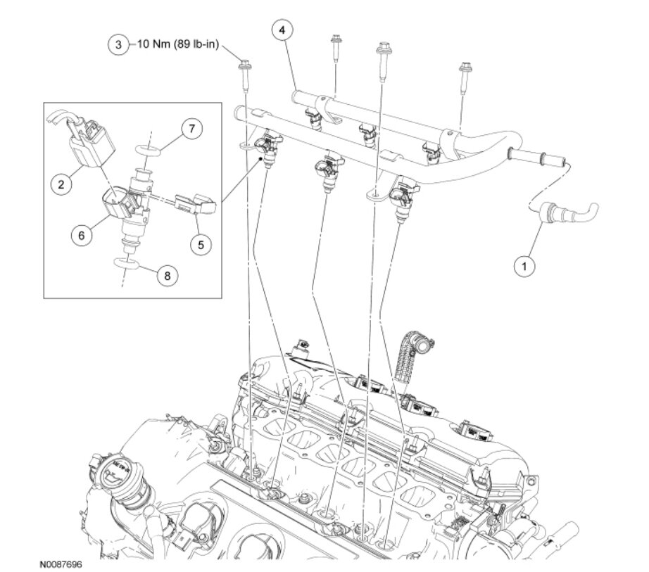

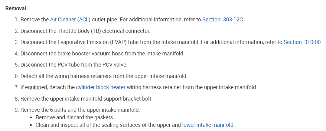

Car is shaking and engine light is on. I ran diagnostics and it gave errors p0701, p0202 and p0302. Saying O2 sensor issue and cylinder 2 misfire. So, I replaced all 6 spark plugs, ignition coils 1, 2 and 3, and the O2 sensor and still shaking with engine light on. The poured fuel injection fluid into gas tank and it ran perfectly last night, engine light was still on but there was no shaking. Then this morning shaking started up again.

The first code, p0701, will not have anything to do with the engine problem so please start a new thread for that.
P0202 - Cylinder 2 Injector Circuit/Open: This code indicates a problem with the fuel injector circuit in cylinder 2.
P0302 - Cylinder 2 Misfire Detected: This code indicates a misfire in cylinder 2. Misfires

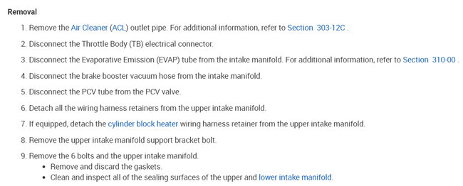

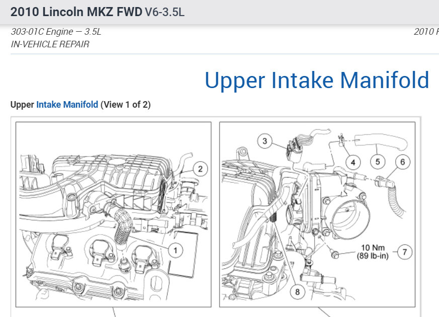

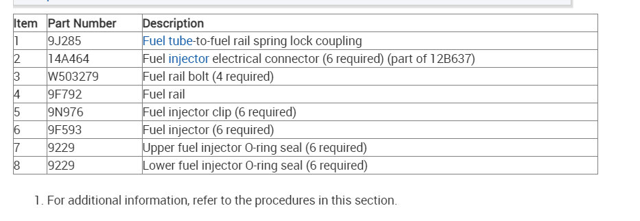

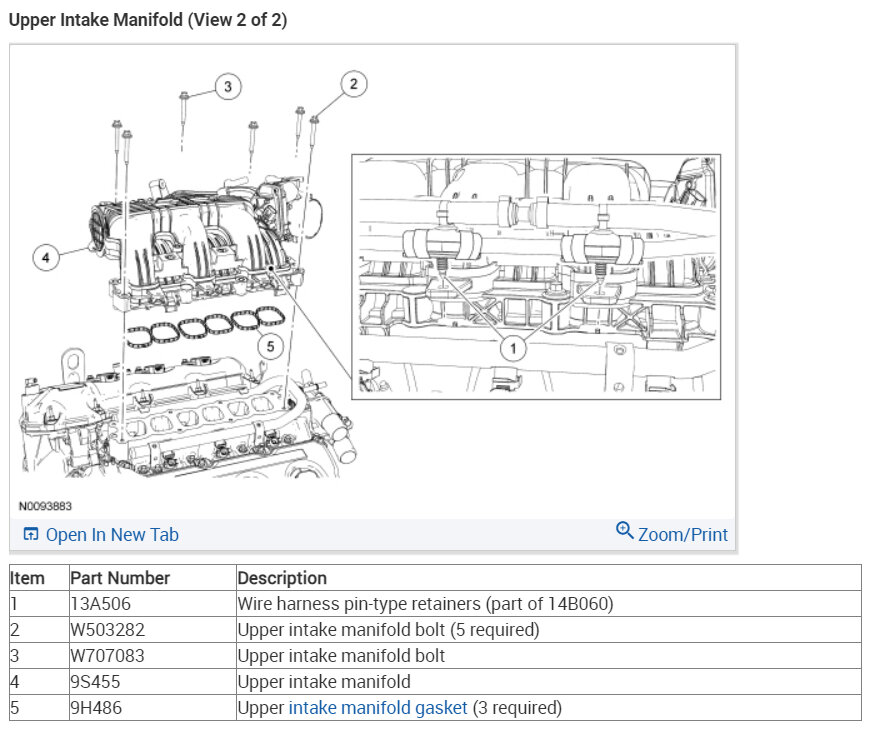

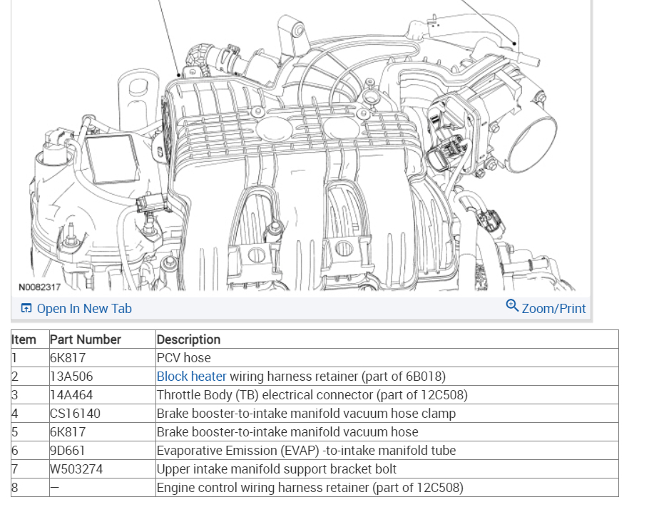

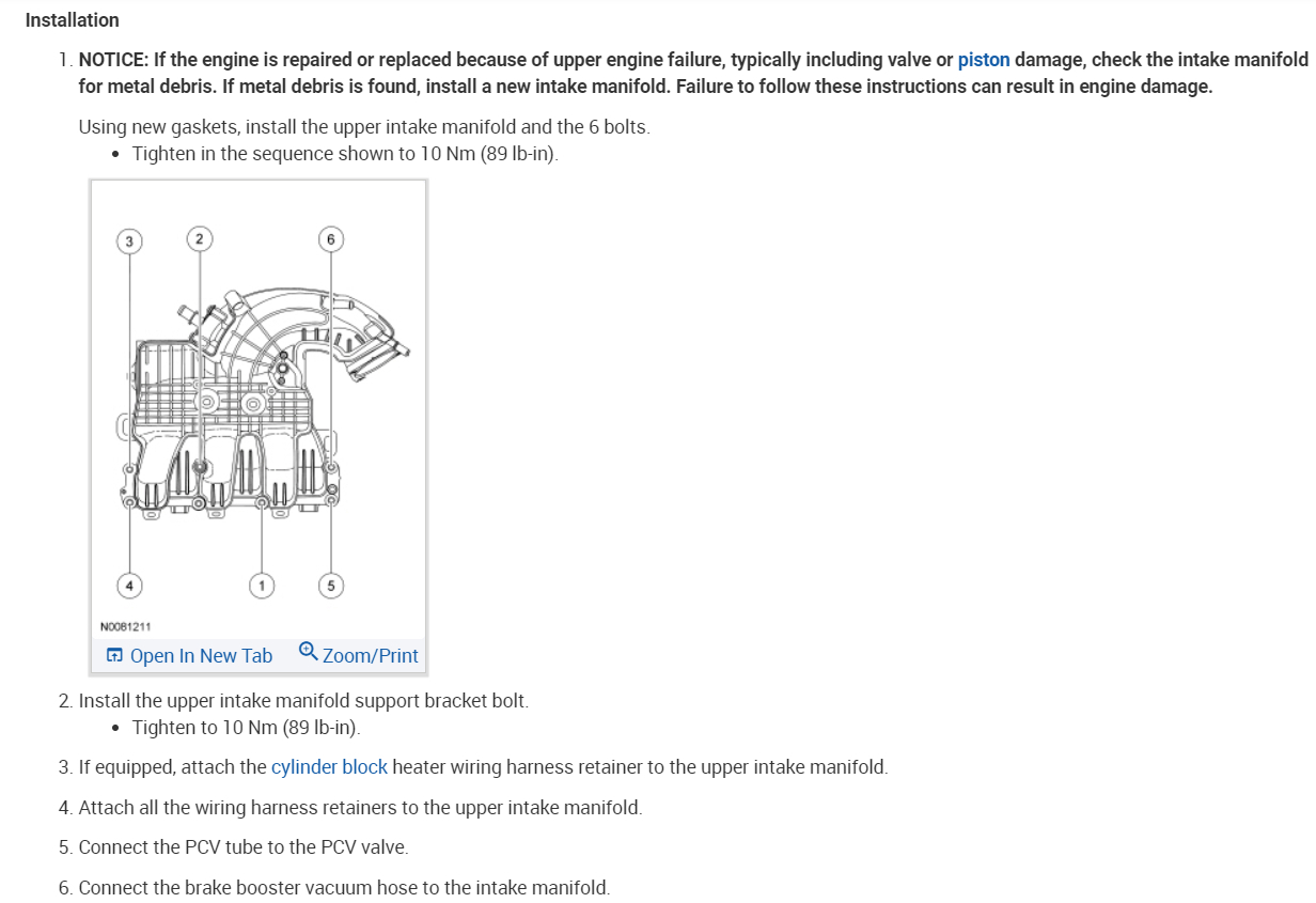

So, this is telling us the fuel injector on cylinder # 2 needs to be replaced but I would check the electrical connector to make sure it is not damaged or corroded. Here is how to change the injector out. You will need to remove the upper intake which I have included. The number 2 cylinder is the middle cylinder closest to the front of the car. Check out the images (below). Please let us know if you need anything else to get the problem fixed.
Sep 13, 2023 at 6:29 AM
MC268726
Would having the injectors cleaned fix the issue or does it have to be replaced?
Sep 13, 2023 at 6:54 AM
  • 55,421 POSTS
9 times out of 10 the fuel injector will need to be replaced.
