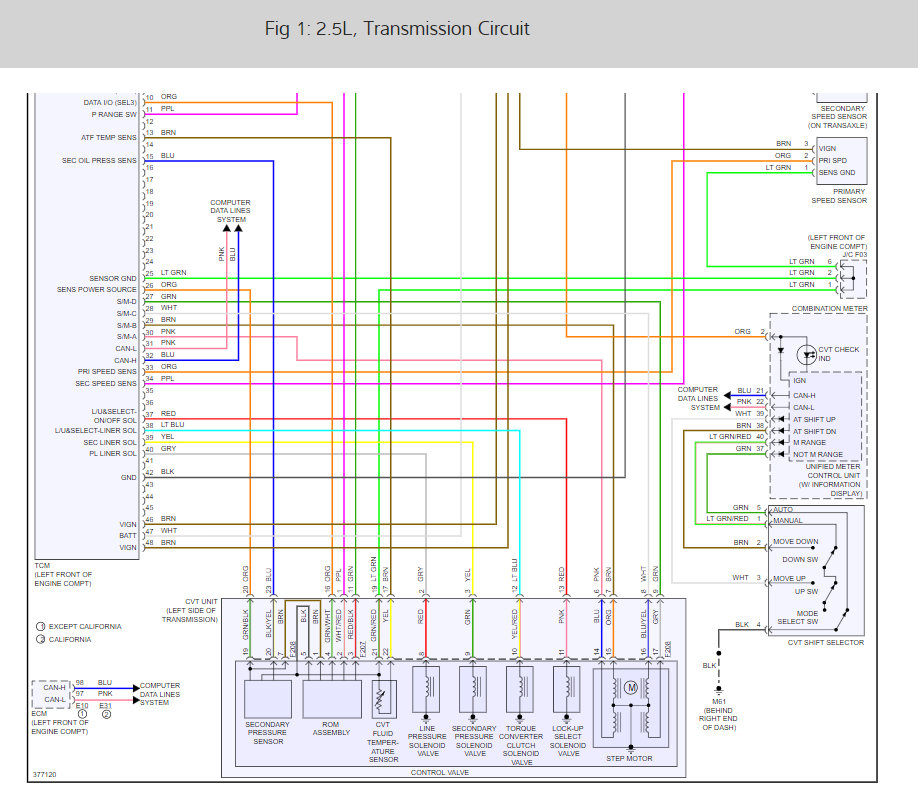

I rebuilt CVT transmission and installed it to the car. When I started the engine, car was not moving at all. I thought it was because of torque converter and oil pump alignment so took it out and installed carefully but after that i am still having same problem. The car is not moving at all. I checked and replaced everything inside transmission except oil pump, valve body and torque converter. Oil pump is rebuild one so I did not check it and valve body and torque converter is installed as it is.
Can you please help why my car is not moving at all?

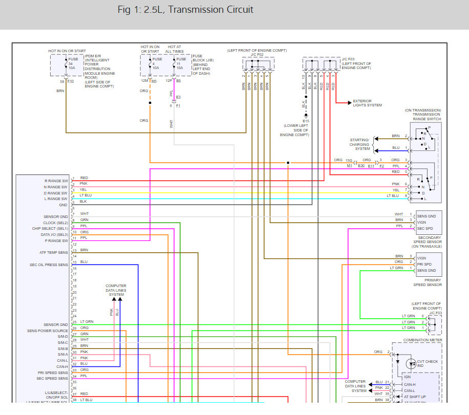

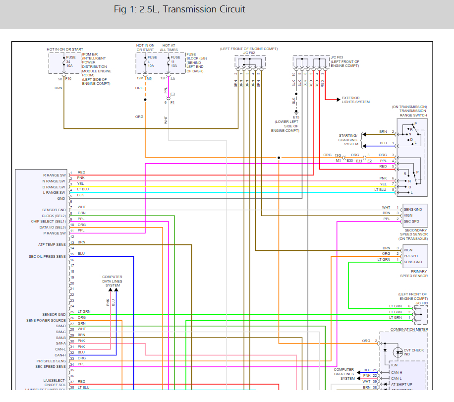

Lets check the power and grounds for the transmission. here is a guide to help and the transmission wiring diagrams below. Also check fuses 34, 11 and 4.
