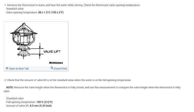

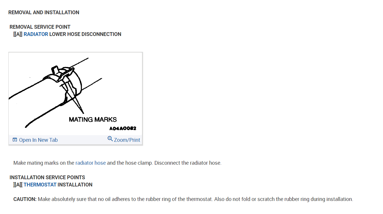

Hello there and happy new year. A week ago, I noticed that my car is cooling down when driving on down slides. It goes back to normal temperature when on level terrain or uphill. I suspect it's just a thermostat, but I wanted to ask you guys first. Also, any tips on replacing the thermostat would be appreciated. Thank you in advance.
Jan 11, 2023 at 9:57 PM
  • 55,402 POSTS

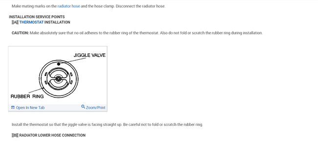

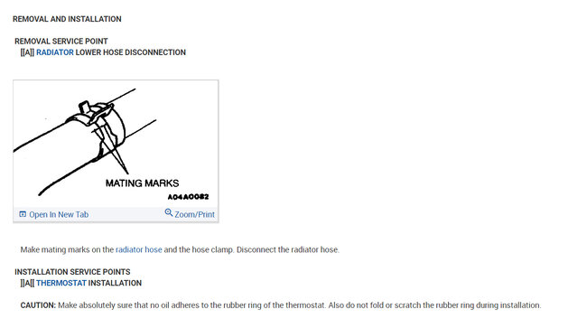

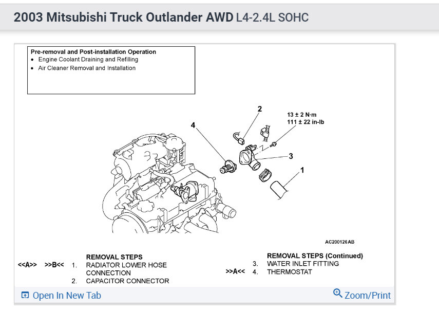

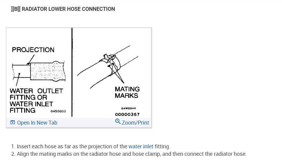

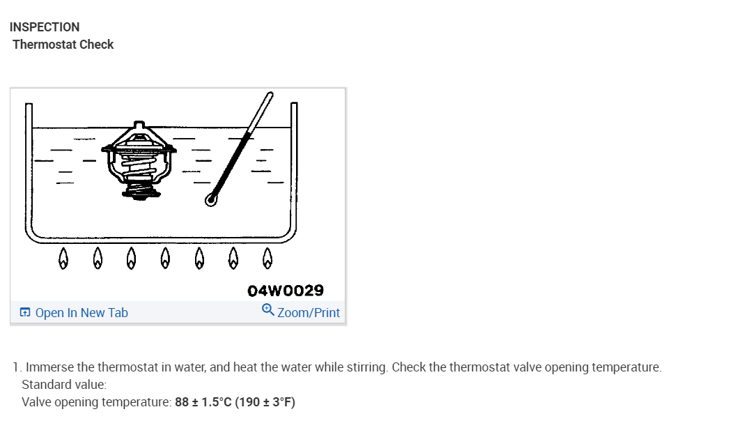

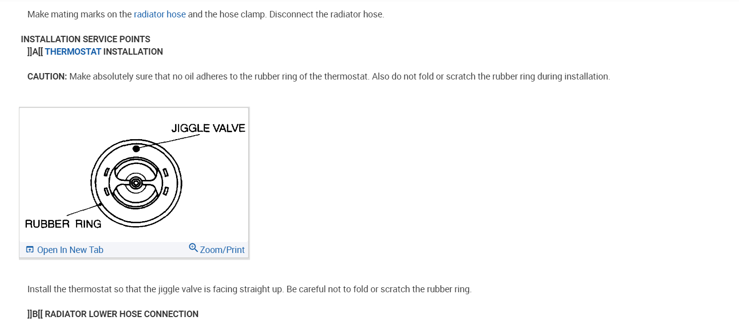

Hello and happy new year! Yes, the thermostat would cause this to happen. Here is a guide to help walk you through the steps and instructions in the images below to help you with your car:
Check out the images (below). Please let us know if you need anything else to get the problem fixed.

Thank you. I was wondering if I need to get some kind of gasket for the thermostat, the new part does say that it comes with a seal, does that work like a gasket for it?
Jan 13, 2023 at 12:32 AM
  • 55,402 POSTS
Yes is does, it might be rubber which needs no sealant just make sure the sealing surfaces are clean.

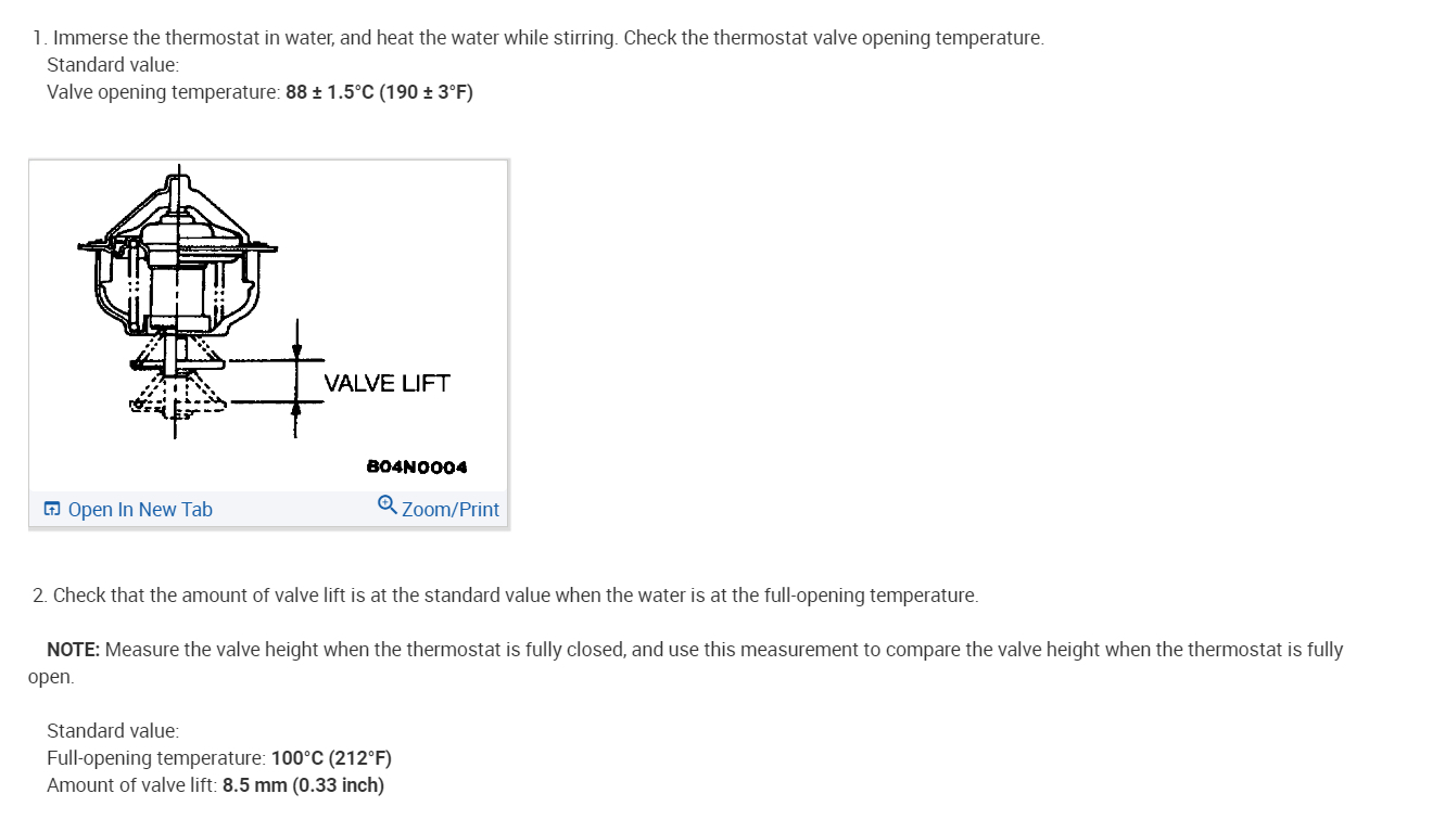

Also, all the new thermostat says it opens at 82 degrees and I was wondering if that's alright?
Jan 14, 2023 at 9:37 PM
  • 55,402 POSTS
That is good to hear, we do have a gofundme page https://gofund.me/c7d318ad
The thermostat should say 182 correct? if so that is okay.
