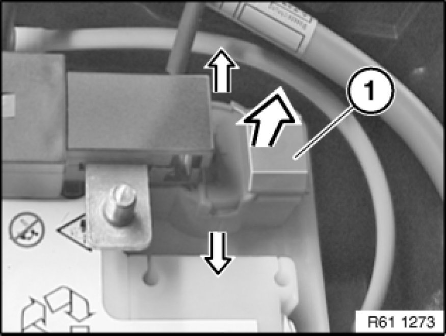

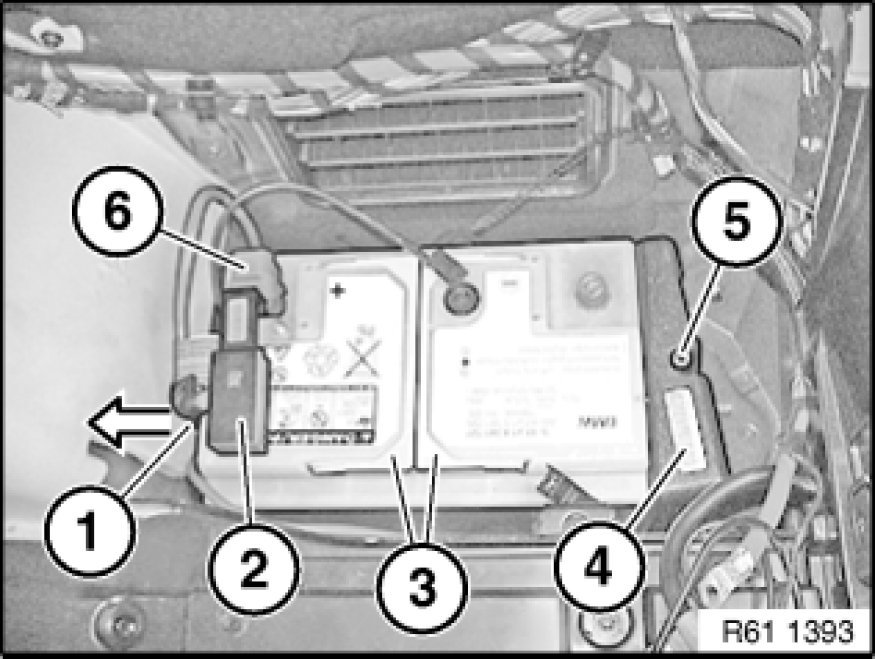

Here is what I found on Alldata related to replacing the battery. The 5 attached pictures correlate with the removing and installing portion of these directions.
________________________________________
61 21 010 - Removing and installing or replacing battery
Warning!
Observe safety instructions See: Battery > Technician Safety Information > 61 00 ... Safety Instructions for Handling Vehicle Battery for handling vehicle battery.
Notes and instructions on Intelligent Battery Sensor IBS.
Necessary preliminary tasks:
- Remove flap See: Trunk / Liftgate Interior Trim Panel > Removal and Replacement > Removing and Installing/Replacing Flap in Luggage Compartment Trim on Right in luggage compartment panel on right
- Disconnect battery negative lead See: Battery > Removal and Replacement > 61 20 900 Disconnecting and Connecting Battery Negative Lead
- Remove distribution box See: Fuse Block > Removal and Replacement > 61 14 010 Removing and Installing/Replacing Distribution Box (on Battery)
Unlock positive terminal cover (1) and remove.
Important!
Do not under any circumstances pull/lever safety battery terminal off by force.
Battery crash element must be reinstalled!
- On vehicles from build date 12/2006 or when IBS is replaced since 12/2006, battery crash element has been removed without replacement (IBS2006 replaces IBS2004 from 12/2006 IBS2004)
Detach vent (1) in direction of arrow.
Release nut (6) of safety battery terminal (2).
Tightening torque 61 21 1AZ See: Battery > Mechanical > 61 21 Battery With Terminal.
Detach safety battery terminal (2) towards top, lay to one side and secure.
Release threaded pin (5) and remove holder with battery crash element (4).
Fold back both bar fasteners (3) and pull battery towards rear out of associated fixture.
Lift out battery.

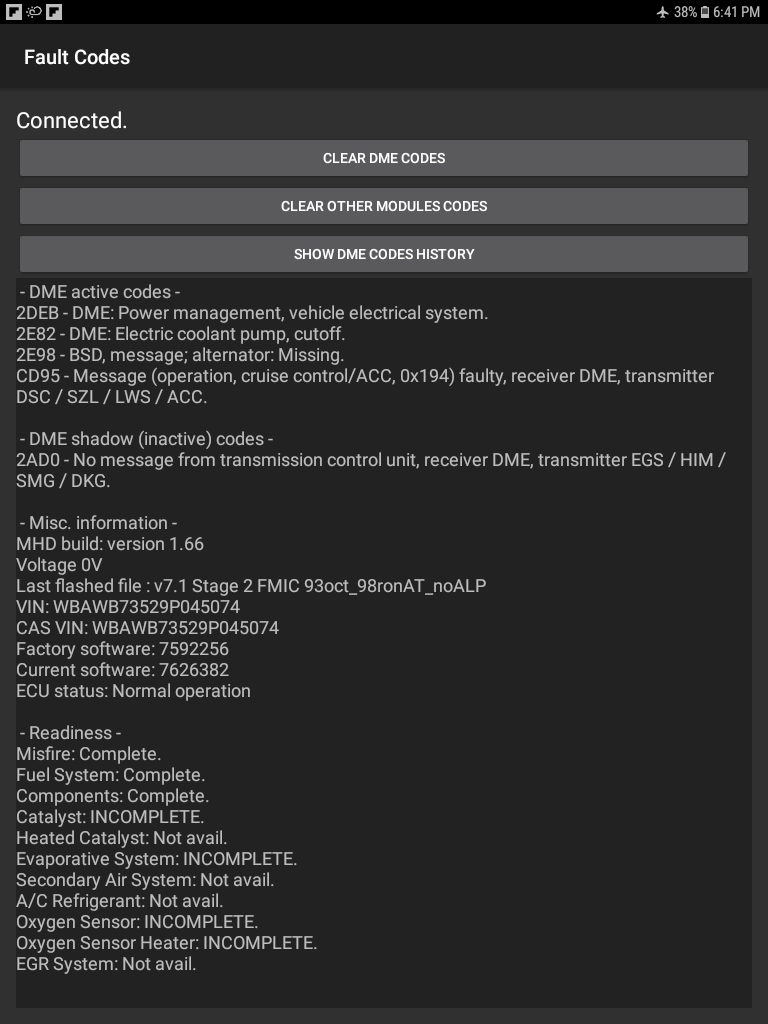

So I bought the Carly for BMW to register it, and I walk outside and my brand new battery is dead. These are the codes from yesterday right after I hooked up the new battery.

How fast did the old battery go from working to dead? The 2E98 code usually means the alternator is failing internally and is not communicating. However, until you get the battery reset all codes should be taken with a grain of salt as they can be set by the battery draining and the engine not running. Basically I would put a charger on it, get the battery information into it and then test the charging system once you get it started.
