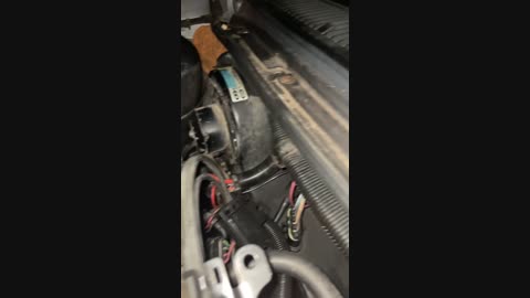

I replaced the fuel pressure regulator. It definitely did make a difference that being said; I no longer believe it to be a fuel issue given this new piece of information I have received. I unplugged the alternator’s connector and boom car starts every single time and idles, but it’s like it’s in a limp mode of some sort. You push the gas completely down it dies. But if you slowly add gas, it stays on and runs, but now it’s starting every time and doesn’t stall unless I go pedal to the metal. What could that be? Ecu, crankshaft sensor, or maybe even some other control module? I’ve replaced everything ignition wise, spark plugs, crankshaft sensor, ignition control module, the coils, pretty much everything and it drove for 7 months before I had another issue and now it doesn’t start and stay on unless I unplug the alternator. If the alternator is plugged in it starts and 3 seconds later it shuts off sometimes making a popping noise from my air cleaner. Very unique issue now though.

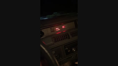

I’ve replaced the alternator on this car twice and hasn’t fixed any of my issues with starting it. I unplugged the alternator and tried starting the car and it ran (very poorly) it idled smooth but shut off when you push down on the gas all the way. It would stay on without stalling otherwise. Why won’t the car start with the alternator plugged in? I’ll attach two videos one with alternator plugged in (top) and one without (bottom).

Try this and let us know what happens: Put a battery charger on the battery and let it charge fully, then start the engine and plug in the connector. From the description you say it will start and idle but poorly. The 2.8 was never a powerhouse and I think the issue might be that the battery is low enough that as soon as the alternator kick on and tries to charge the battery at a high output it is enough of a load that the engine stalls. Another version of the test would be to remove the drive belt from the alternator and see if it starts then with the alternator plugged in. If it does in either test then it's probably the load on the engine and getting the engine sorted out would probably repair it.
