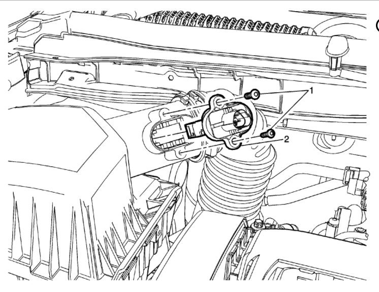

try to take off it physically cannot. It is like it is having a hard time. When I put in park it revs up to four rpm then holds for like two seconds and goes back to normal. Sometimes when I am start to drive it sputters. Like, when I take off.

Something like that should have triggered the check engine light on already. Can you have the codes pulled and posted on here to see if we can get an idea as to what is going on?

Ok codes are P0101, P0171
Jul 20, 2017 at 1:28 AM
  • 55,432 POSTS
Nice work,
Those are MAF codes which will cause the problem are are describing. Here is a guide and a diagram on how the get the job done.
https://www.2carpros.com/articles/how-to-replace-a-mass-air-flow-sensor-maf
Here is some diagrams on your car (below)

Thanks i have appt to take car in to dealership but when i called them thy are stating oh that may need intake gaskets etc ..

Yes the first thing they will check is that you have no vacuum leaks. If all is good then you will need the mass air flow sensor. That part is not cheap so hopefully it is just a vacuum leak.
