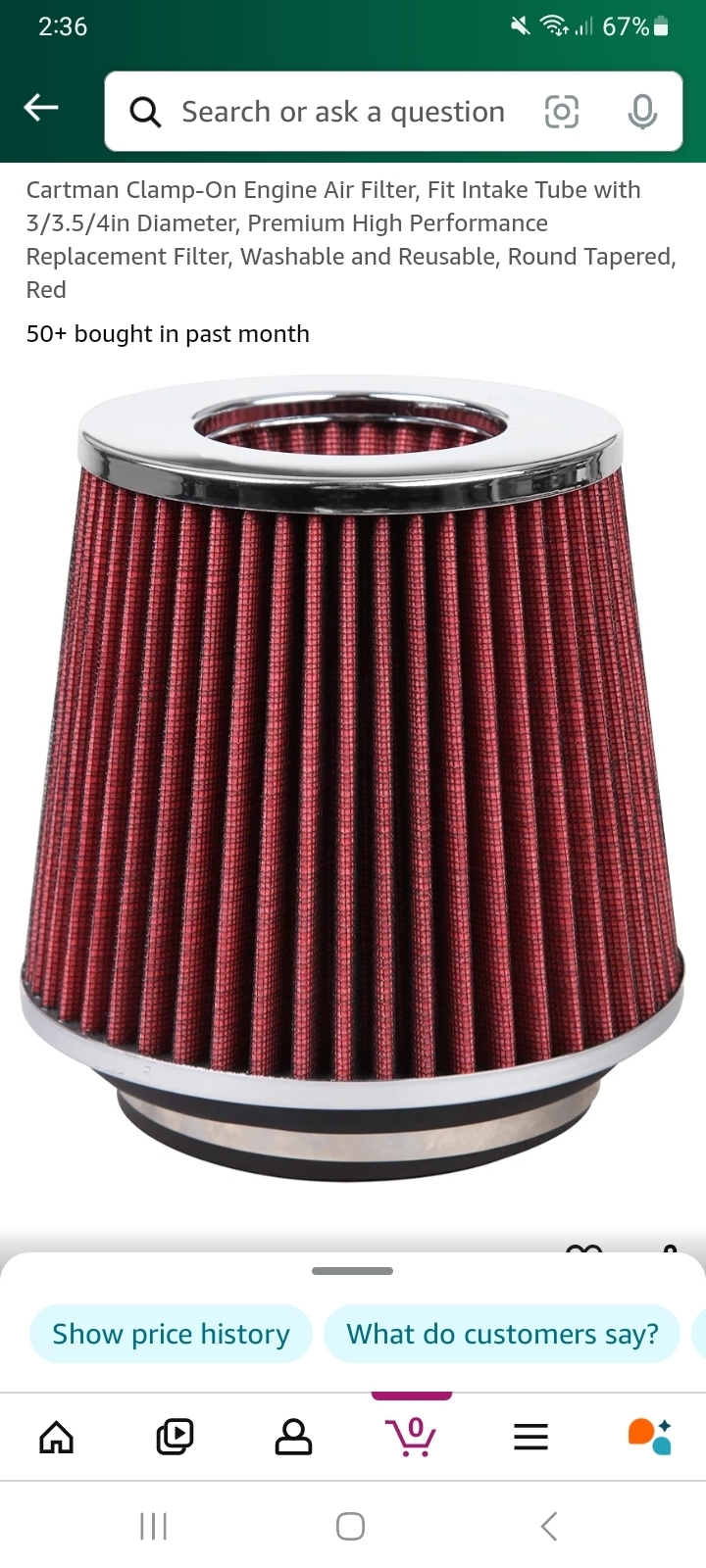

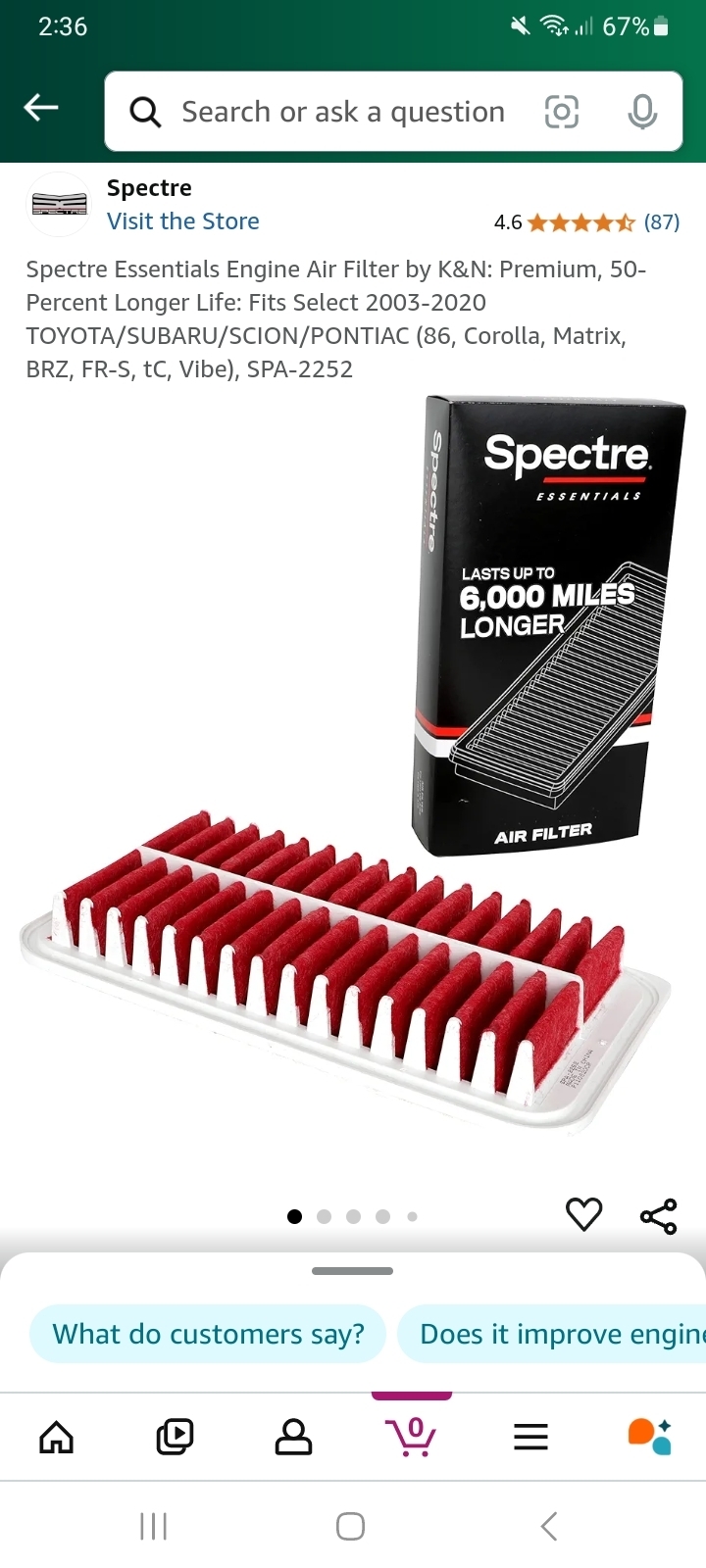

These are the filters. They were only like $20 each.

Just put a good filter in the factory box. If you actually test the filters like K&N or Spectre oiled gauze filters you will find that yes, they do flow air faster than a standard filter, but they do this by having larger holes through the material. The oil is supposed to capture the dirt and dust, but it doesn't work that way in actual use because there are still larger holes in the filter where there is no oil. The factory airbox actually does a much better job at filtration and keeping water out as well as removing engine drone and helping the engines control systems operate properly.

I was doing this for horsepower increase.

Won't do anything at all to increase HP. In fact it can decrease it because it can introduce turbulence in the airstream that causes an odd flow over the MAF.
