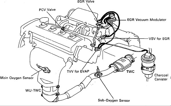

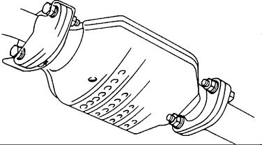

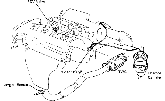

Hi and thanks for using 2CarPros.com. The symptoms you described can be the result of a few things. The first is a partially clogged catalytic converter.
Here are the general symptoms of a converter issue:
Here is how to test one:
If you determine that the converter is bad, here are directions specific to your vehicle for replacement:
Jack up vehicle.
Ensure the catalytic converter is cool.
Remove the four bolts and nuts holding the pipes to the converter.
Remove the converter and two gaskets.
Place new two gaskets on the front and rear pipes.
Install the converter with the bolts and nuts. Torque Value: 32 ft.lb (43 Nm)
I attached three pictures of the converter and its location. Note: The first one is for federal emissions and the second one is for California. I am not sure where you live.
The third picture is that of the converter in your vehicle.
Give this a check and let me know what you find.

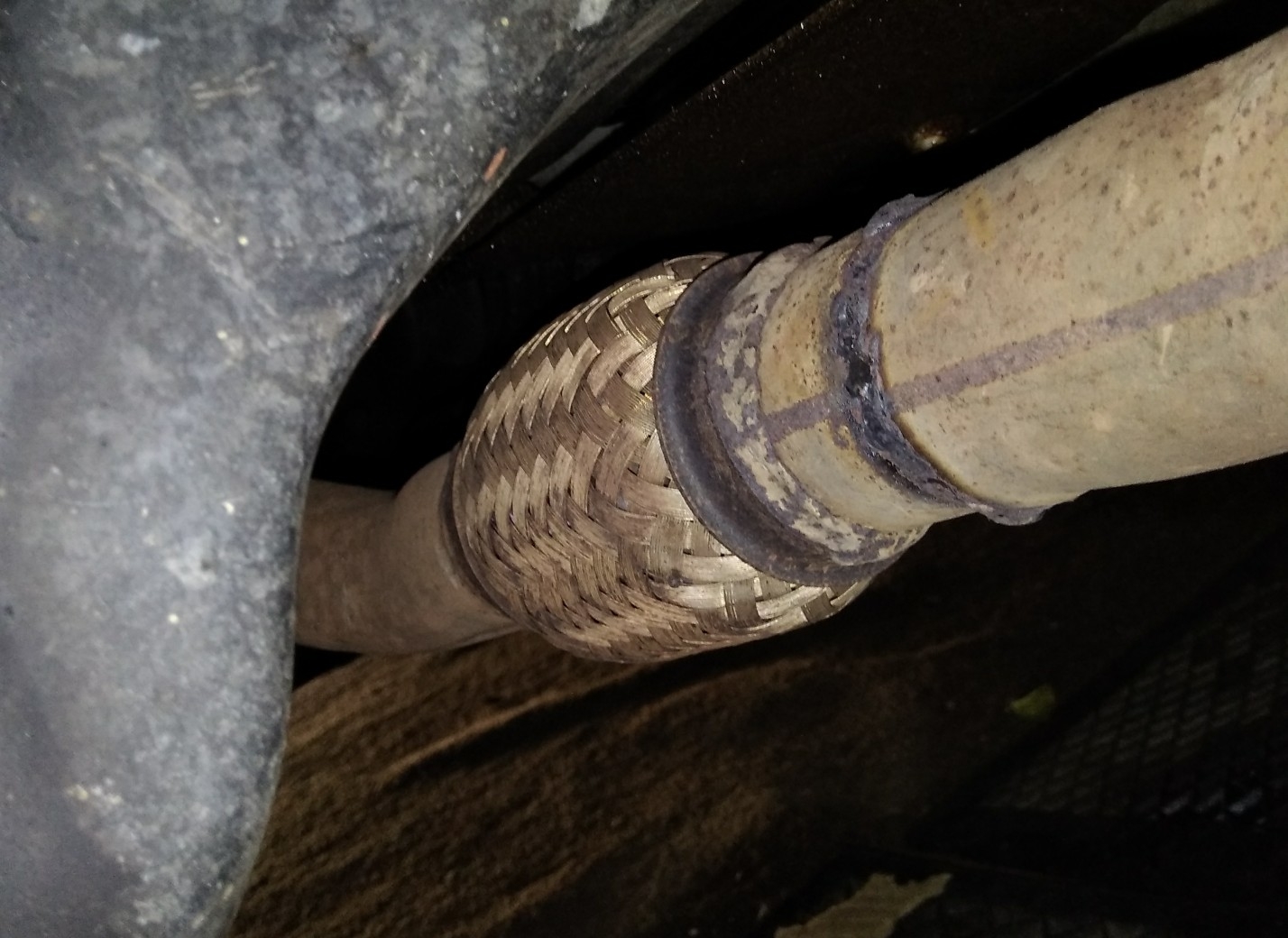

My car does not have the converter or sensor switch, only 2xsilencer boxes.

Welcome back. The picture you attached is the flex pipe. The vehicle was manufactured with a catalytic converter. If you purchased the vehicle new, I am confused. However, if you purchased it used, it appears someone removed it. Ugh, that leads to new issues. For example, there should be an oxygen sensor which is most likely missing.
Did this problem start all at once? Honestly, without the sensor and converter, the computer most likely does not know what to make the fuel mixture.

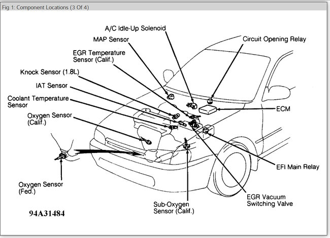

No, the shaft is a straight shot. It sounds like to me the engine coolant temperature sensor is not working right when the engine gets hot.
Here is a guide to help you see what you are in for when doing the job:
https://www.2carpros.com/articles/coolant-temperature-sensor-cts-replacement
Here is the location for your car. Check out the diagrams (below). Please let us know what happens.

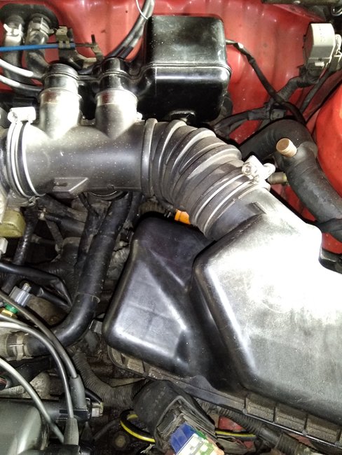

I have manually diagnostic code. Gave me a code 24.
May 25, 2018 at 5:36 AM
  • 55,562 POSTS
I do not see code 24? https://www.2carpros.com/articles/toyota-trouble-code-definitions-and-code-gathering-method-1990-1995
Can you recheck it?
May 26, 2018 at 3:27 AM
HILTON
  • 23 POSTS
Intake air temperature signal, I do not know what you mean if you do not see it.
May 26, 2018 at 4:31 AM
  • 55,562 POSTS
My bad, that code will cause the car from performing normally. I would replace it.
