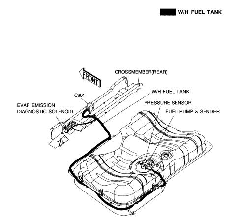

For the gas, I have about 3/4 of a tank filled. I would like to drain all of it out and put fresh gas in it. So far I have tried sticking a clear vinyl tube down the fuel neck but it didn't go all the way through, so I think this car has one of those anti-siphon security features, either that or I'm doing it wrong. What are the other ways of draining a fuel tank?
Other methods of draining the fuel tank I have found online are to either put a tube on the valve of a fuel rail and turn the car to the On position in the ignition to activate the fuel pump and continue to do so until all the gasoline has been siphoned out, or an alternative method would be to access the gas from where the fuel pump is located. Are these methods right for my car? My fuel filter is located under the hood of my car. Is the fuel rail near that area?

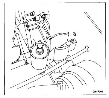

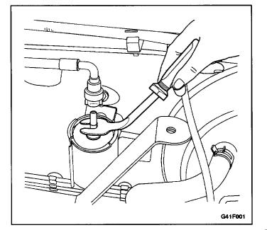

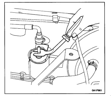

I'm also thinking about changing the fuel filter. The directions say that I have to release the fuel pressure first but I'm scared of starting my engine with the bad gasoline after I pull the fuel pressure fuse from inside the fuel box. Is this something I should be worried about?

From what I have read online, there seems to be three options, drain the tank, top the tank off with high octane gas or to simply drive it and burn it off like you suggested.
If draining the fuel tank is a possible DIY task, I would like to try to do it. It would really put me at ease knowing that the engine is using fresh gasoline rather than running into the possibility of clogging the engine with 3/4 worth of old gasoline. But then again I'm not a mechanic and am only beginning to understand how my car works and how to take care of it. When I was reading the instructions in the service manual on how to remove the fuel tank, step 3 says to drain the fuel tank. This was preceded by disconnecting the neg battery terminal and relieving the fuel pressure. Because of this I feel like there has to be some proper and not too difficult method of draining the fuel tank. I'm just not sure how to do it. I also saw a Youtube video of someone siphoning their car from under the hood. Would I be able to this in order to drain my car?

I attached some pictures that I found in the manual. After all of this is done, my car should be okay right? Thanks again for all your help.

You'll never get all of the old gas out, but to do that you'll need to use the pump to pump it out. If you want to drain it from the test port on the engine, as you described earlier, you can't just throw a hose on it. There's a valve in the center that has to be pressed, just like on a tire valve. How are you going to press it if there's a hose over it? You could unscrew that valve core, but I've never done that so I don't know if it's just like a tire valve and if the same tool will work. I don't know of any mechanic who ever tried to do that.
The next best thing is to remove a hose from the fuel filter. The filter is along one of the frame rails on the side of the car. Quick-connect fittings are used. You push the hose further onto the filter, squeeze the two plastic locking tabs, then pull the hose off. If you had the ignition switch turned on within the last few weeks, there will be pressure in there and some fuel will spray out. We wear safety glasses just out of principle, but if you don't, just hold a rag over the hose. The fuel will be done spraying within a few seconds.
Now you need to power the fuel pump so it will pump the fuel into your cans. The easiest way to do that is to remove the fuel pump relay and insert a jumper wire, like a stretched-out paper clip, between two terminals. Look on the relay to see if they labeled the terminals. You will typically find numbers 85, 86, 87, and 30. You need to connect 30 and 87. Be aware that fuel pump motors are cooled by the gas they sit in so if you run the tank empty, there's a risk of overheating the pump and damaging it. That can show up as a warped housing that causes intermittent no-starts weeks or months later, and is more common in real cold weather.
Pumping the fuel out at the filter won't remove the fuel in the line from that point up to the engine, so any mold growing in it won't be removed. The most effective remedy is to do nothing because your car uses a fuel pressure regulator on the engine, and a return line to the gas tank. As soon as you start the engine, about a gallon of gas per minute is pumped through the filter, the regulator, and gets dumped right back into the tank. That means all the fuel, even the stuff you can't drain out, is going to go through the filter hundreds or thousands of times before a tiny little bit veers off to go through the injectors and into the engine. The more you run the engine, the more the fuel is going to get filtered. Any mold or other debris will get trapped in the filter, then you can replace that at the next scheduled service.
Your fuel filter looks similar to a Chrysler filter. It is very common for Chrysler filters to last the life of the vehicle unless they get so old they rust out and start to leak, like mine did when it was 20 years old. Also, you will never solve a running problem by replacing their filters, except on any diesel truck. Even if some mold did have time to start growing in your gas, it's not going to be nearly enough to plug the filter.
