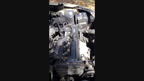

This is what it will do when trying to start. This is after a new fuel filter installed but was also doing same thing before installation.
Sep 19, 2024 at 2:19 AM
  • 110,244 POSTS
It doesn't sound like a compression or timing issue. That leaves spark or fuel. Will it try to start if you use starting fluid?
