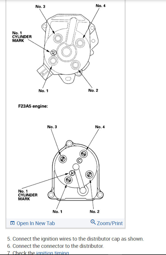

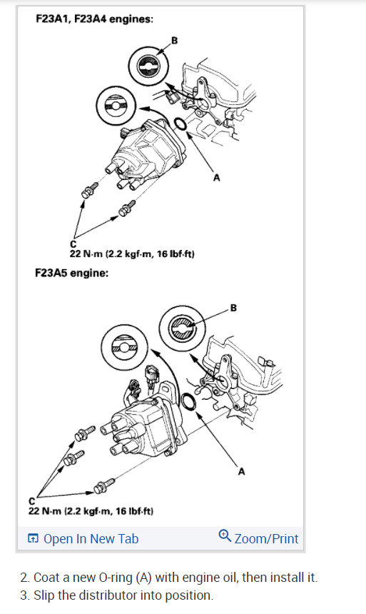

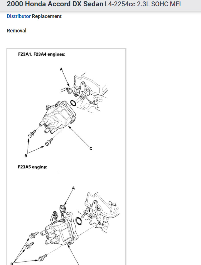

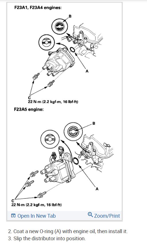

The distributors goes out all the time on these cars. I would get a rebuilt unit from Amazon. here is how to install it in the diagrams below also I have included a guide that can help as well:
