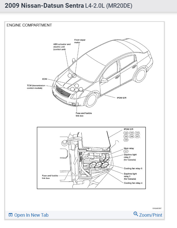

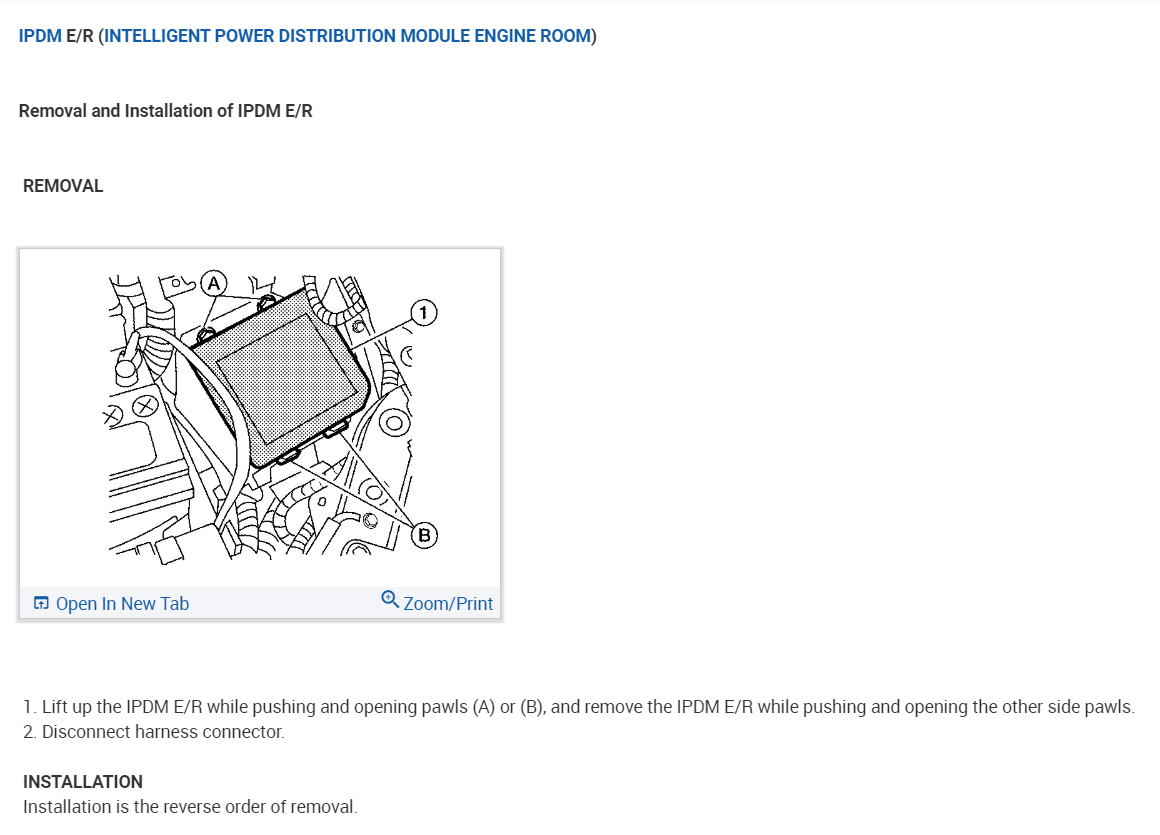

It sounds like the IPDM has gone out, which is common in these cars. To be sure we can do a CAN scan which is easy. Check out this guide and you can get a CAN scanner for about $30.00 from Amazon. This video will show you how to use it, and I have left how to change out the IPDM in the instructions below:
https://youtu.be/u-4syLc-ifQ
Here is a scanner link:
https://amzn.to/3o41KcZ
