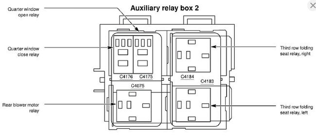

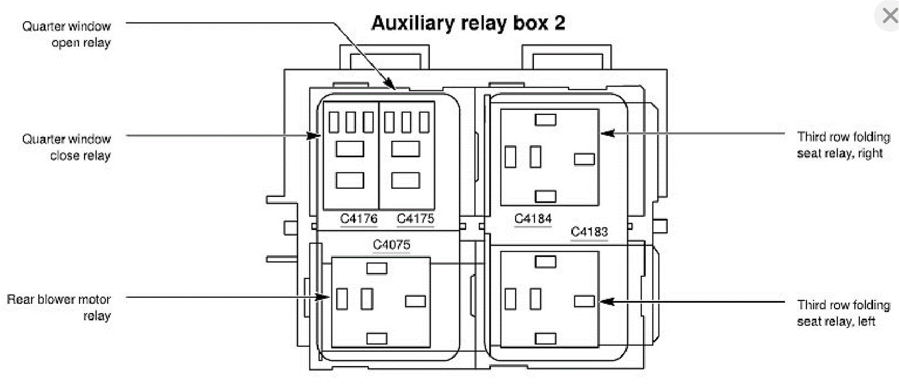

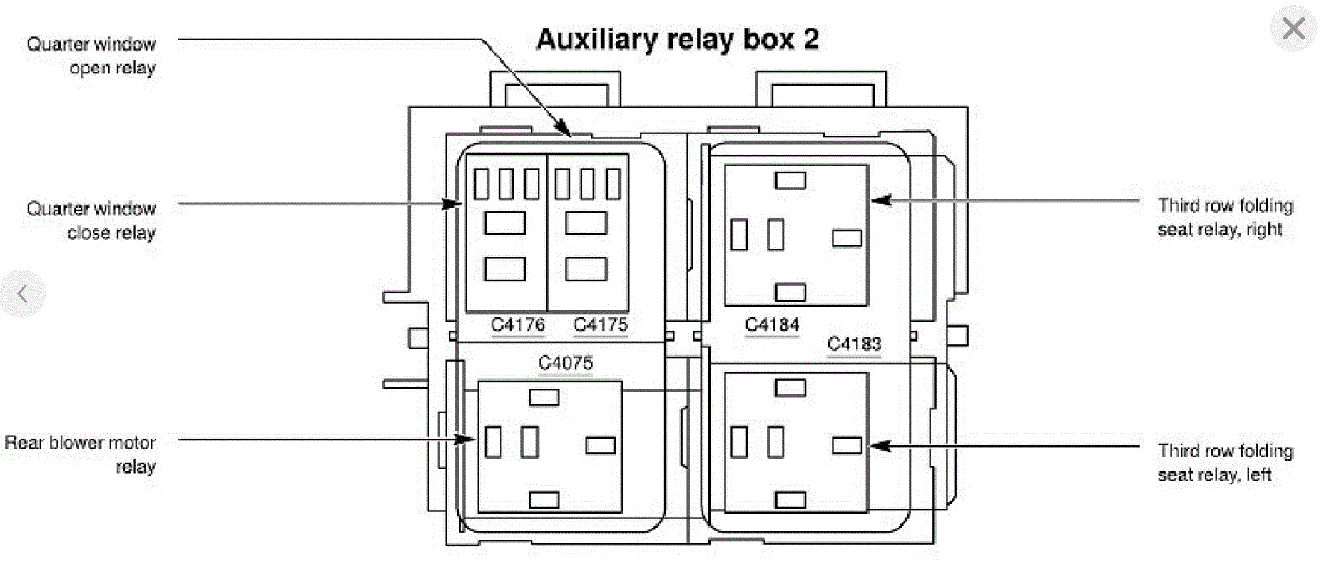

If you had a draw with all the fuses removed at the same time, the short is likely between the battery and the fuse/relay box.
You may want to start pulling one relay at a time to see if you can find one that stops the draw. There are three different relay box locations under the hood However, the relays should be getting power from a fused circuit, so I question if this will help identify an issue.
May 10, 2022 at 12:48 PM
NCOFFIN18
  • 6 POSTS

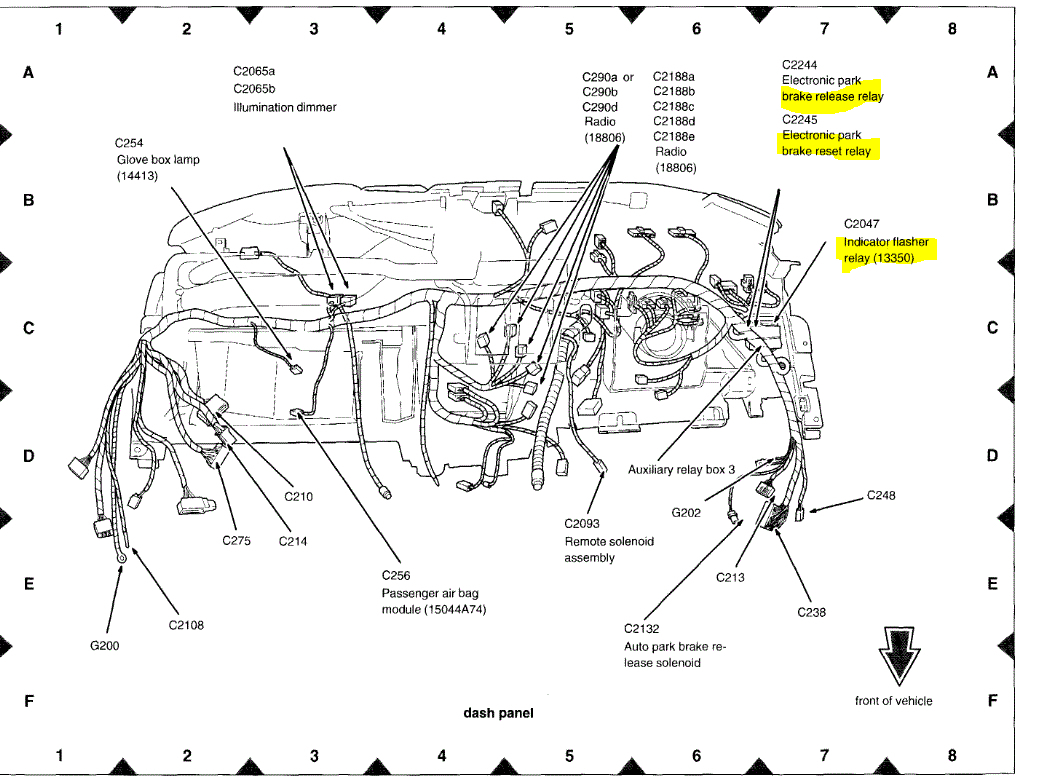

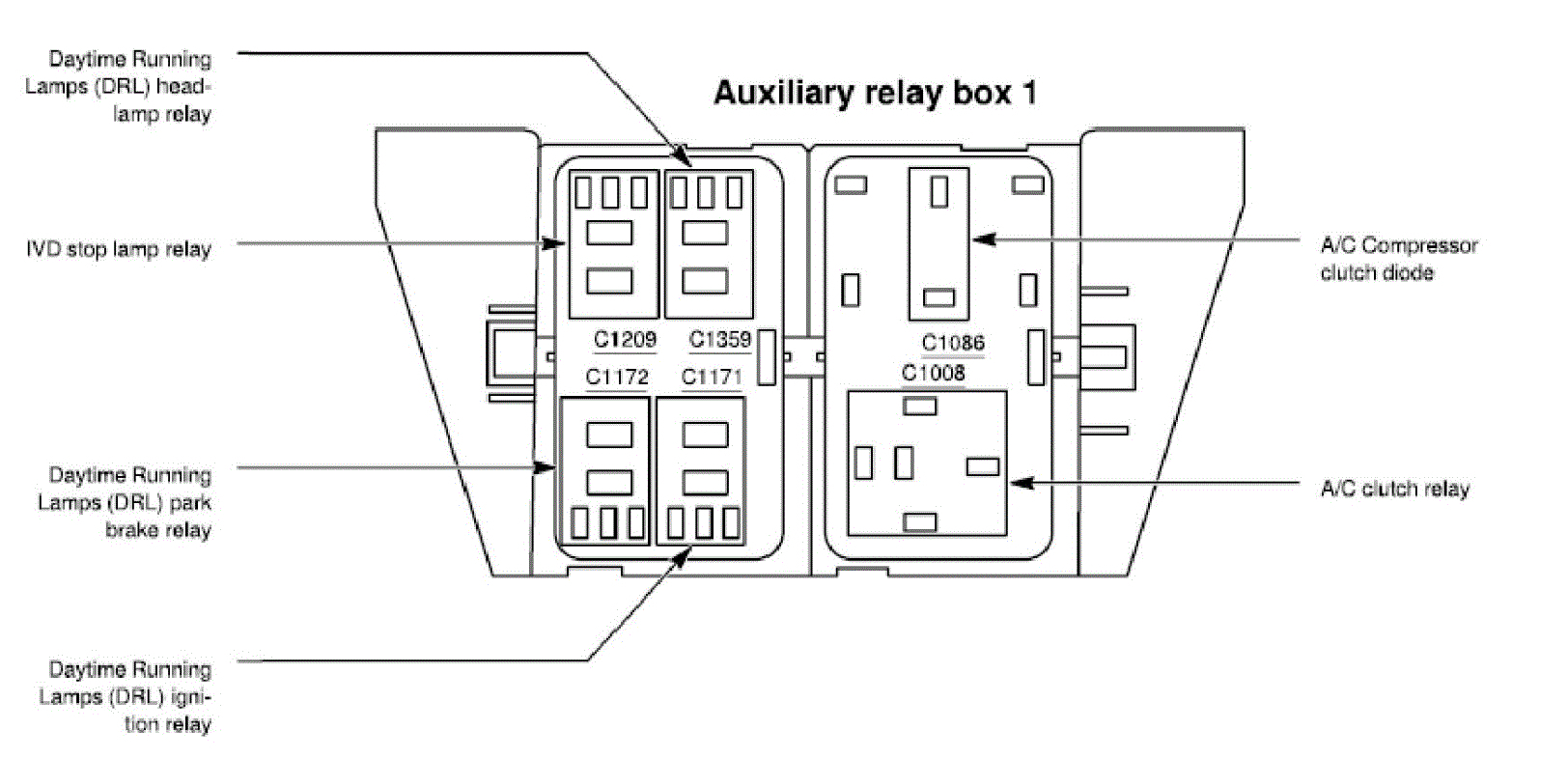

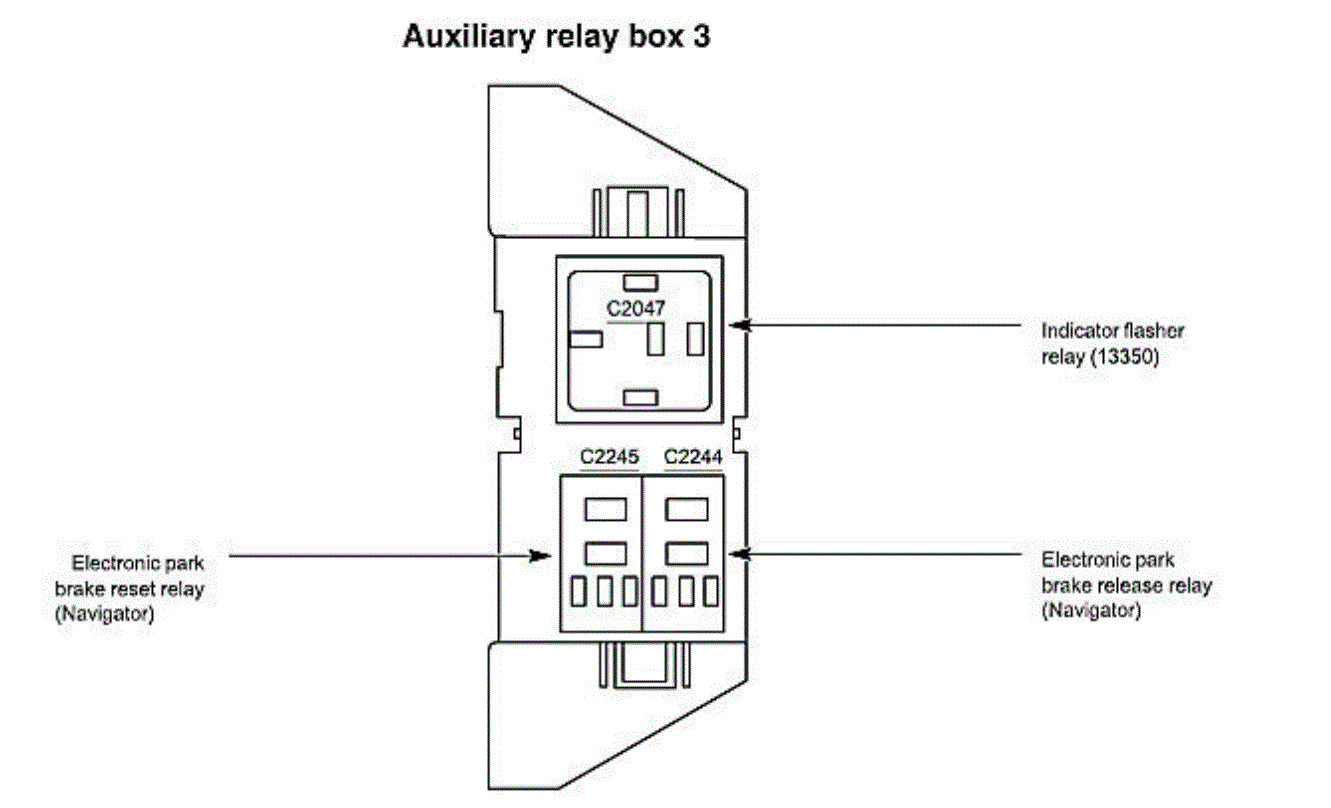

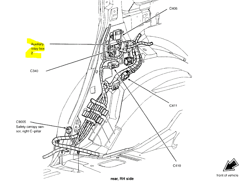

As of currently I have all relays pulled that I know of. Do you maybe know where the under the hood relays might be? I wasn't aware it had any. I won't be able to check it until next week, but I was assuming it may be one of the positive battery cables leading to the alternator or the battery.
May 11, 2022 at 4:20 AM
  • 110,244 POSTS

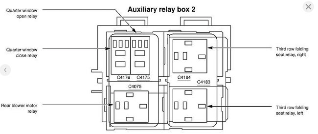

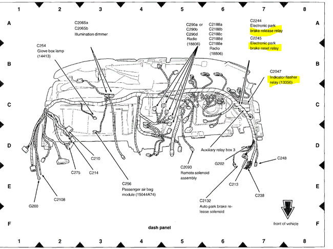

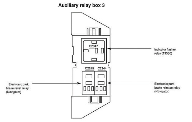

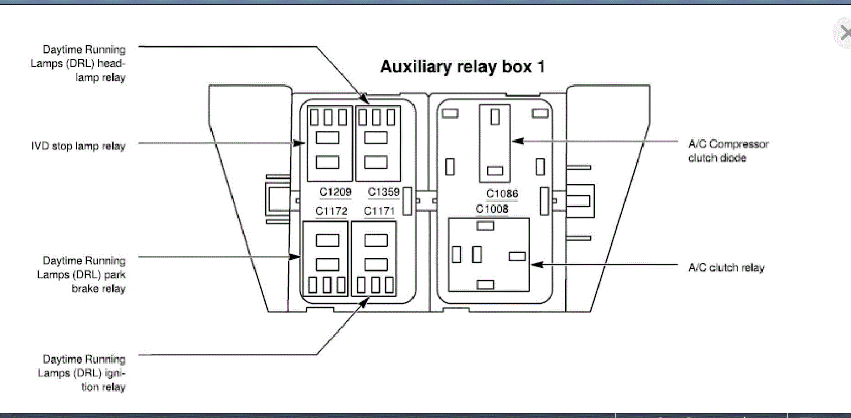

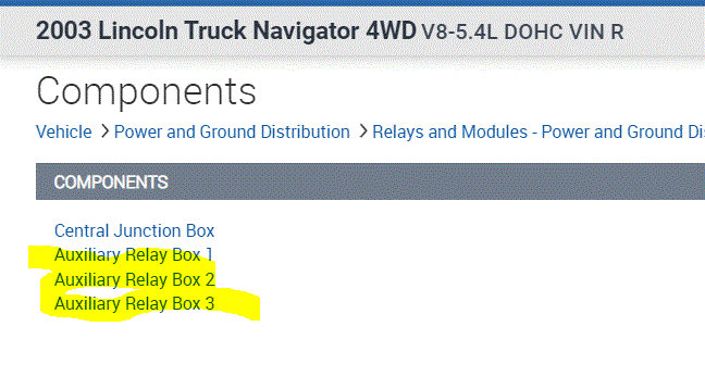

There are three auxiliary relay boxes. Take a look at the pics below and let me know if they help.
Also, here is a link that explains how to test a relay:
Take care and let me know what you find.

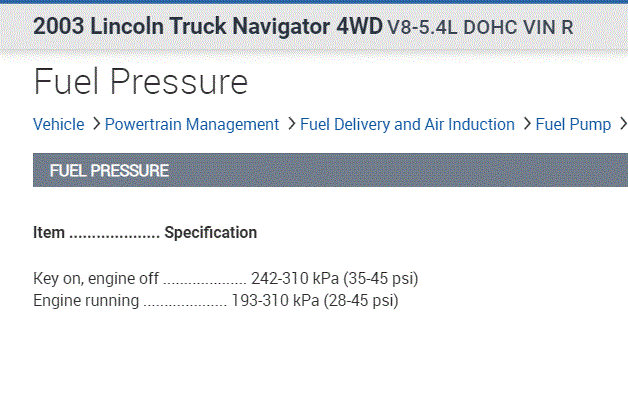

So got that issue fixed. It still doesn't stay on; acts like it's being flooded. Will run fine for a while then shut off and won't want to start for about a minute and it'll start fine. Tested fuel pressure and getting 30-40psi and replaced fuel filter. I guess the next step might be Regulator or damper?
May 17, 2022 at 3:22 AM
  • 110,244 POSTS
The regulator is working. The specs indicate between 35 and 45 PSI. If it was flooding, you would likely see black smoke from the exhaust.

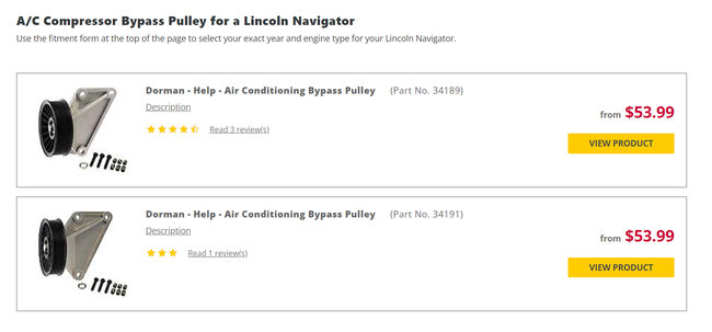

That certainly sounds like the problem. Also, since you smell something burning, that is likely the belt turning against a pulley that won't turn.
You can't just remove the compressor because it changed the belt routing. What I recommend is to get an AC bypass pulley. It is just that. You remove the compressor and bolt it in the compressor's place. Then you can use the OEM belt size and not change the belt routing.
I attached a pic below so you can see what it looks like.
Let me know if I can help.
See pic below.
