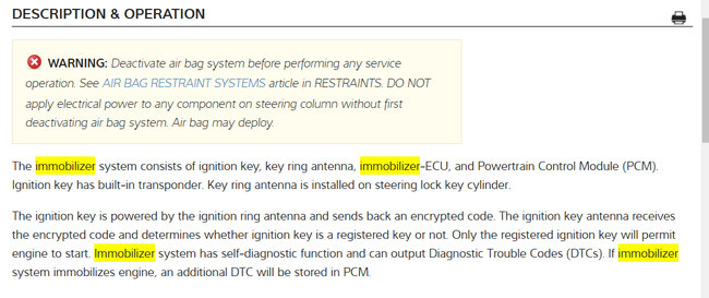

Hello again,
Okay, let's work with what is available and go from another angle, even though without compression this is irrelevant. Is your immobilizer light flashing on the dashboard when you try to start your vehicle? In the diagrams down below I have included a description of your vehicle's immobilizer system. If there is an issue with your vehicle's immobilizer system a Direct Trouble Code (DTC) will be set, so your Malfunction Indicator Lamp (MIL) or "check engine" lamp should be illuminated. Could you please get the DTC(s) for us. Here is a link down below for you to go to if you are unfamiliar with how to do that:
Please get back to us with what you are able to find out.
