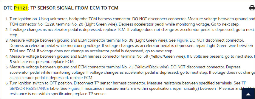

Okay, the IAC has been changed out again with another one and still nothing. Ran the OBDI test again and different codes this time. They are P1121 and P1115.

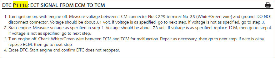

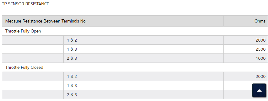

Here is some testing information for the two codes you supplied. Both have to deal with the ECM (engine control module) P1121 deals with communication to the throttle position sensor and P1115 is communication to the transmission control module. Here is a tutorial showing how to test wiring:
Below I've attached step-by-step pictures how to test. You mentioned five codes but you've only provided two. Hope this helps and thanks for using 2CarPros.

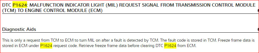

The check engine light says on solid. The codes that it read were.
P1624
P0102
P1115
P1121
P1505
Friday, January 4th, 2019 AT 5:11 PM

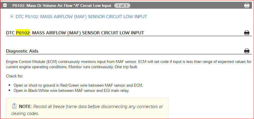

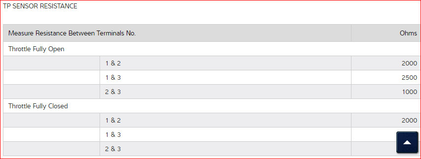

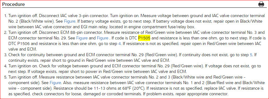

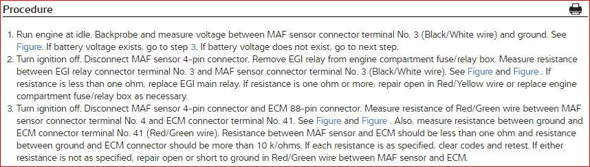

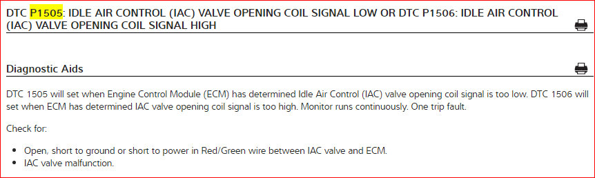

Hello again.
Okay, here are the other three code step-by-step pictures for you. One again is related to the ECM communication to the transmission control module, one is for the throttle position sensor, and the other is for the idle air control valve. Looks like you have a lot of wiring checking to do. Here again is a wire checking tutorial:
Hope all this helps and thanks again for using 2CarPros.
