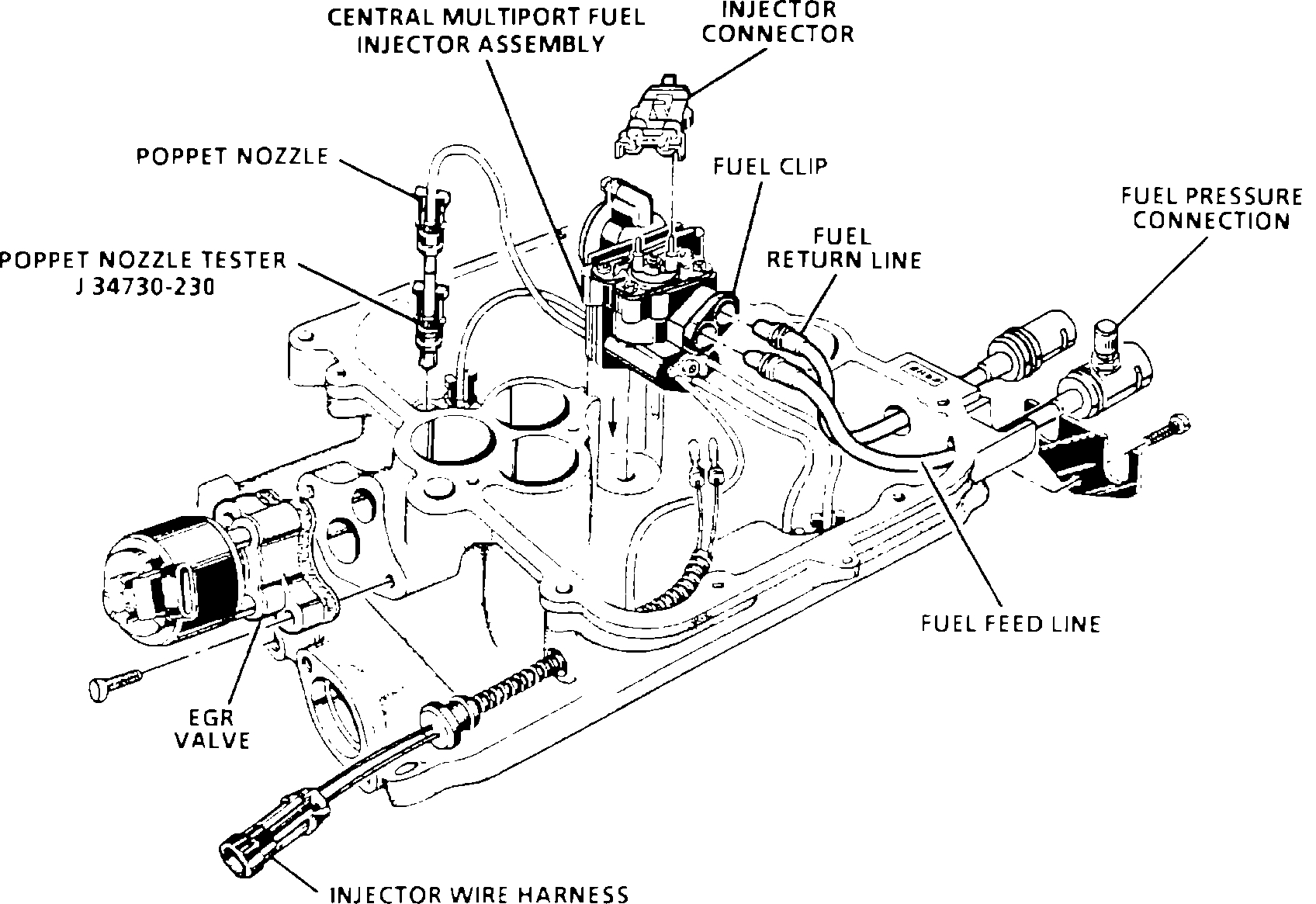

That makes sense. The injectors can make a noise. If it is nearly starting with starting fluid, the engine isn't getting fuel. The next step would be to check fuel pressure.

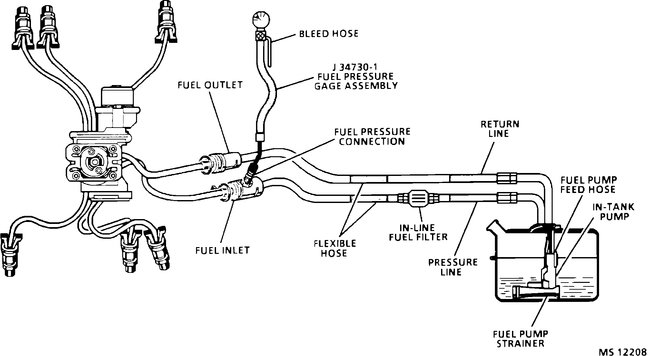

Here is a link that shows in general how to test pressure:
Here are the directions specific to your vehicle. The attached pictures correlate with the directions. The fuel pressure specifications are included in the directions.

FUEL SYSTEM PRESSURE TEST
Central Multiport Fuel Injection (CMFI)
Fuel Supply System CMFI
PROCEDURE
- Turn engine "OFF" and relieve system pressure. Refer to Fuel Pressure Release Procedure.
- Connect the fuel pressure gauge to the pressure connection. Wrap a shop towel around the fitting while connecting the gauge to avoid spillage.
- "START" engine and observe fuel pressure reading. It should be 380-420 kPa (55-61 psi).
- Turn engine "OFF" and relieve fuel pressure.
- Remove fuel pressure gauge.
- Reinstall fuel pressure connection cap.
- "START" engine and check for fuel leaks.
_______________________________
Do this and let me know what you find. If you have other questions, let me know.

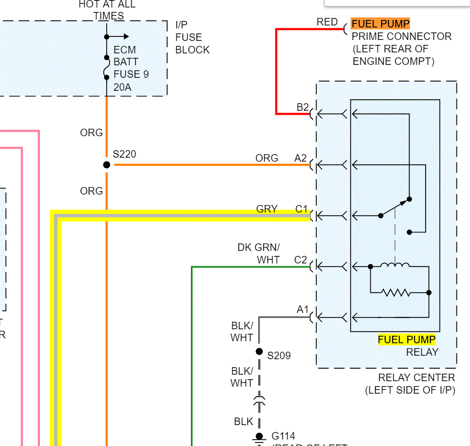

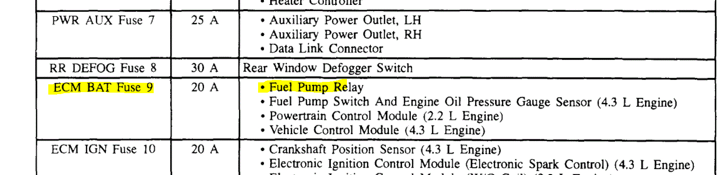

If there was no pressure, chances are the fuel pump is bad. However, before we replace it, lets confirm there is power available to it. Also, do you hear it prime when the key is first turned to the on position?

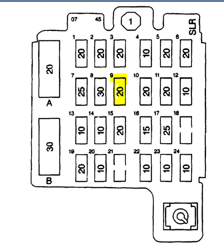

I attached three pics below. The first shows what fuse 9 powers. Note that it powers the fuel pump relay.
Pic 2 shows where the fuse is located in the box.

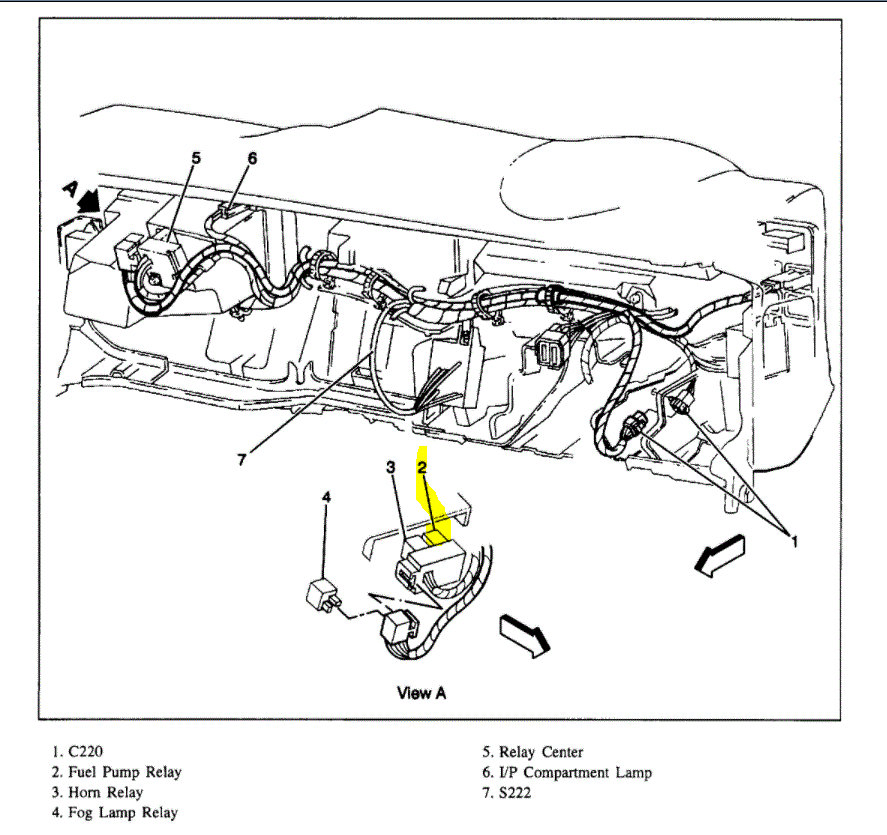

Pic 3 shows the fuel pump relay.
___________________
First, check the fuse and confirm it is good. In addition to just checking the fuse, make sure there is power to it.
If the fuse is good, next check the fuel pump relay. Here is a link to help:
Do this and let me know the results.

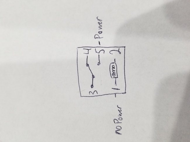

I retested the relay (mostly because I didn't want to drop the tank a third time) and there is no power to circuit 1-2 to power 3 to move to 5 to power the pump. So when I turn the key the relay isn't engaging to power the pump. (If I have to I will drop the tank but my guess is there no power getting back there)
Sep 29, 2020 at 11:12 PM
  • 110,240 POSTS
I agree, The problem isn't at the pump, it's before.

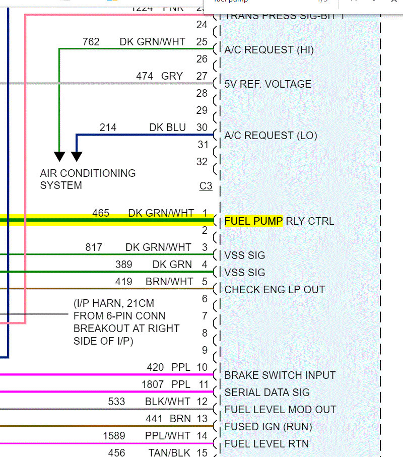

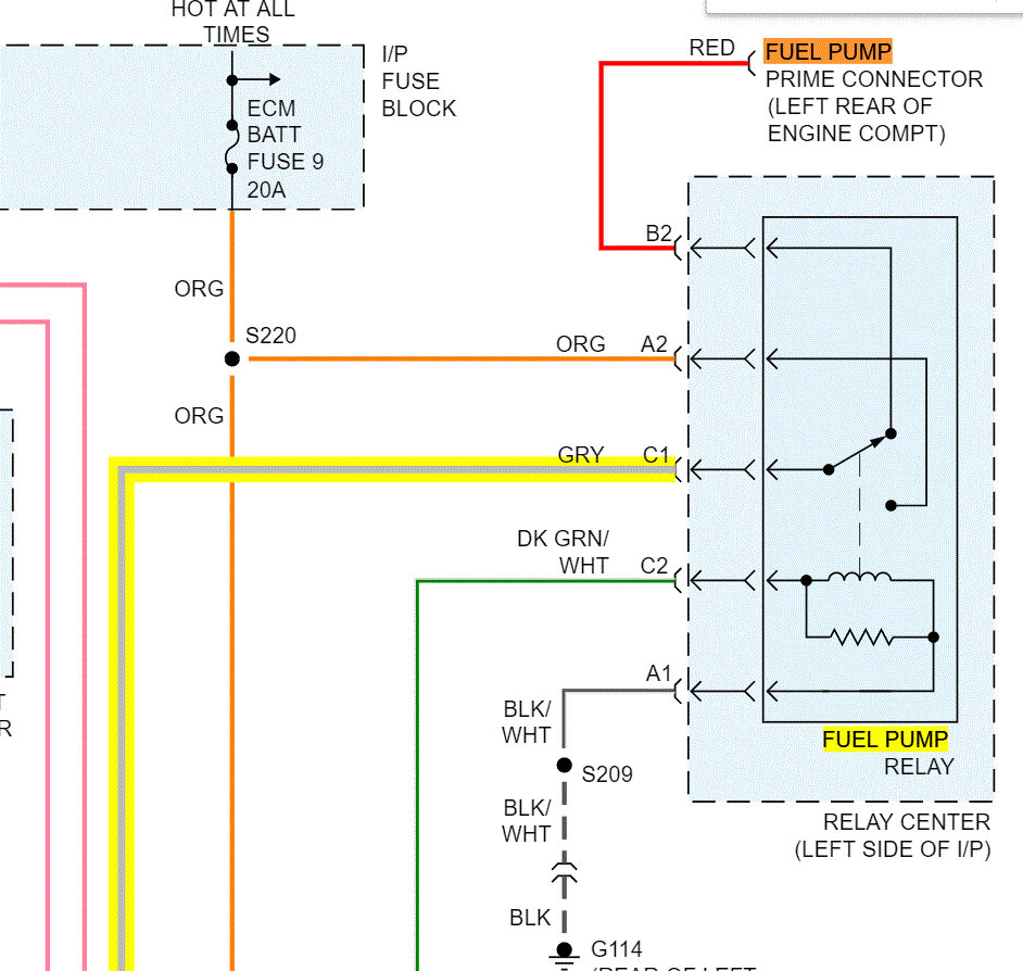

I attached two pics. I want to confirm there is now power to the dark green/white wire at the relay. See pic 1.
Next, if there is now power, move to the vehicle control module, right side of engine compartment, and check for a signal there. See pic 2.
Sep 30, 2020 at 10:59 AM
BOB31
  • 8 POSTS
There's no power to the dark green/white on the relay. I went and checked the 1st pin on that connector to the VCM and there's power getting to it.
Oct 1, 2020 at 8:49 AM
  • 110,240 POSTS
If there is no power at the relay but there is at the VCM, there wire must either have a break in it or a bad connection. I suspect you already checked for connection issues.
At this point, you need to check that wire for continuity from end to end to see if there is high resistance or no connection at all.
