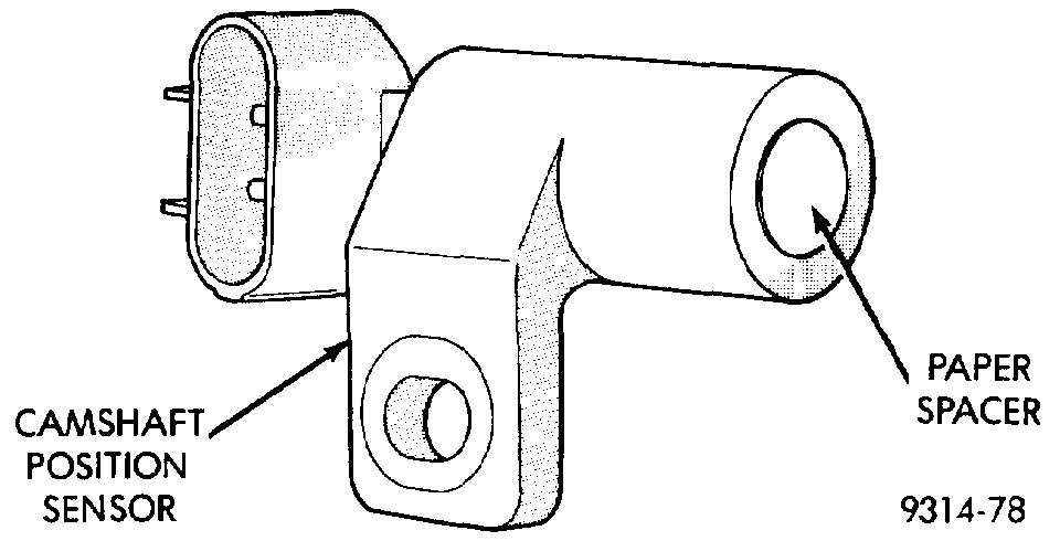

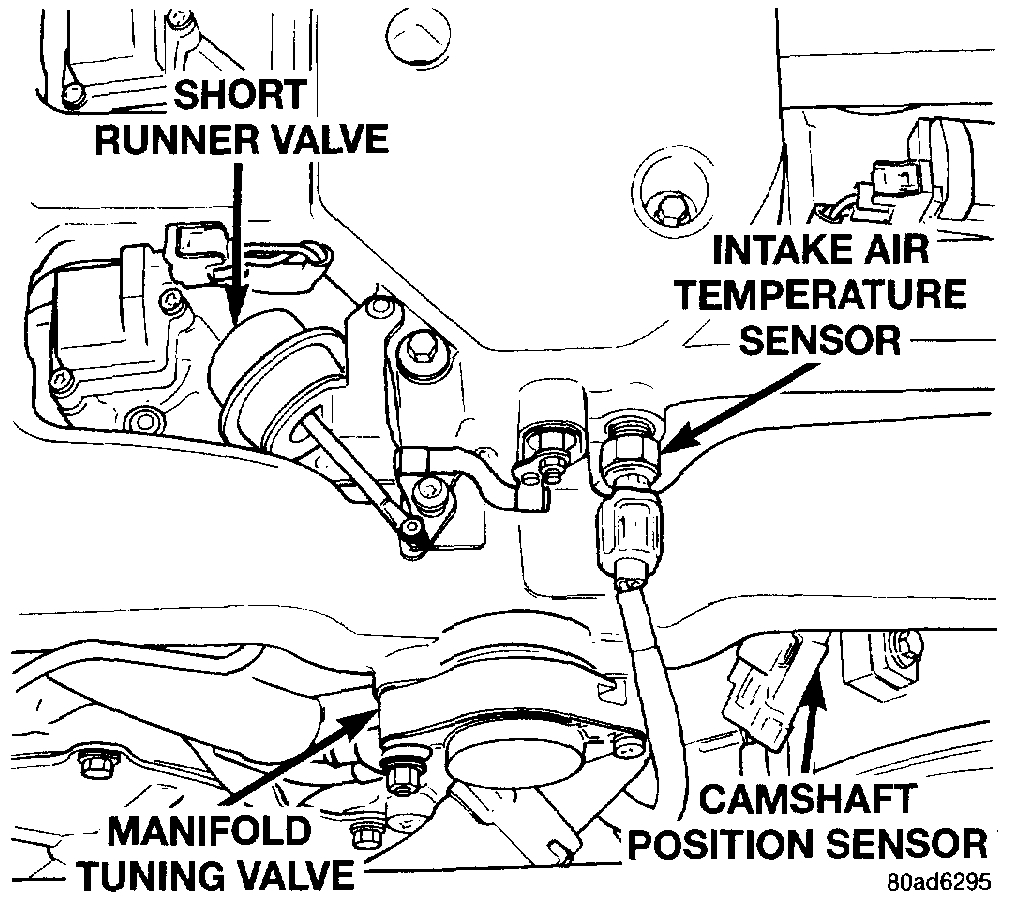

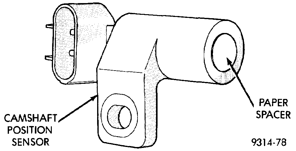

When you replaced the sensor, did you use the paper spacer to set it correctly? Here are directions for installing one. Make sure this is what you did. The attached pics correlate with the directions.
___________________________
REPLACEMENT
Camshaft Position Sensor
pic 1
The camshaft position sensor is installed in the timing belt housing cover above the left camshaft sprocket.

Paper Spacer
pic 2
If the removed sensor is reinstalled, completely remove the old spacer from the sensor face. Attach a NEW SPACER to the face of the sensor before installation. If installing a new sensor confirm that the paper spacer is attached to the face.
1. Install sensor in the timing belt housing and push sensor down until contact is made with the camshaft sprocket. While holding the sensor in this position, install and tighten the retaining bolt to 12 N.m (105 in. lbs.) torque.
