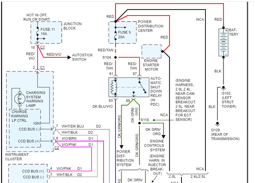

This car has no security system. The car started as it normally does and i drove about 5 minutes. upon trying to restart (engine still warm) got nothing. No dash lights, not even the digital odometer. Upon jumping it, it started and when disconnected the engine RPM went up and down. All electrical systems have gone haywire. Gauges jumping up and down. Engine warning lights and check engine light. Rear window defrosts going on and off. Headlights dim at about 2 second intervals. A random transmission code was thrown i cleared it and it didn't come back. When connecting a trickle charger, the odometer will illuminate but any load applied will turn that off. What i have done: Checked fuses and there is power in the distribution center and no bad fuses. Swapped relays around. cleaned all grounds i can find, none found corroded. Found 4 wires with deteriorating insulation going to transmission. Soldered in new wires nicely. Still same condition. Removed alternator and checked brushes looked okay and reinstalled. P.S. never solved the chugging starting condition but it's been that way a couple years and sure it's not related. Never failed to start. Could a short in the alternator cause this?

It sounds like the alternator isn't charging. What I need you to is test the alternator. You will need a voltmeter or a multimeter. It's easy to do.
Follow the directions in this link and let me know what you find:
The idea that you were able to jumpstart the engine, but it would stall when you disconnected the cables, this is my first suspect.

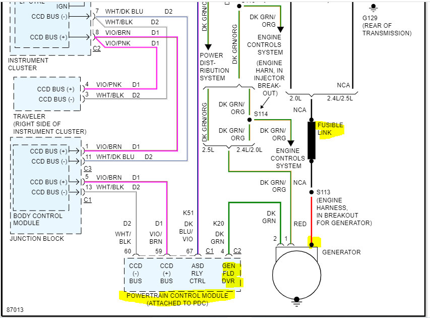

Also, the alternator could be good, but the voltage regulator may have failed. On this vehicle, the voltage regulator is integral to the powertrain control module. This is why I'm suggesting testing the alternator's output. Also, the alternator receives battery power via a fusible link between the starter motor and the alternator (red wire on the alternator). If there is no power to the alternator, it won't charge.
I attached the wiring schematic below, so you have a reference.
Let me know what you find.
joe
See pics below. Note: I had to cut the page in half to make it readable. I did overlap the two.

First, I have to say thank you for this essential public service. It's so important to people like me who are getting old and have no extra money, as you can see by the 1998 car i drive. That being said the alternator was my first thought as well. I took it out and opened it up and didn't see anything obvious. I had rebuilt this alt a couple years ago and i don't drive more than about 3,000 miles per year. Anyway, i started inspecting the wiring and found 4 wires inside a loosely wrapped insulation for heat. Oil seeped in and sat there and rotted the insulation on the 4 wires. I cut out about 18 inches of wire and soldered in a new appropriate nicely. Same condition persisted. I cleaned all the grounds i could find none were corroded but i polished them anyway. keeping in mind my battery is showing 12.5 volts. Just as i was fearing the PCM might be damaged from all this, a real mechanic retired and still has his tools showed up. He hooked up his gadget and said although the battery is showing that voltage, something is wrong inside it and it has no amps. I asked how could i still have crazy electrical system after a jump start. He said let's start with this battery. The new battery and the car is running normally. Boy did i feel foolish going over fuse's relays inspecting wiring for 3 days. Good part is i found the bad 4 wires they went to the transmission. Thank you for the schematics I'll put them to good use I'm sure. Sorry i wasted your time and thank you again. PS, this car has 21500 miles been a really good car. Original engine and trans. I sent a message to you not to bother and evidentially you didn't see it yet. So, if you could email a simple verification that you've seen this, that would be great. thanks again.
