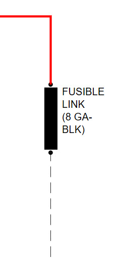

I am about to buy the vehicle listed above and the woman saying she has to keep the battery charged. she said it will stay charged for couple days when she drives it back and forth to work, but she lives a mile from work and if she forgets to charge the battery the car will shut off when driving. it has a new battery and alternator what could this be?

check to see if it is charging or has a parasitic draw on it. most places check battery for free and charging like auto parts. also, check fusible links for alternator as well as belt and tension-er as recommended replacement for belt and tension-er is 60,000 miles or five years. See link for parasitic draw.
https://www.2carpros.com/articles/car-battery-dead-overnight.
Fusible link should have battery voltage both sides, it runs off of battery and is a red wire turning into black. Test at alternator.
