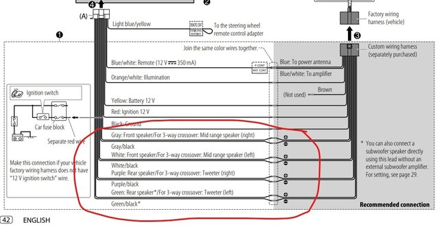

Hi, wondering how do you wire a pair of 6x9 speakers to a 2-channel amp in case I've done something wrong, other than the load is it the same as wiring subs? I just tried and the amp is getting power but no sounds coming out? Subs are off another amp no problems there.

Also, my head unit has 3 RCA spots in the back, front rear and sw, subs r in the sw and I tried the second amps rcas in the rear spot?

Xm5552zr amp of speaker, dk1800 amp for dubs, kwx850bt head unit.

Okay, for that unit if you are using the amp inside the unit, you connect up the 4 other speakers to the circled wires in the harness. So gray and gray black for right front, white and white, black for left front, purple and purple, black for right rear and green and green, black for left rear. (the ones with the black stripe go to the negative terminal on the speakers) Then the subwoofer amp gets fed from the SW RCA jacks. Then you have to use the 2-way crossover setting.
If you are using a different amp for the 4 speakers, then you use the RCA output jacks to connect the LF RF RR LR outputs to the correct line inputs on that amp and still set the head unit for 2-way crossover.
If you are not using the internal amp in the head unit, be sure to isolate the speaker wires and tape them up so they cannot short out on anything.

Was planning to use the amp in the unit to run the four door speakers off the head unit and then another two 6x9 off the xm552zr 2channel, if that is possible?
May 27, 2024 at 6:28 PM
STEVE W.
  • 15,349 POSTS
So, you are thinking 4 door speakers plus 2 6X9 and then 2 subwoofers? Don't think that will work. Many of those style units cut the internal amp when you plug into the secondary outputs. So, if you plug into the "rear" RCA jacks for the XM amp and 6X9s it will turn off the internal amp and you lose the power to the 4 other speakers. The info doesn't say so, but many do that. You should be able to tell if you connect up just the 4 door speakers first, test that it works. Now plug in the subwoofers and see if they work. If you get 4 door speakers and subwoofer then for testing unplug the subwoofer and plug it into the rear speaker RCA connectors, do you still have all 4 door speakers? If not, then it does mute the output and limits you to just the 4 door speakers and the subwoofers.
