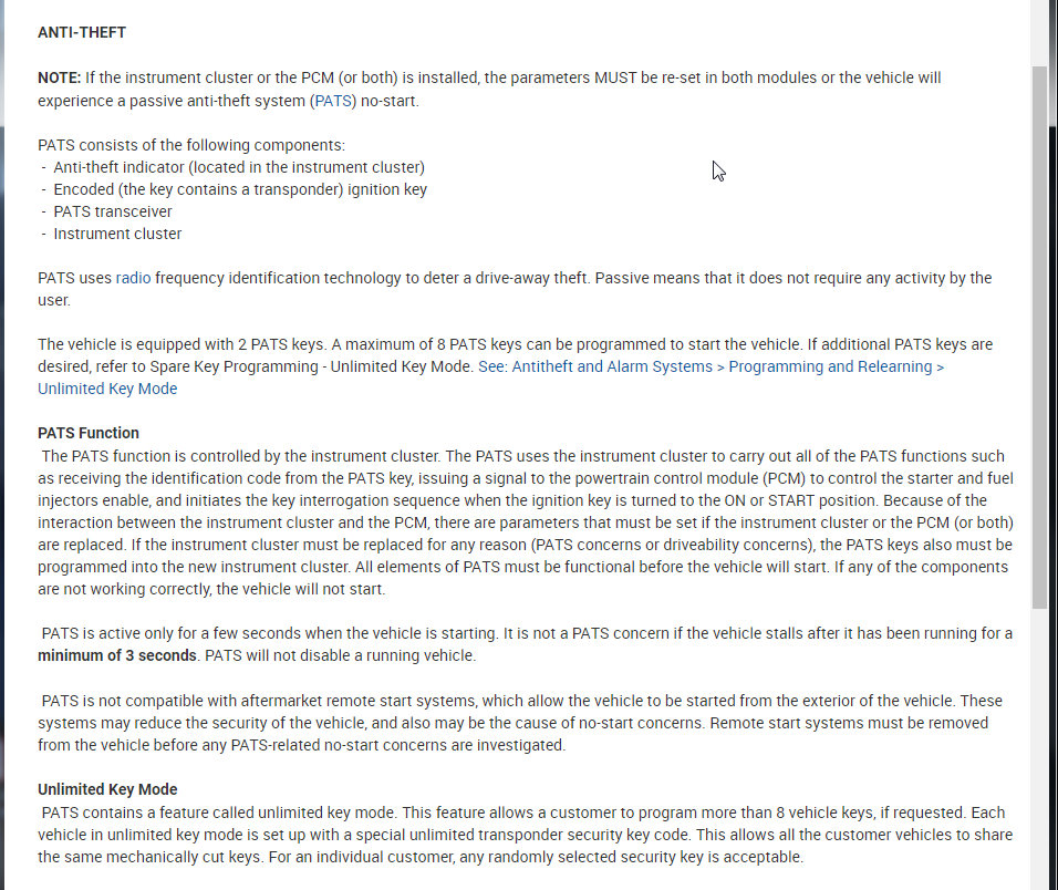

Okay, so my friend broke into my car by taking out the outside door handle the whole thing then got inside and stole the lock cylinder. And stole my keys. And key beeper thing. So now i don't know what to do because i also don't have the title to my car. So i can't take it into the Ford dealership. i was wondering if i replace the whole steering column and the computer and the key and it's all from a different Ford Expedition will it work or am i just out of luck?

That sounds unfortunate. I attached the info below on this system.
In short, you need to replace all the components from the other vehicle if you are going to go that route. Then you need to reprogram the PCM so that it learns the new system.
Please let us know if you have other questions on this. Please see below for the detail. Thanks
