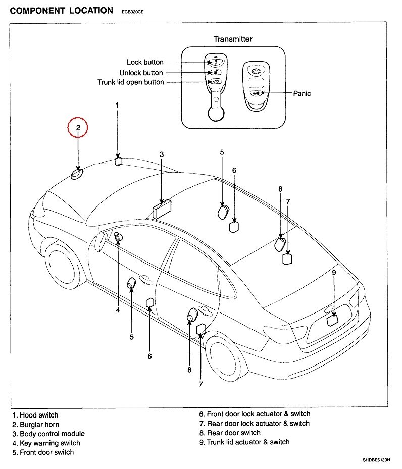

A less common thing to look at is switches out of adjustment. Your alarm is set off if the hood, trunk lid, or any door is opened before the alarm is turned off. Try lifting the hood and trunk lid without unlocking them. If tugging on one of them sets the alarm off, check the adjustment of that switch.

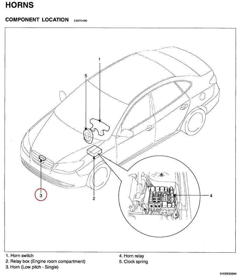

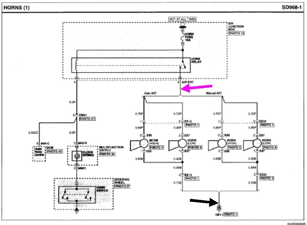

The only diagram I can find is for the base horn system, in the diagram below. The only thing shown running the horn relay is the horn switch on the steering wheel. The alarm system has to enter in there too, but since it's not shown, I added the pink and black arrows to show the next best places to cut a wire if you want to add a switch to silence the horn. I strongly recommend to not dig into the fuse box as it's possible to create all kinds of new problems. Instead, cut the pink wire that feeds the two horns or the black wire that is the ground for both of them.
The horn circuit is protected with a 15-amp fuse. A ten-amp switch will handle the current just fine when it's turned back on and the horn is used.
I found two different drawings to show the location of the horn, but there's some confusion here. In the middle image, it's called the "burglar horn". In the third image, it's just called the "horn". That implies they're two different horns, but they're shown as being in the same location. If these are indeed two separate horns, it would be a simple matter of unplugging the burglar horn. Don't do that if there's just the one horn for both functions. Doing so could leave you open to liability issues or the inability to warn someone.
