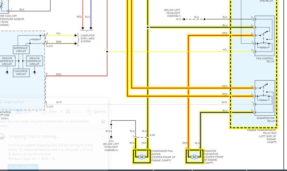

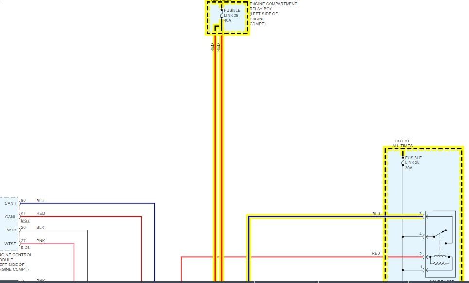

Are the cooling fans running with the A/C on?
https://www.2carpros.com/articles/how-an-electric-cooling-fan-works
If they are not working, the air will not be cold especially at idle. When you drive, you are forcing air through the radiator.
May 1, 2020 at 11:59 AM
PETROYADA
  • 66 POSTS
Yes, the cooling fans are running with the A/C on.

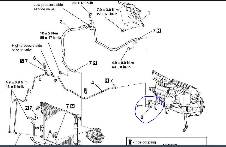

Low side :45 psi.
High side : 150 psi.
In idle .
May 1, 2020 at 5:52 PM

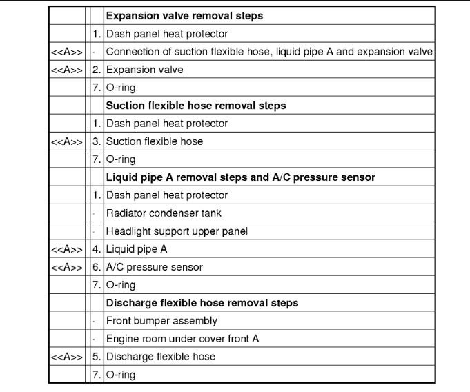

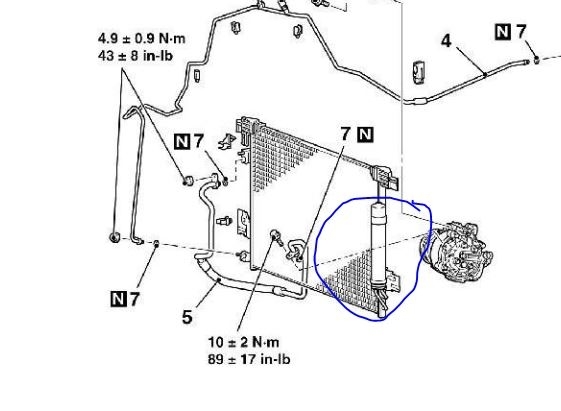

Okay, the low side is too high. It should only be 25-30 pounds and rock solid.
The high side should be 2 times outside temp plus 15%.
It looks like you need a expansion valve and a dryer so far.
