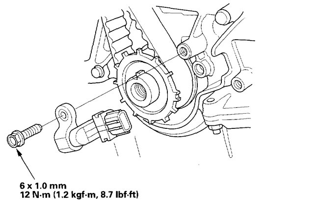

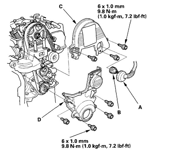

Hey, I have the car listed above LX model. When I drive for thirty minutes straight and it is hot outside my car will stop going and I have to park somewhere for a hour to try to start again. I got my radiator replace but it still doing the same thing.

This could be the result of several things. However, one thing you mentioned leads me in the direction of a crankshaft position sensor. You said when it cools down, it will restart. What I would like for you to do first is read through the following link. It discusses symptoms of a bad sensor. Take not that a bad sensor may not always a trouble code.
If you find the sensor is the issue, here are general directions for replacement:
If you determine the sensor is bad, here are directions specific to your vehicle for replacing the sensor. Pictures 1 and 2 correlate with these directions.

CKP Sensor Replacement

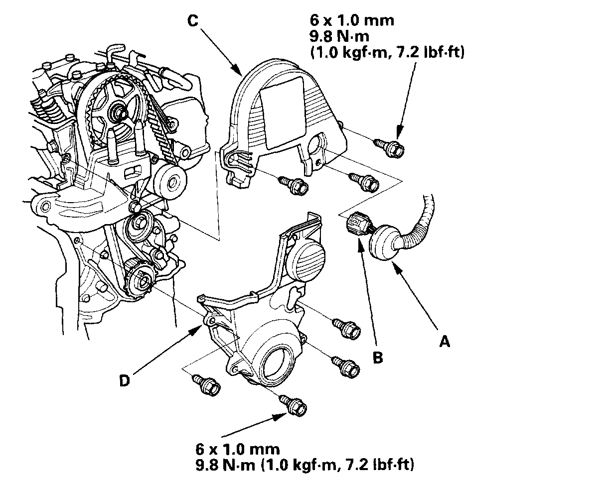

1. Remove the grommet (A) from the upper cover, and disconnect the camshaft position (CMP) (top dead center (TDC)) sensor connector (B).
2. Remove the upper cover (C) and lower cover (D).

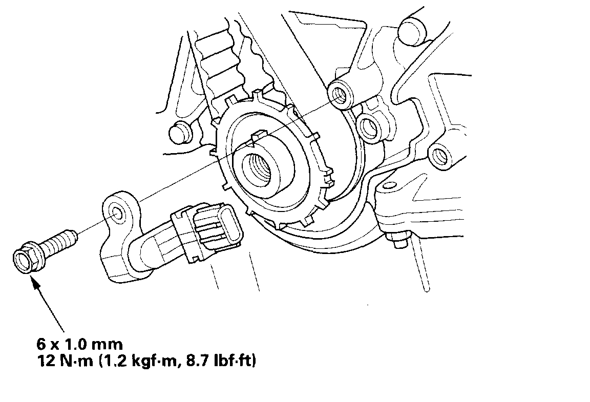

3. Disconnect the crankshaft position (CKP) sensor connector, then remove the CKP sensor from the oil pump.
4. Install the CKP sensor in reverse order of removal.
I hope this is helpful. Let me know if you have other questions or need additional help.
