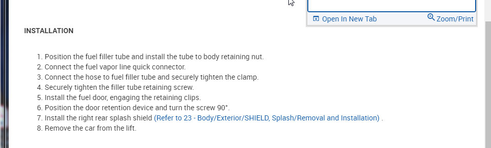

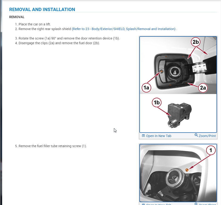

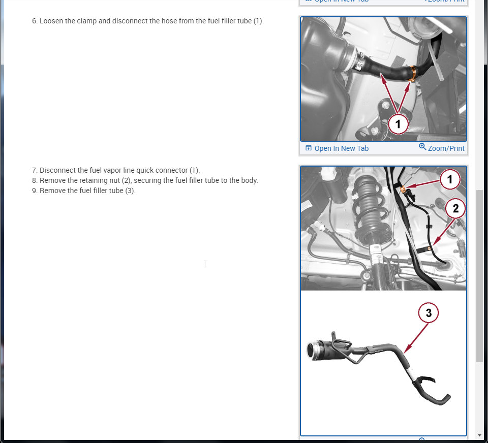

My cap-less fuel tank is broken, I had a friend pump by gas and she pulled the exterior part of the cap-less fuel tank right off. it broke a spring or something as well and now my car will only take in a few cents of gas at a time, is this fixable?
Jul 11, 2020 at 2:36 PM

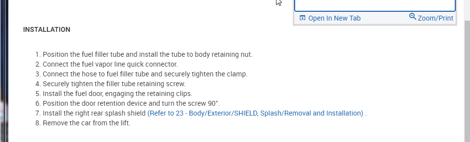

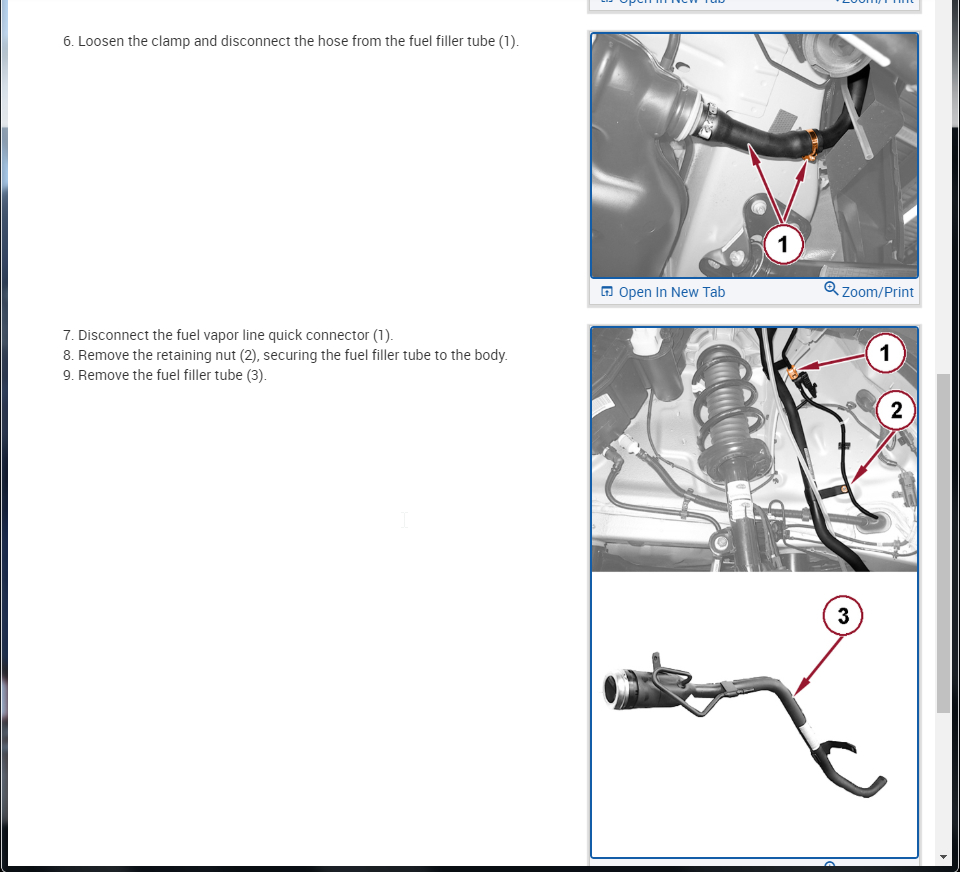

This is fixable but the whole assembly needs to be replaced. I attached the process for your review. Let me know if you have questions. Check out the diagrams (Below). Please let us know if you need anything else to get the problem fixed. Thanks
