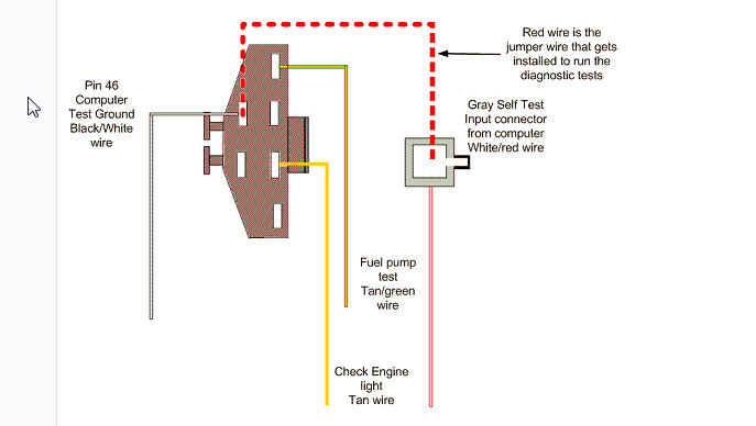

I have tried the jumper method and I have tried a scanner (from AutoZone); I have also tried connecting the single connector to a ground. With KOEO nothing happens. Scanner doesn't indicate it is connected to computer; with jumper method, Check Engine light stays on. I have even exchanged the ECU with a rebuilt one. I have checked continuity of the wires from the computer to the test port, and they are okay. I don't know what else to check.

Just to clarify, you are using a scanner and the jumper wire? What connector are you doing this with? Can you get a picture of and is it under the dash or in the engine bay?

I have tried using a Ford OBD I scanner from AutoZone. I have tried a jumper from the "F" terminal for the test connector (upper right terminal when viewing the plug with the narrow side up) to the single-pin connector. I have tried a jumper from the single-pin connector to the the negative battery terminal (all suggested in various posts). All with no results. This is the standard 6-pin Ford OBD I 1981-95 connector. On my 1995 Mustang GT the connector is under the hood on the passenger side fender.

Okay. Sounds like you are getting the jumper in the correct place. Read through both attachments just to confirm this is what you are doing and you are not missing a step like pushing the clutch in and AC off.

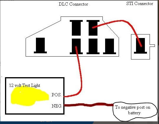

It appears the lamp is operating but I suspect we are expecting it to flash the codes but I am wondering if it will work with a test light. Basically take a test light and probe one of the terminals and then use a paper clip in the other terminal and clip the alligator clip to it.
I don't think it should matter but all the info is saying to use a test light so maybe it is an operation understanding issue on our part. I don't remember doing it this way on a Mustang but this is a 1995 and that is the change over year so it may just be as simple as the check engine light doesn't flash but the test light will.
https://www.2carpros.com/articles/ford-lincoln-mercury-obd1-1995-and-earlier-diagnostic-trouble-code-definition-and-retrieval
I am not sure that there are codes if the light is not constantly on but you should be getting an 11 if there are no codes.

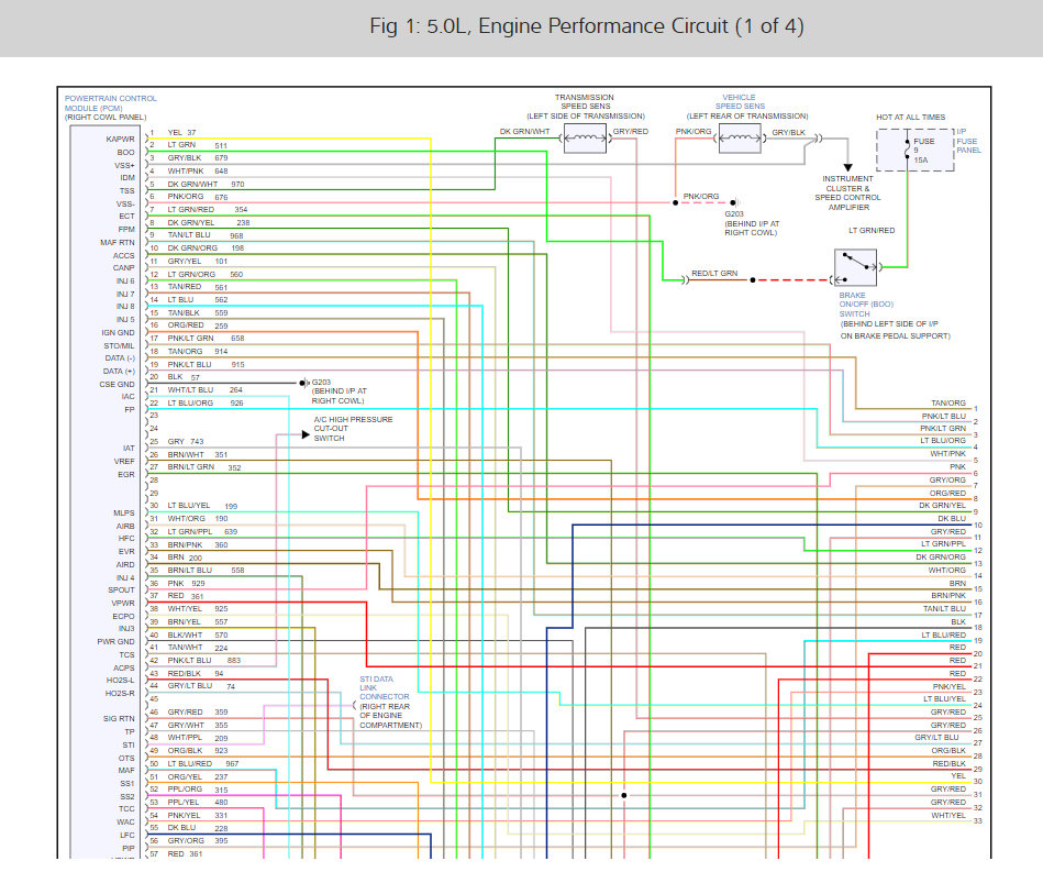

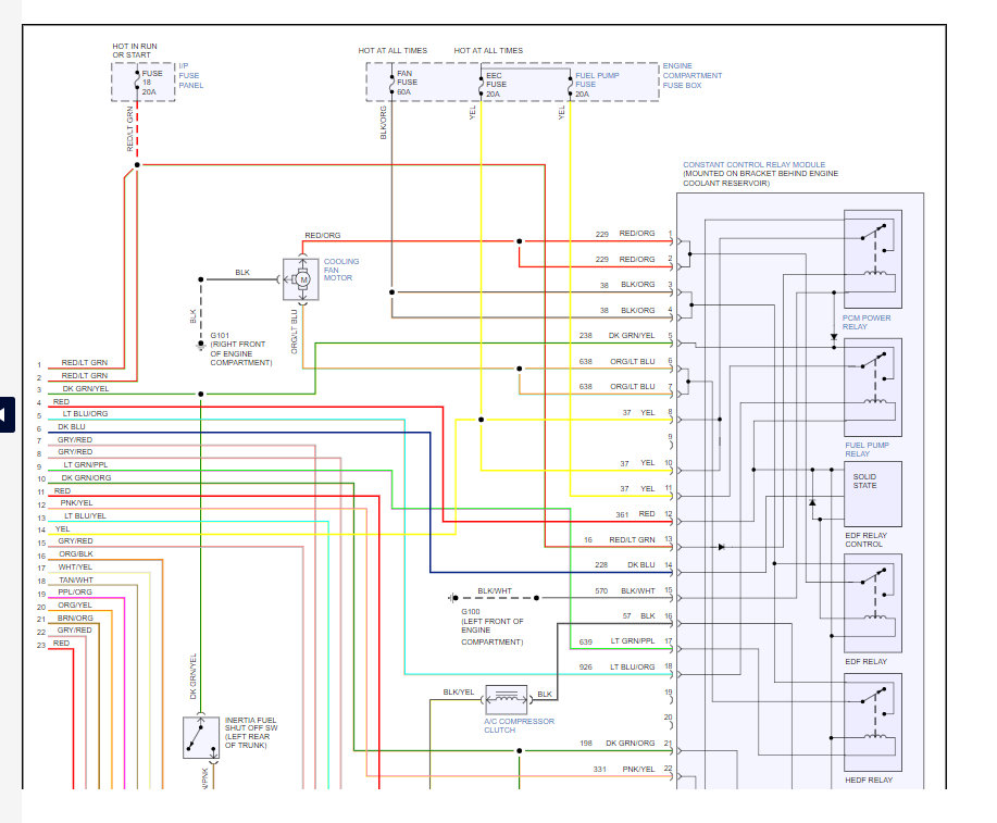

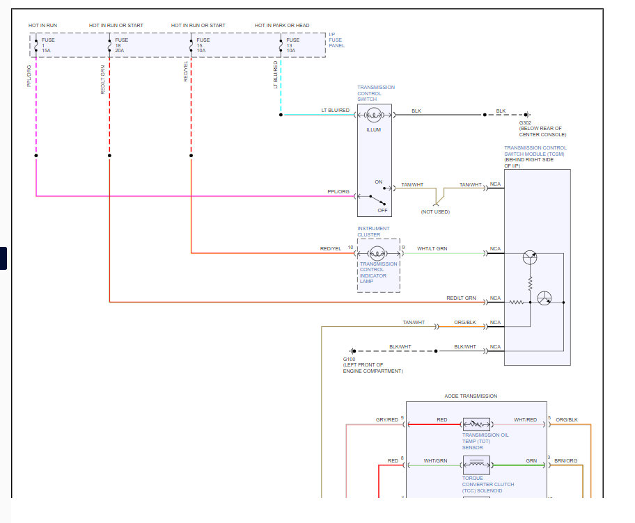

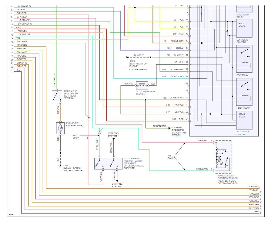

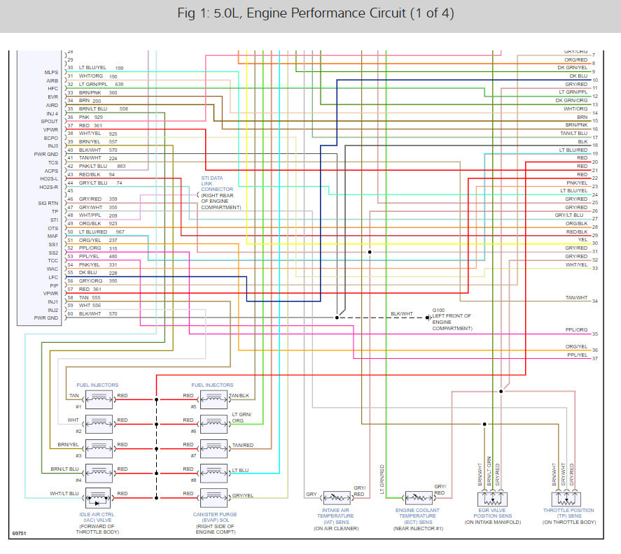

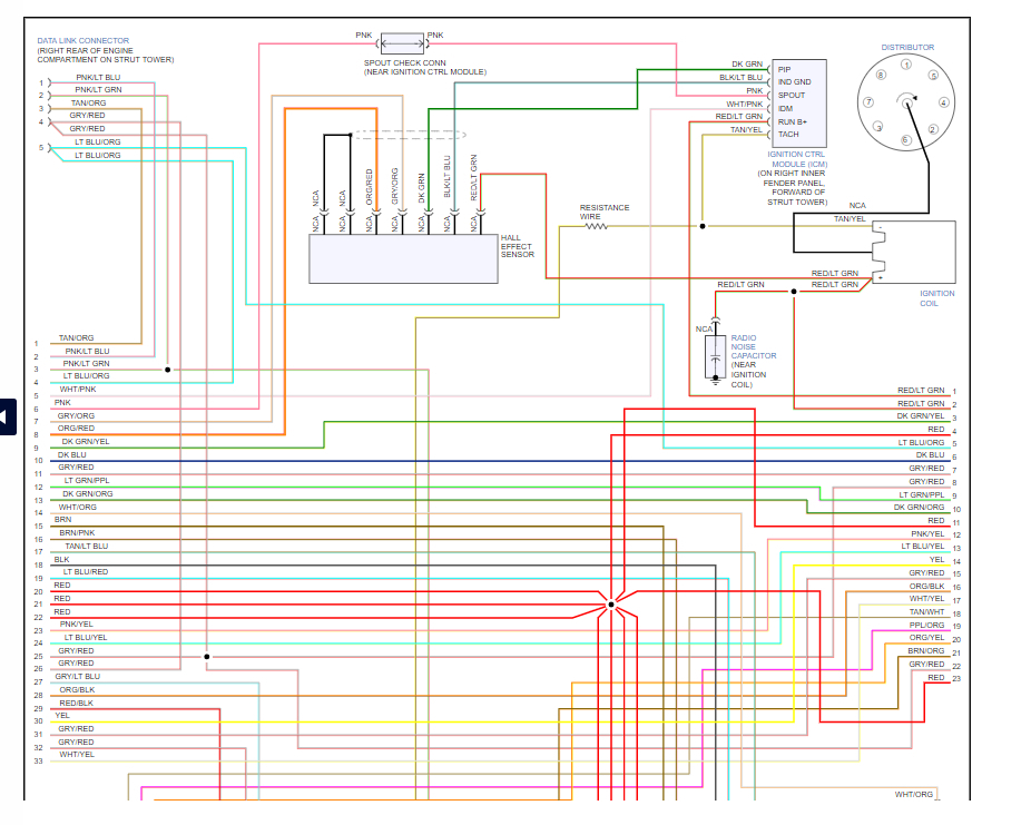

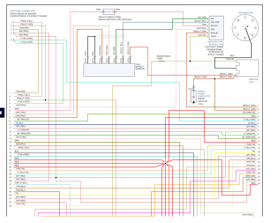

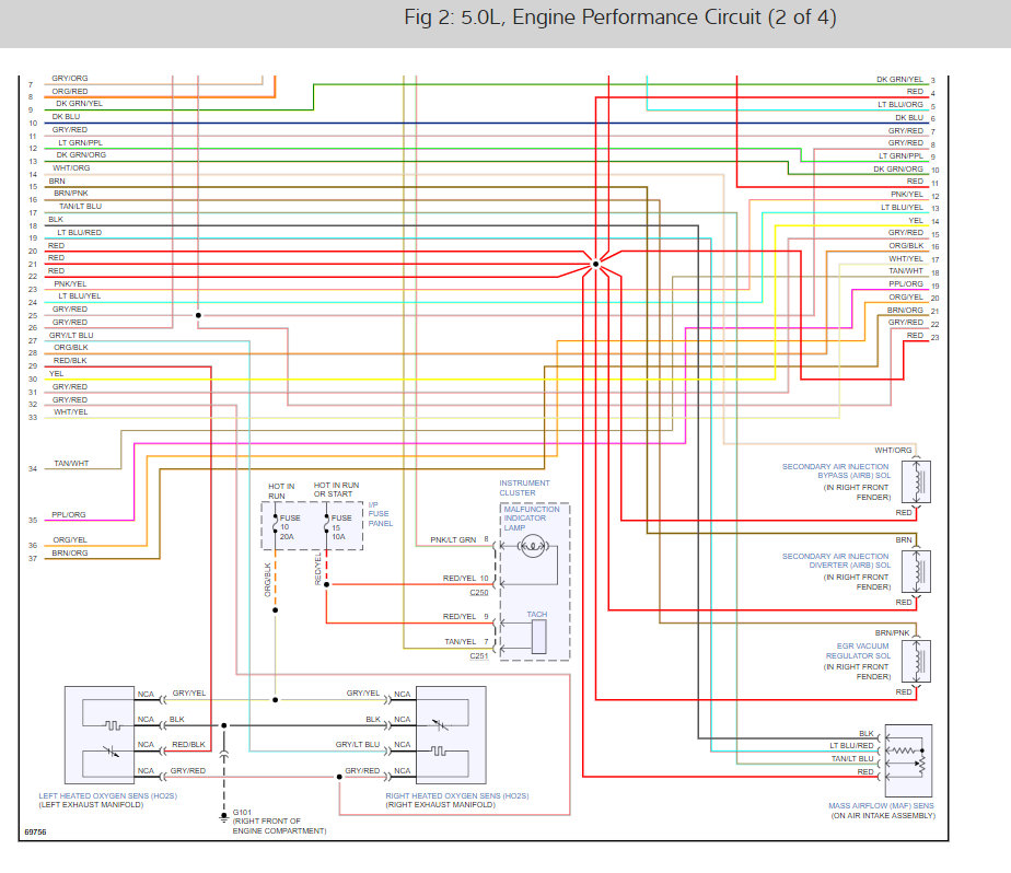

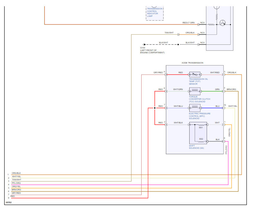

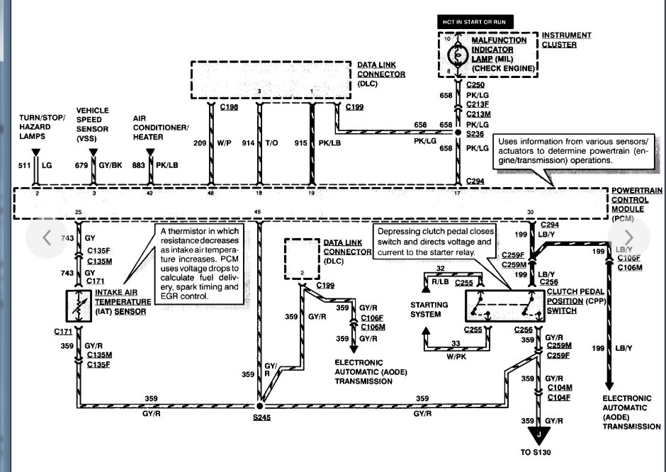

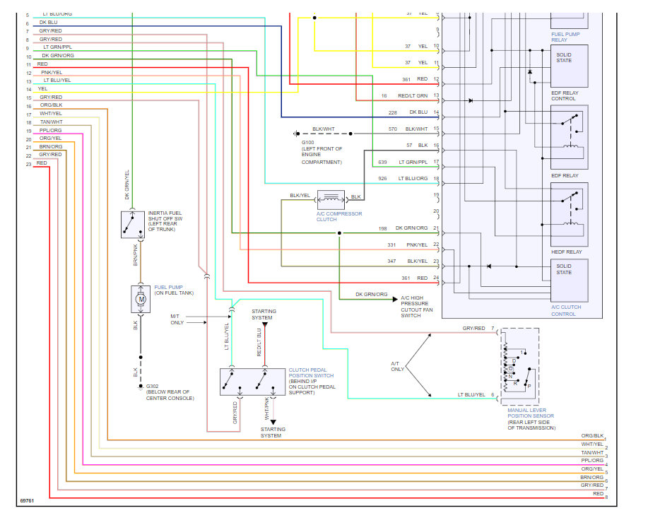

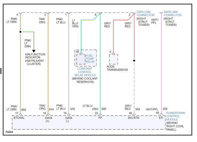

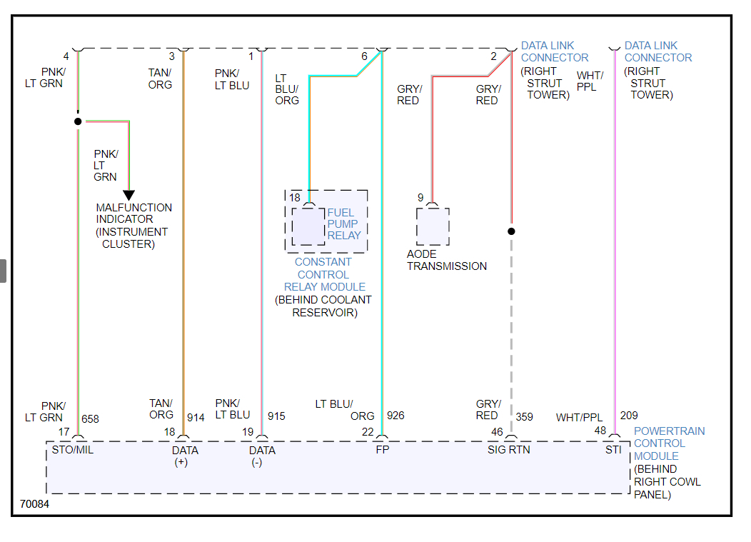

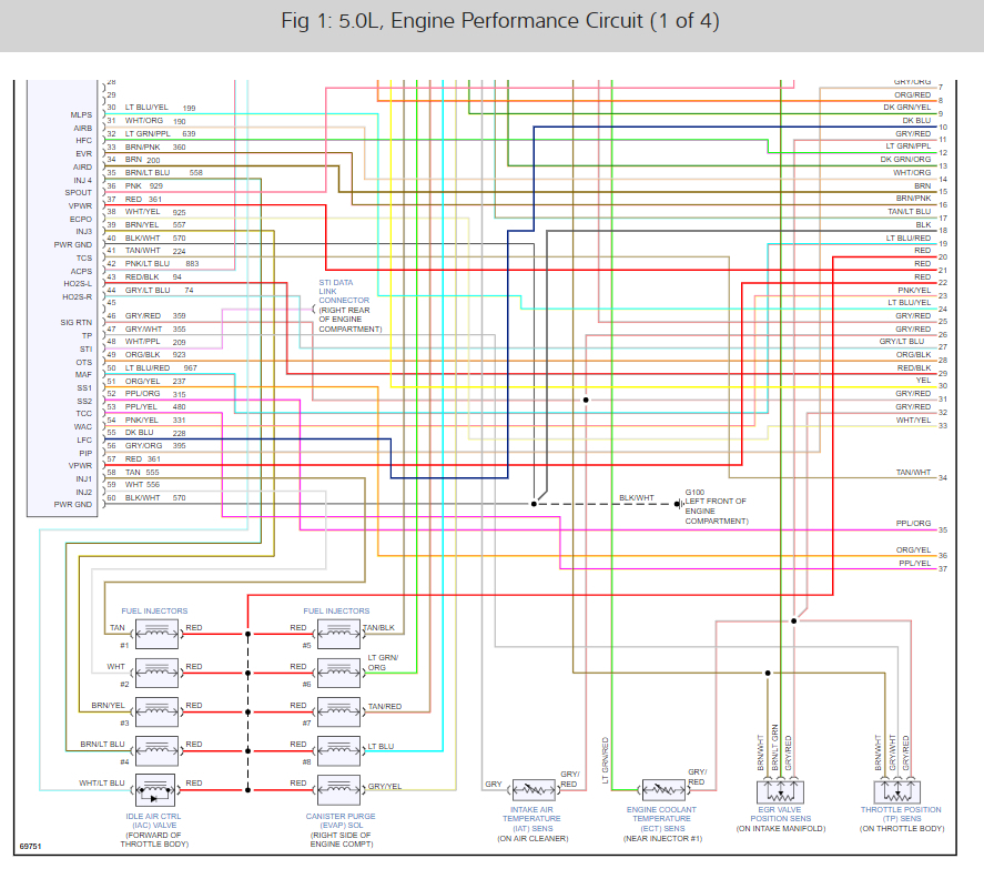

This sounds like a grounding issue. I would check all engine wiring and the ground connections as well. here is a guide to help you with the engine wiring diagrams:
Here are the engine wiring diagrams and OBD1 wiring as well. Please follow the guide and get back to us. Check out the diagrams (below). Please let us know what happens.
Apr 8, 2020 at 3:35 AM

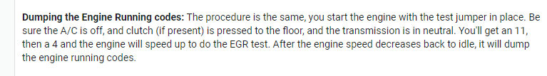

That should have the EEC-IV It's supposed to be an OBD 1A system. To pull codes you connect a jumper from the STI terminal to pin 2 on the OBD connector. Then take a test light and connect it to Ground and put the probe into self test output pin. The test light should glow real dim. Now go inside the car and turn on the key. This should start the check engine light and test light flashing the codes. On this car it can have 2 or 3 digit codes depending on build date and programming. It should flash each KOEOff code 3 times and in progressive order. Write them down. Then it should flash once after a few seconds, then it will flash once again after a few more seconds. Now it should flash the continuous memory codes. Write those down as well.
Now you can disconnect the light and jumper.
Start the engine and warm it up. Shut off the engine and wait 10 seconds. Now connect up the jumper between the STI and self test pins again. Start the engine and stay in the car.
The check engine light will flash a cylinder code, for the 8 cylinder this will be 4 flashes. Next should be the dynamic test, it will be one single flash that happens between 6 and 20 seconds after the cylinder code. When it happens you step on the throttle all the way to the floor and back to idle in a couple seconds. Now any stored codes will flash, these will be the KOERunning codes. Write those down and tag them KOERunning.
Have the OP post those codes and you can look them up. If it doesn't flash anything during the testing with the key on engine off or KOERunning, there is a failure in the self test system wiring.
