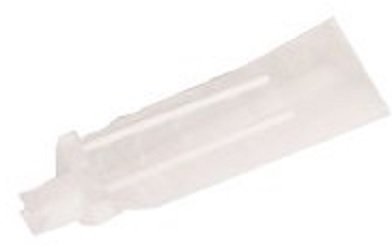

I have the car listed above with a 3100 engine. The code po171 came.up and I changed the bank 1 02 sensor and the mass air sensor as well. The car will be do good then it will sputter and shut off and wont start back up. After a while then it will start and go about a half mile and shut off again . Help please

Another good suspect for the symptoms you described is a plugged or collapsing strainer inside the gas tank. It's shown in the photo. This is a really elusive thing to diagnose. The first clue for fuel-injected engines with the pressure regulator on the fuel rail on the engine is the stalling will occur when the highest volume of fuel is being pumped, which is during coasting. The first time this happened to me, the engine ran fine for over 200 miles on the highway, then it stalled when I coasted off my off-ramp.
To prove this is causing the stalling, connect a fuel pressure gauge and clip it to the radio antenna or under the right wiper arm so you can watch it when the problem occurs. Normal fuel pressure for my Caravan is 45 -50 psi, but the stalling didn't occur until it fell below 20 psi. GM engines aren't so tolerant. Often they will stall by the time fuel pressure drops as little as five to ten pounds.
The next clue is the engine will restart after you've been sitting on the side of the road for about five minutes. That gives the collapsed strainer time to stretch out enough to let fuel flow again. Crank and cam sensors will also work again after cooling down, but that typically takes about an hour.
