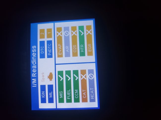

thank you so much for your advice . i woke up this morning put a scan on and this is my readout . i haven't checked for vacuum leak as yet but going to do now.can i put smoke from air intake to detect vacuum leak?

This is the scan read:

You can introduce fog or smoke into the system but that may or may not find this type of leak. However, I would try the technique indicated in the link above. Also, can you let me see the short term fuel trims?
