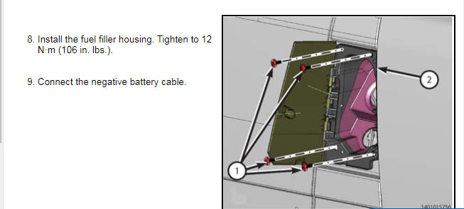

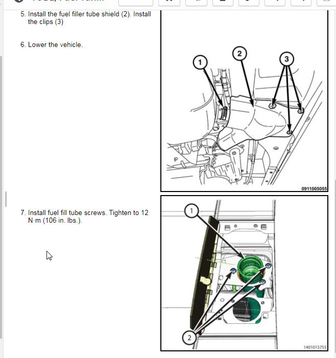

Cannot fill fuel tank
2018 RAM PROMASTER
64,000 MILES • 6 CYL • 2WD • AUTOMATIC
RONABBOTT

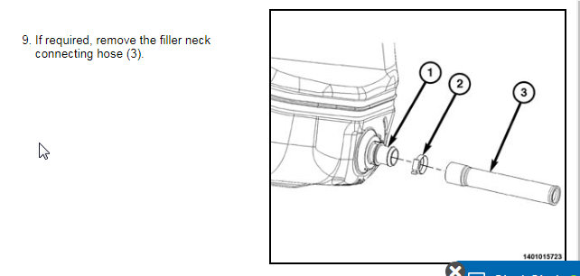

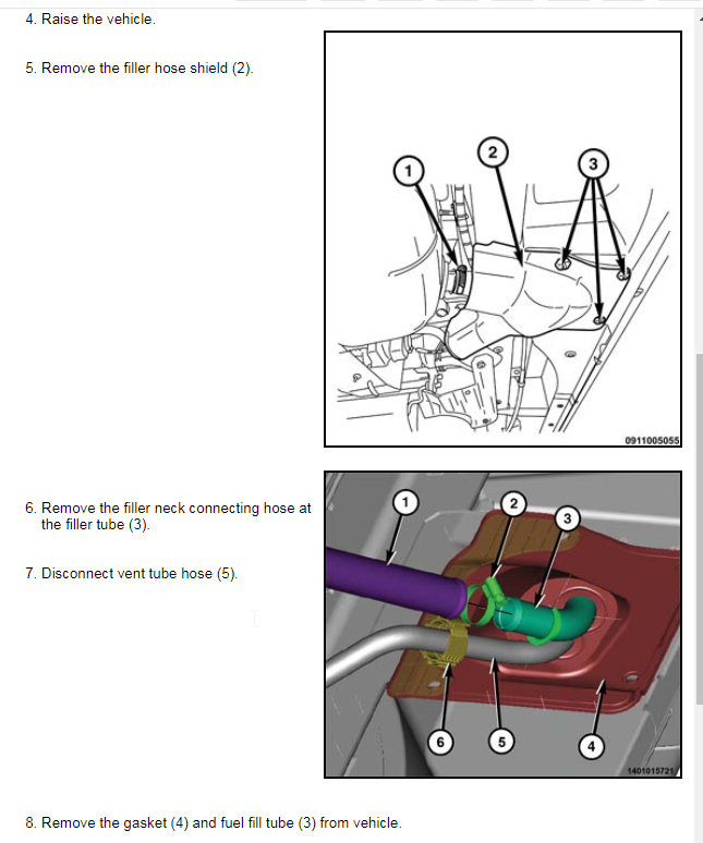

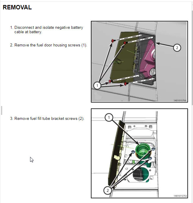

Nozzle keeps kicking off, not sure where vent tube goes to to remove and blow out.
Nov 17, 2019 at 9:40 AM
I have seen a couple of these with this issue and they are not vent line issues. They normally get a leaf or something in the fill neck itself. However there have been some that the tank itself is the issue. Due to this being a new vehicle it may still be under warranty. You are a little high on miles so it may not be covered but if you take this apart, they will surely decline it if it is found that you "tampered" with it (that is how they will see it).
