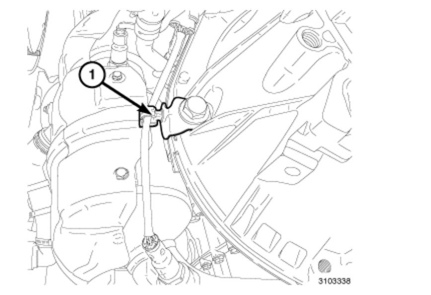

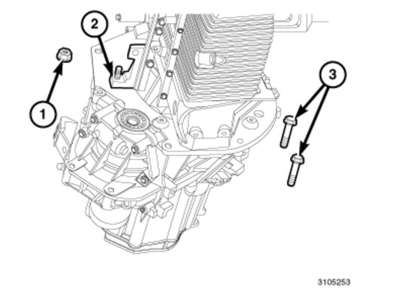

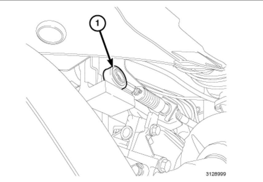

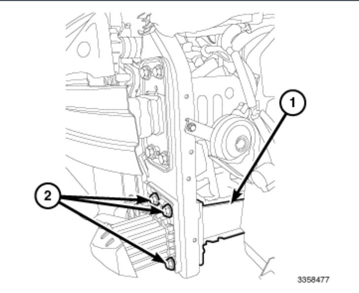

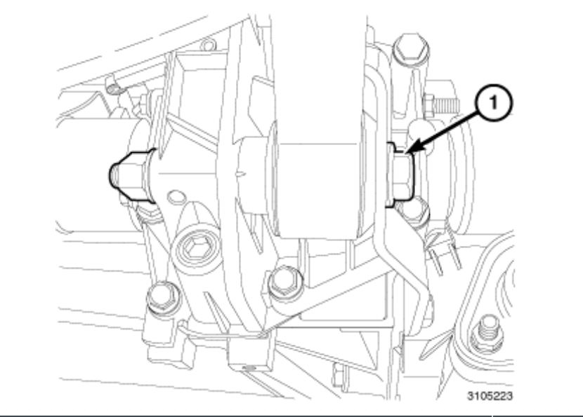

When I put my foot on the clutch and attempt to put the gear stick in any gear, it moves out of position and looks like it springs back to neutral.
Jun 29, 2020 at 5:43 PM
Good morning,
I attached a recall for you to view on this issue.
I would call the dealer and give them your VIN number and see if your car is involved in the recall.
If the plate fractures, it could bounce the shifter back to neutral.
Beyond that, it sounds like you will need a clutch.

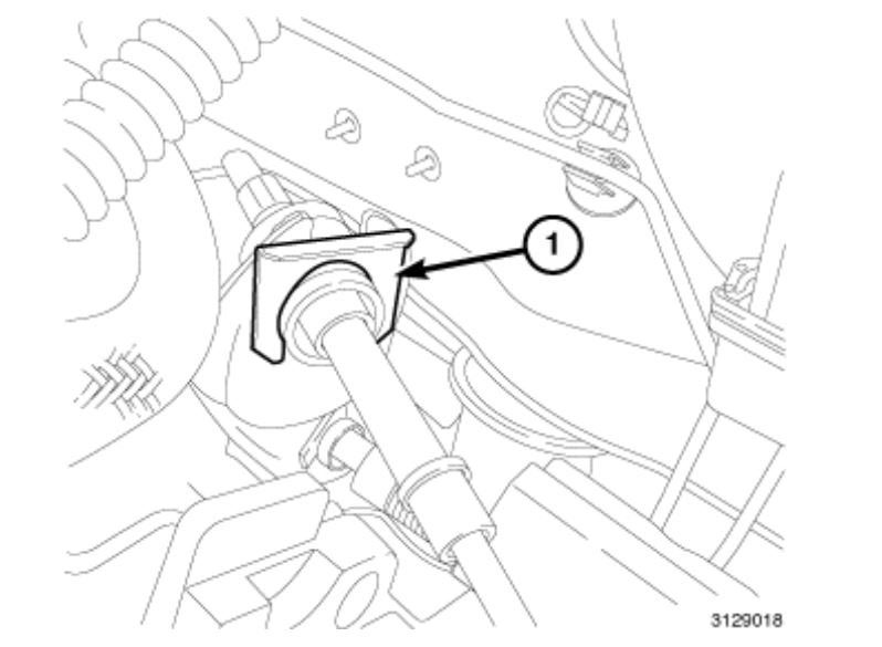

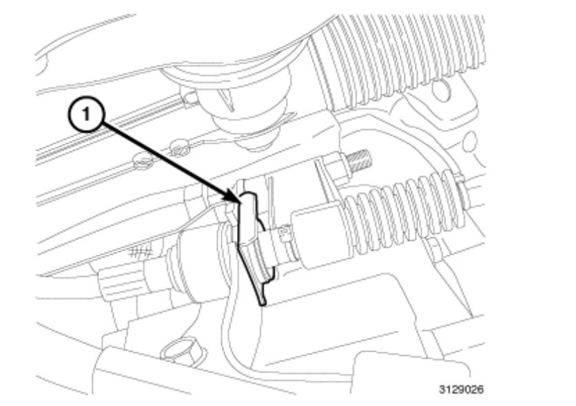

REMOVAL
1. Remove battery tray See: Battery Tray > Removal and Replacement > Battery Tray - Removal.
2. Remove air cleaner assembly See: Air Filter Element > Removal and Replacement > Air Cleaner - Removal.

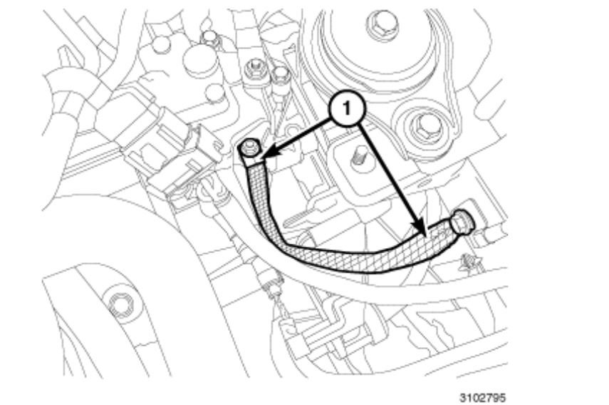

3. Remove the ground strap (1) from the transmission.

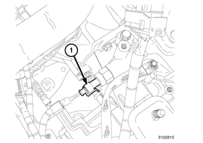

4. Disconnect reverse lamp switch connector (1).

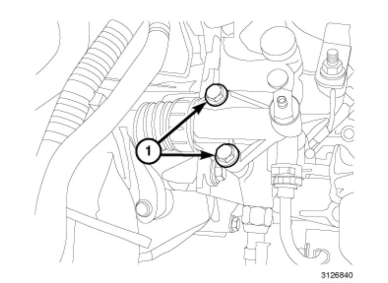

5. Remove the slave cylinder bolts (1) and secure the cylinder out of the way.

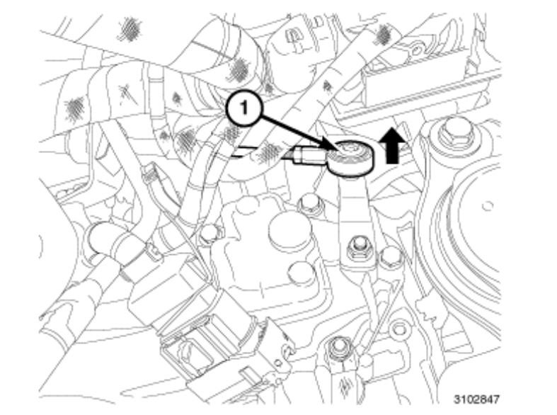

6. Disconnect shift selector cable (1) from the lever.
7. Disconnect the cable from the mounting bracket (1).
8. Disconnect the shift cable (1) from lever.
9. Disconnect the cable from the bracket (1).

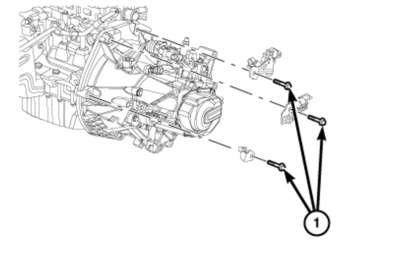

10. Remove upper bell housing bolts (1).

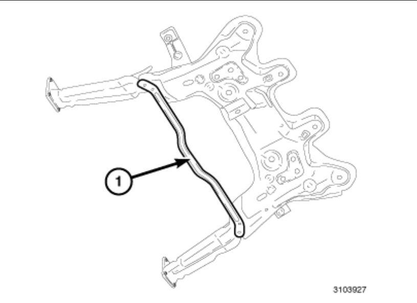

14. Remove the cross car cradle brace (1).

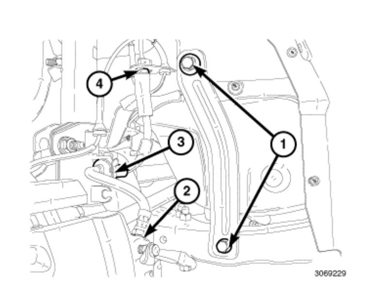

18. Remove two bolts (1) and the left vertical brace from the vehicle.
19. Remove four bolts (2) and the left lower frame extension (1).
20. Disconnect the oxygen sensor wire from the loom/clip (1).

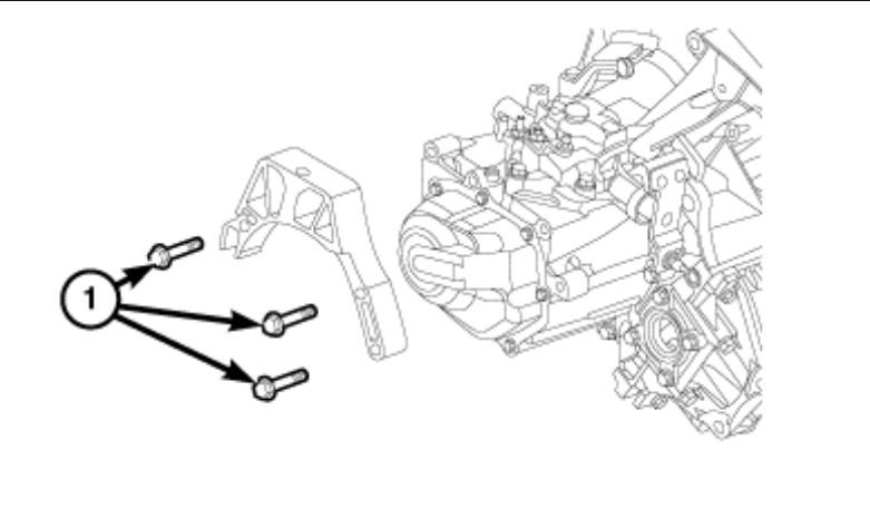

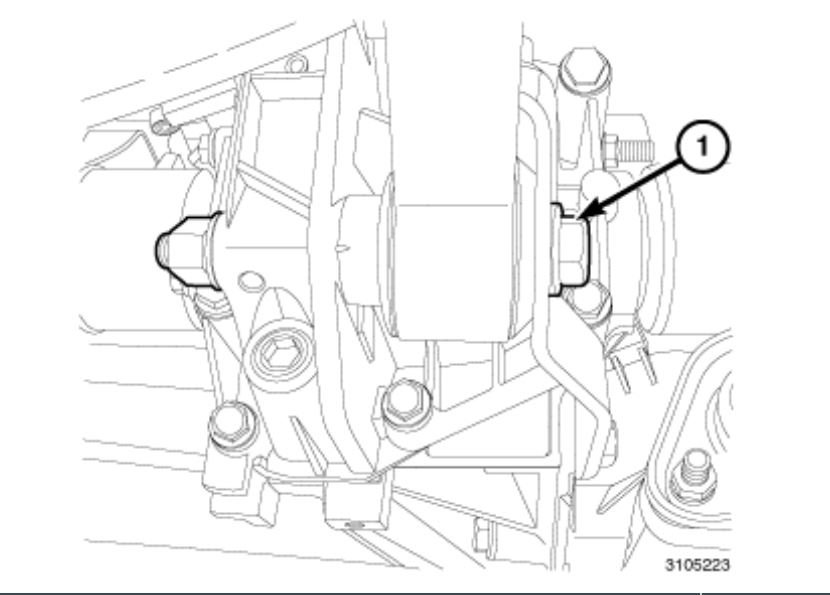

23. Remove the left side bolts (1) and mount.

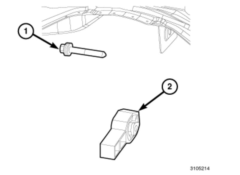

24. Remove the rear transmission mount bolt (1) from the frame.
25. Remove the rear transmission mount bracket bolt (1) and bracket from transmission.
26. Remove the remaining transmission bell housing bolts (3).
27. Remove the nut (1) and the stud (2) from the transmission case to facilitate removal.
