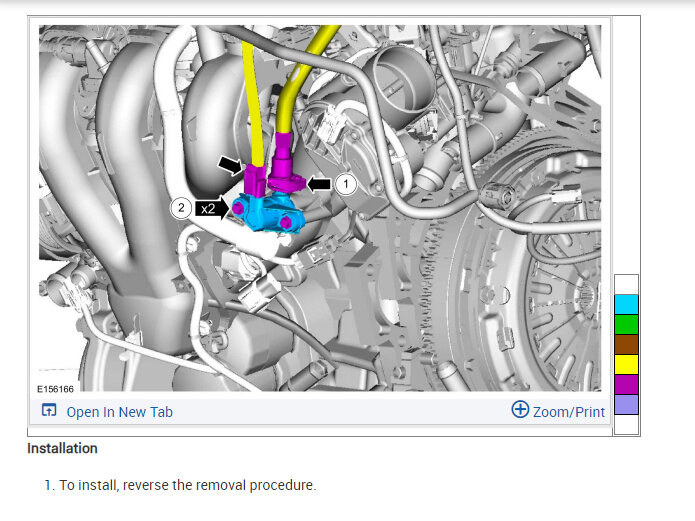

It is on the side of the engine toward the rear. It should be on the side with the exhaust manifold.

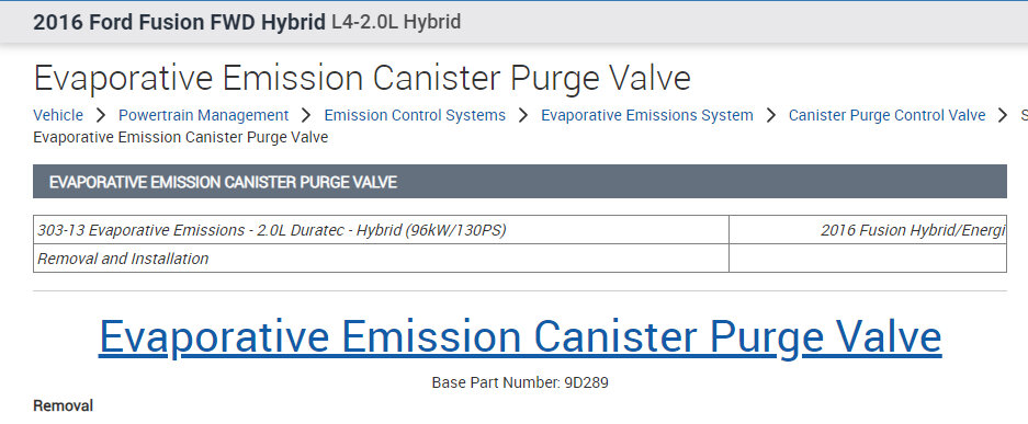

I attached the directions to replace it below. There is a picture showing it. Take a look at the directions and let me know if they help or if you have other questions.

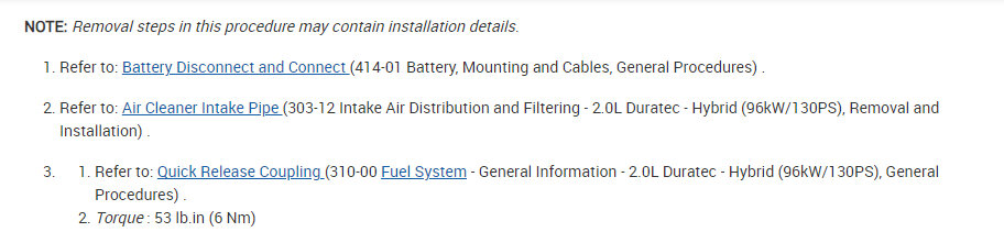

I'm sorry but I don't see the directions please.
Dec 22, 2023 at 3:11 AM
  • 110,244 POSTS
The second picture above is what is listed in my manual as the directions. Basically, first disconnect the negative battery terminal. After that, the air induction tube between the air filter box and the throttle body needs to be removed.
Once those are out of the way, you will have access.
Let me know if you have questions.
