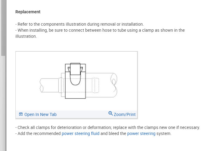

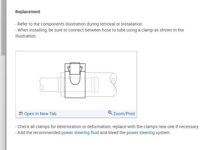

In fact, what I would do is use JB weld on the actual hole and let us start to set up. Then wrap the putty with something to protect it and put a hose clamp on it. This will prevent the weld from moving or falling off.
Clearly this is not a clean or pretty repair but if it is a pin hole it will work.
It may be easier to remove the line to do it and then reinstall it. Plus, that way you can remove the oil and ensure it is clean. If you are going to weld it, you would have to remove it and drain the oil anyway.
