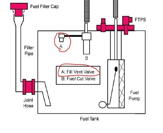

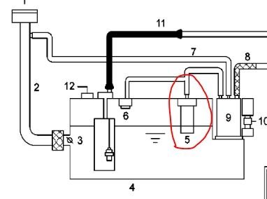

In order to get gas in the car I must fill very slowly.
May 29, 2019 at 11:41 AM
  • 110,241 POSTS
Welcome to 2CarPros.

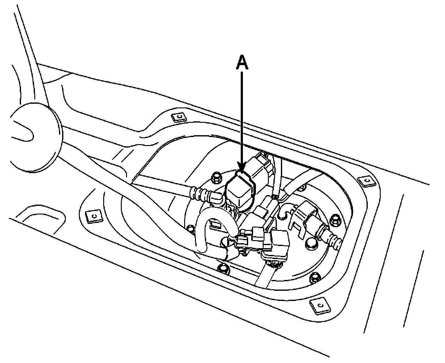

For fuel to enter the tank, air has to escape. This vehicle has a fill vent valve. If this valve is bad, plugged, or damaged, it can prevent air from exiting the fuel tank when refueling. As a result, the pump keeps turning off when you add fuel. That is because the fuel can't enter the tank fast enough and backs up in the filler tube and turns off the pump.
I attached two pictures and circled the component in question on both. Take a look at them. The pictures are of the fuel tank and of the hoses attached to it.
To determine if the vent valve is bad, you will need to remove the fuel tank.

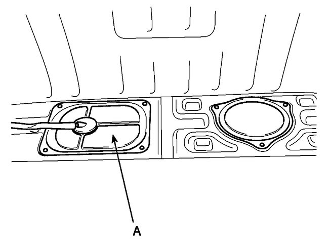

1. Preparation

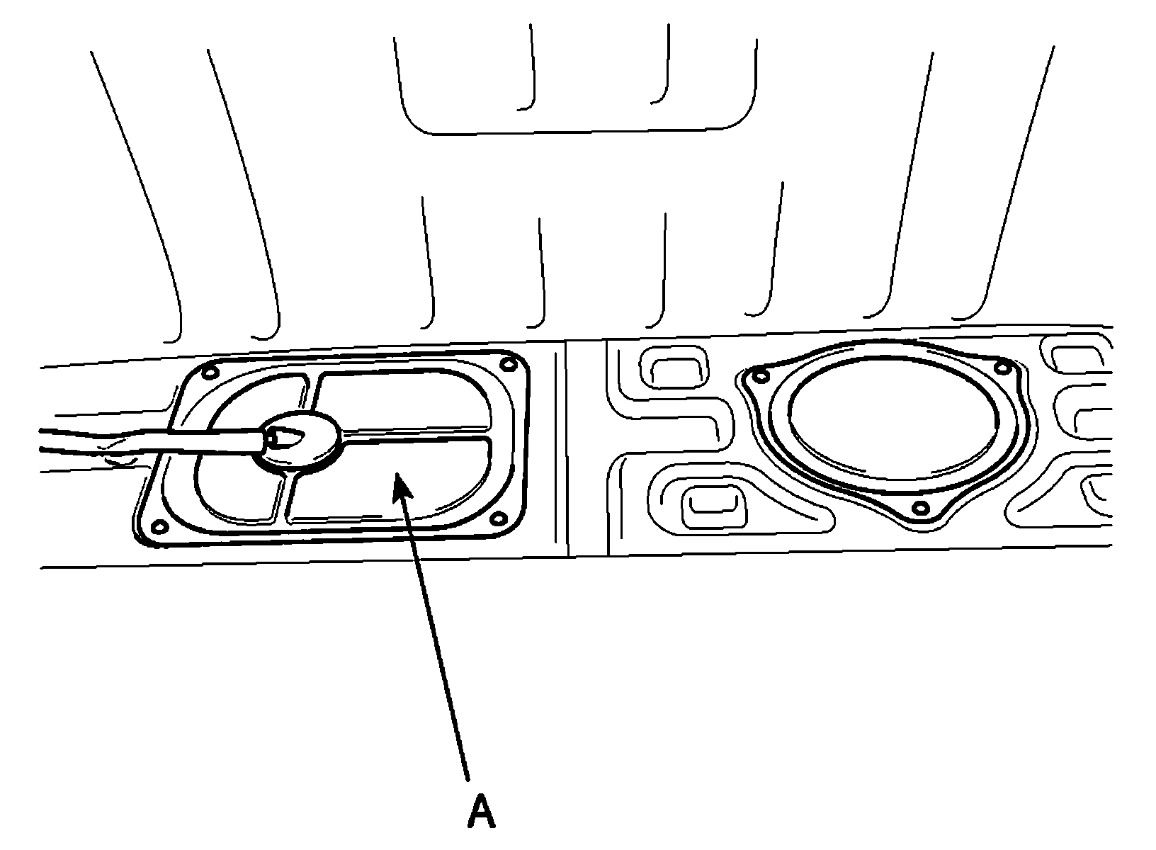

pic 3
a. Remove the Service Cover (A) in the trunk.

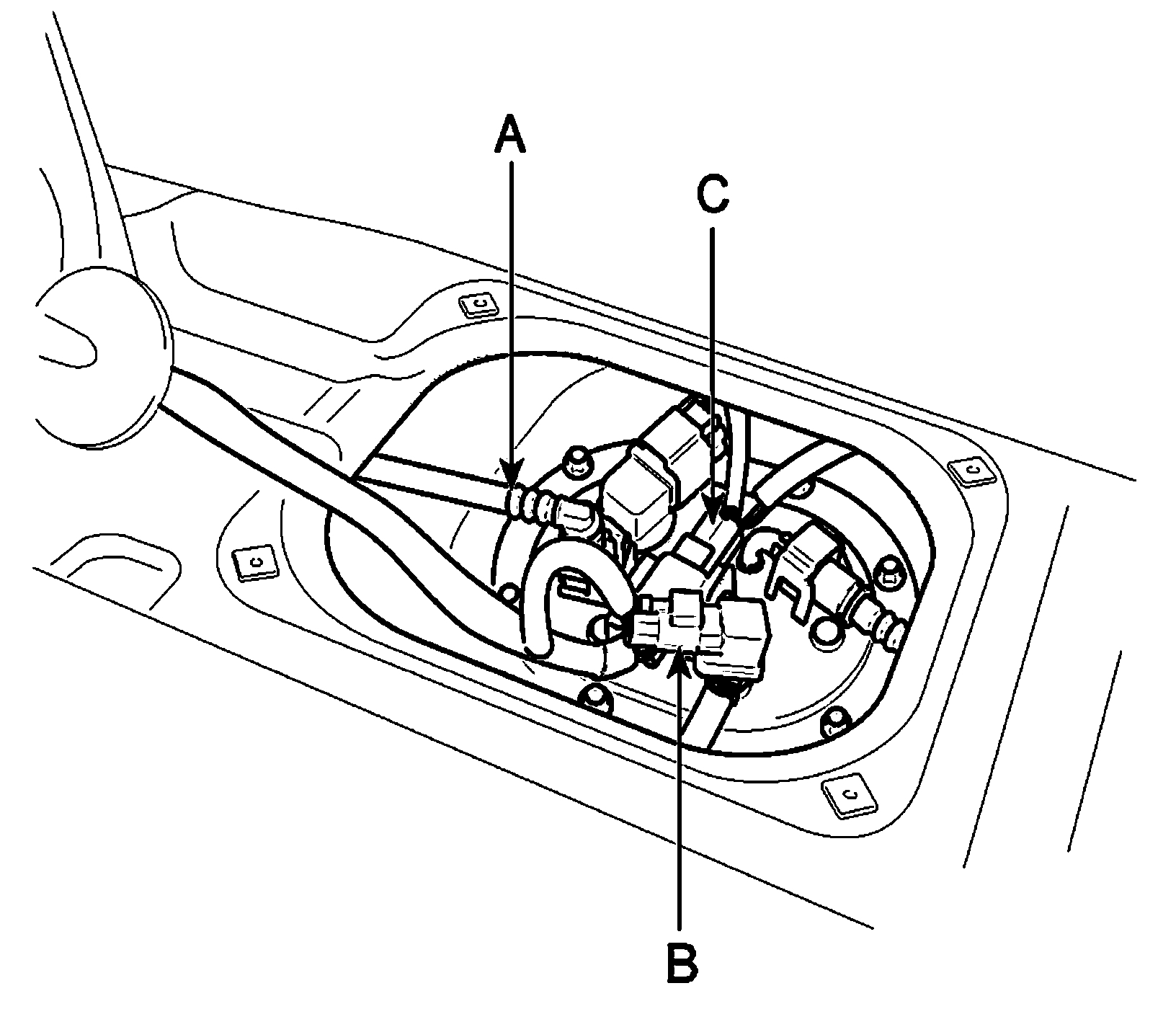

pic 4
b. Disconnect the Fuel Pump Connector (A).
c. Start the engine and wait until fuel in fuel line is exhausted.
d. After the engine stalls, turn the ignition switch OFF.
pic 5

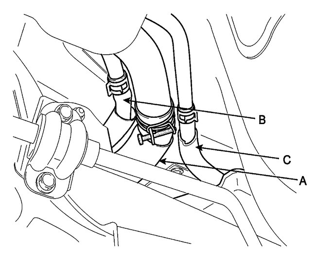

2. Disconnect the Fuel Feed Quick-Connector (A), Fuel Tank Pressure Sensor Connector (B) and Fuel Pump & Sub Fuel Sender Connector (C).

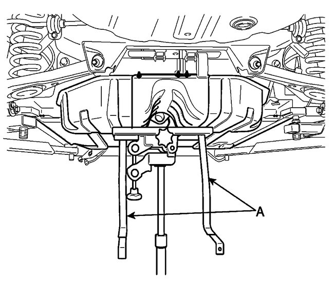

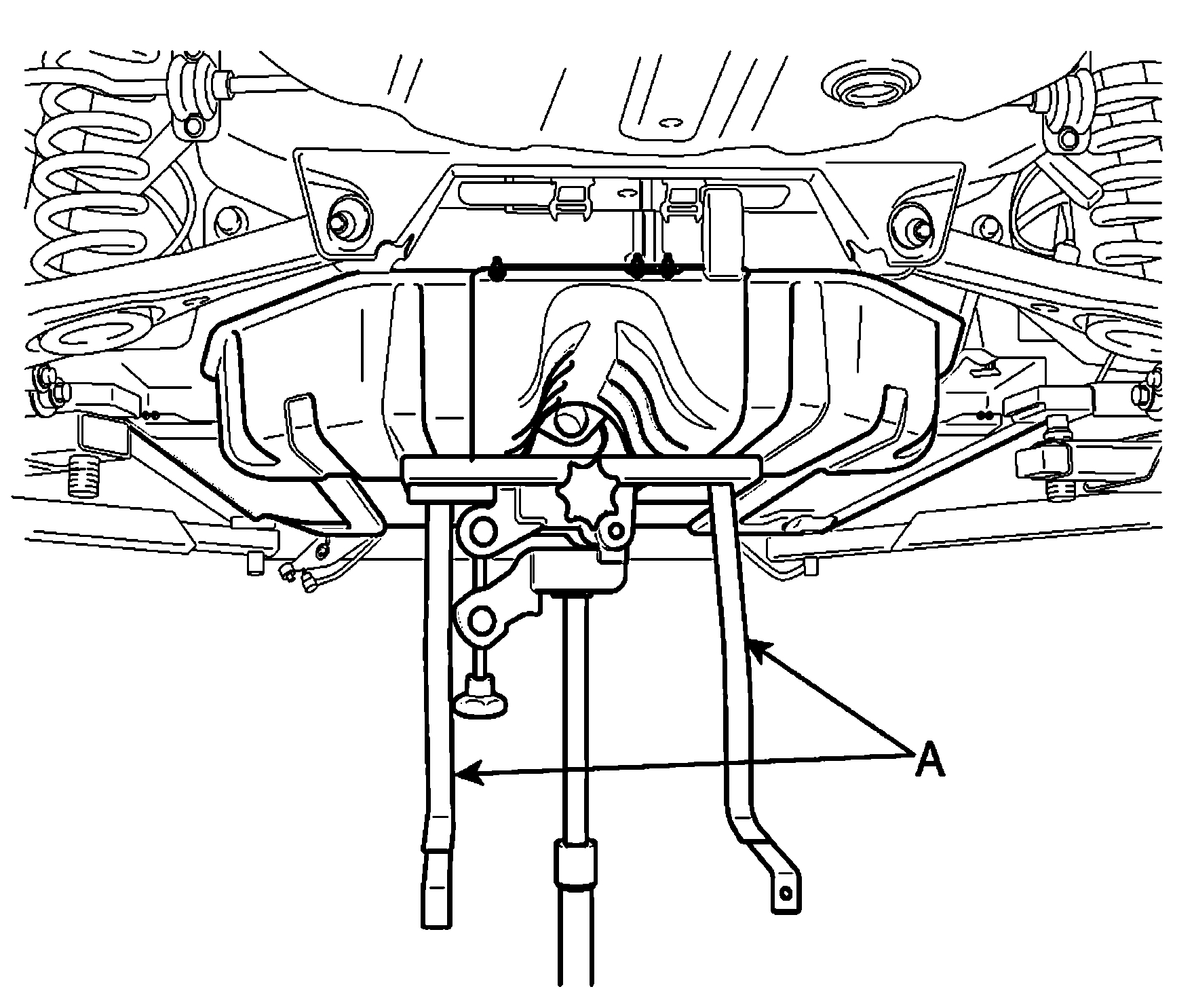

5. Support the fuel tank with a jack and remove the Fuel Tank band (A).

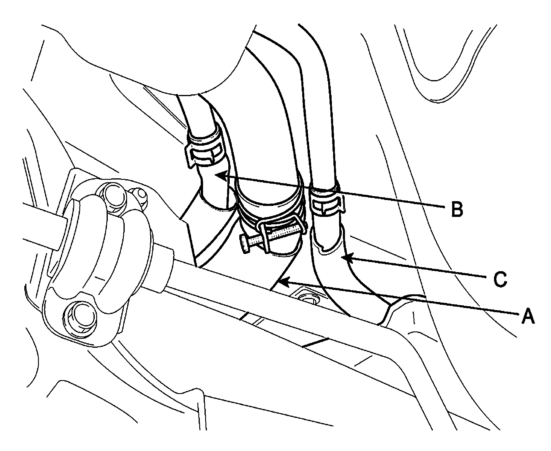

6. Disconnect the Fuel Feed Hose (A), Leveling Hose (B) and Canister Ventilation Hose (C).
7. Disconnect the ventilation hose connecting the separator with the canister.
8. By moving the jack down slowly, remove the Fuel Tank from the vehicle.
