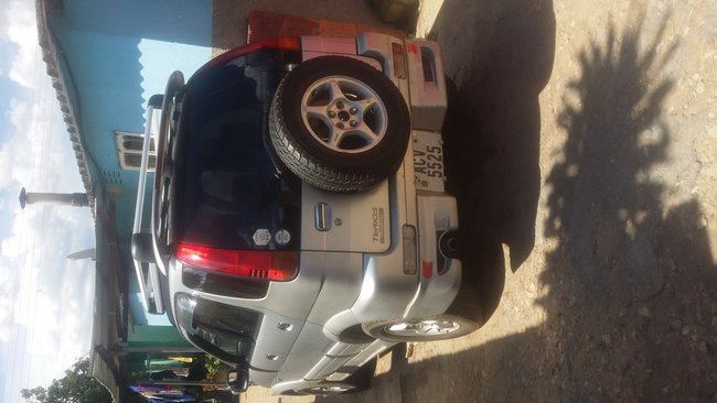

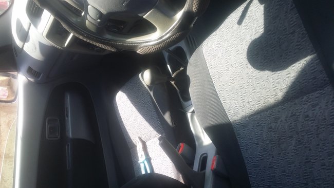

When the engine is running I CANNOT CHANGE GEARS
2000 DAIHATSU TERIOS
108,000 MILES • 1.3L • 4 CYL • 4WD • MANUAL
ELIAS MWALE
  • 5 POSTS
I cannot change gears when the engine is running. But if I stop the engine I can change and move the car. To change to another gear I need to stop the car , which implies that it is a challenge to move in high gears like gear fourth and fifth.
The question is what is the problem? And how can it be solved ?
Please help.
Elias Mwale.
Zambia.
