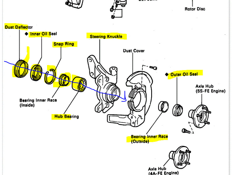

My right front tire is making that tell-tale annoying noise that indicates a wheel bearing is functioning on borrowed time. I went to parts store and got an inside wheel bearing, but then it dawned on me that the hub and bearing may be all one unit? I don't think the guys at the auto parts place would have sold be just the bearing if that was the case, but on the off chance they would I wanted to ask a source I trust, and you guys have helped me countless times and I trust the advice and know-how you provide.

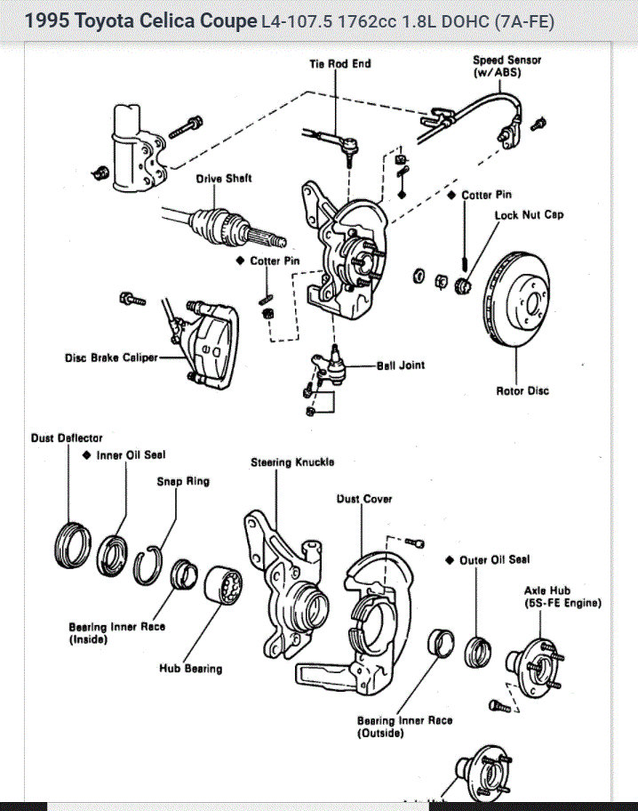

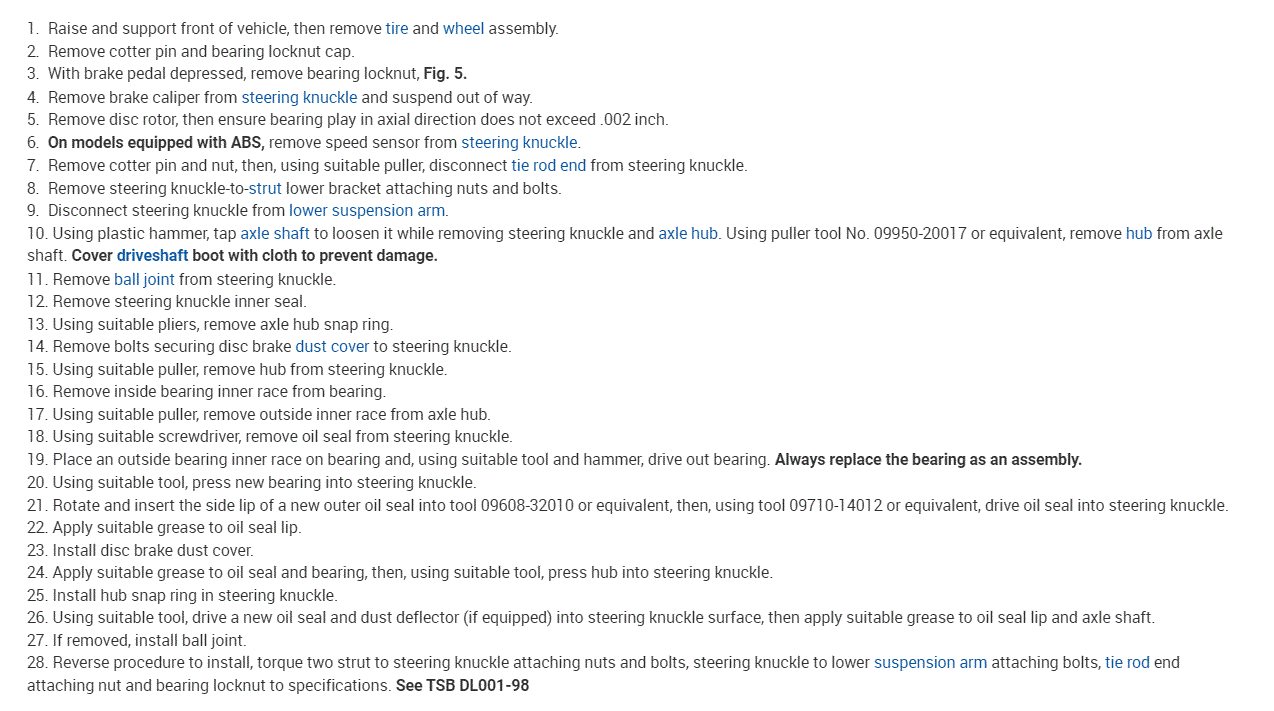

The front wheel bearing is in the steering knuckle and is replaceable. You don't have to purchase an entire hub.
If you look at pic 1 below, I highlighted the parts that will be removed, inspected, and replaced with new parts.
The remaining pics are the procedures for removal and replacement. Take a look through them and let me know if you have questions or if there is something I can help with
