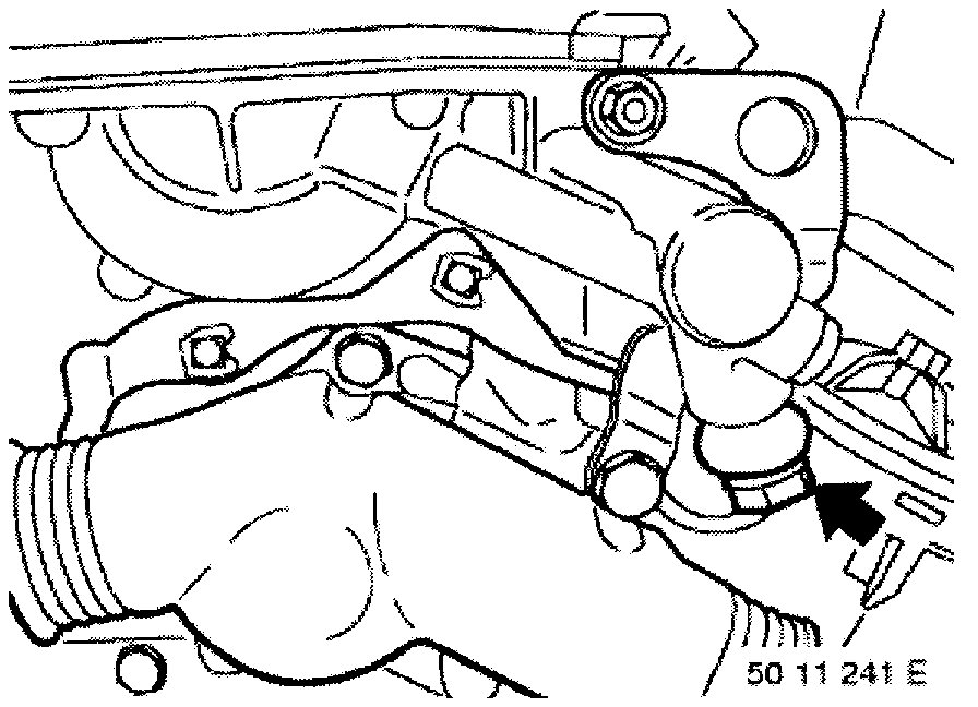

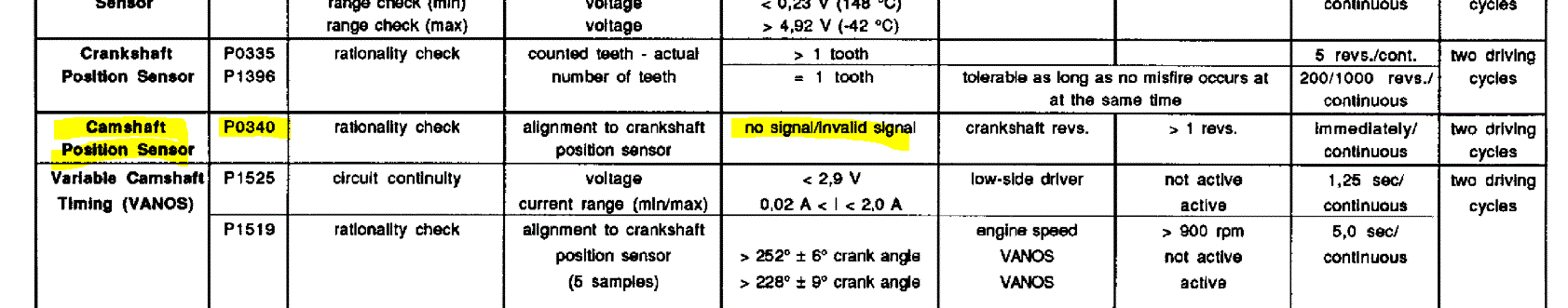

That is a BMW code. It is the same as a P0340 which indicates either the cam sensor is not synchronized with the crankshaft sensor or it isn't sending a signal. See pic 1.
Have you replaced the sensor? If not, the first thing I would do is simply inspect it and the connector to it. Make sure nothing is loose, damaged or corroded. I will supply the directions for replacement so you can see location.

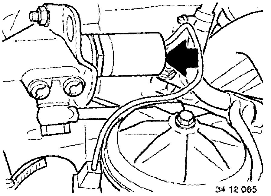

- Interrogate fault memory of DME control unit.
- Switch off Ignition.

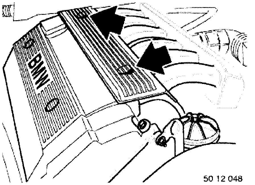

pic 2

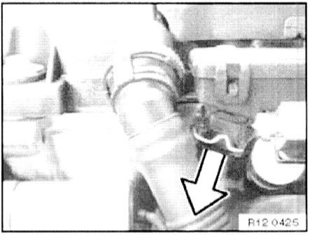

- Remove cover from injector valves.
pic 3

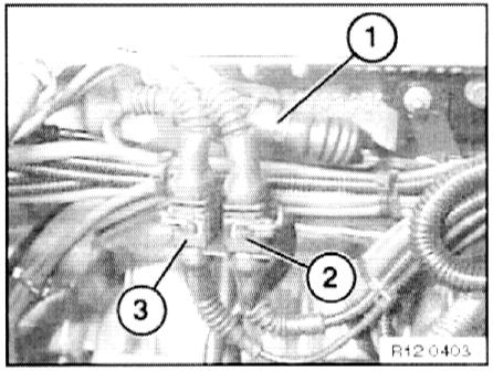

- Disconnect plug connection for VANOS solenoid valve on electrical strip on injector valves.
pic 4

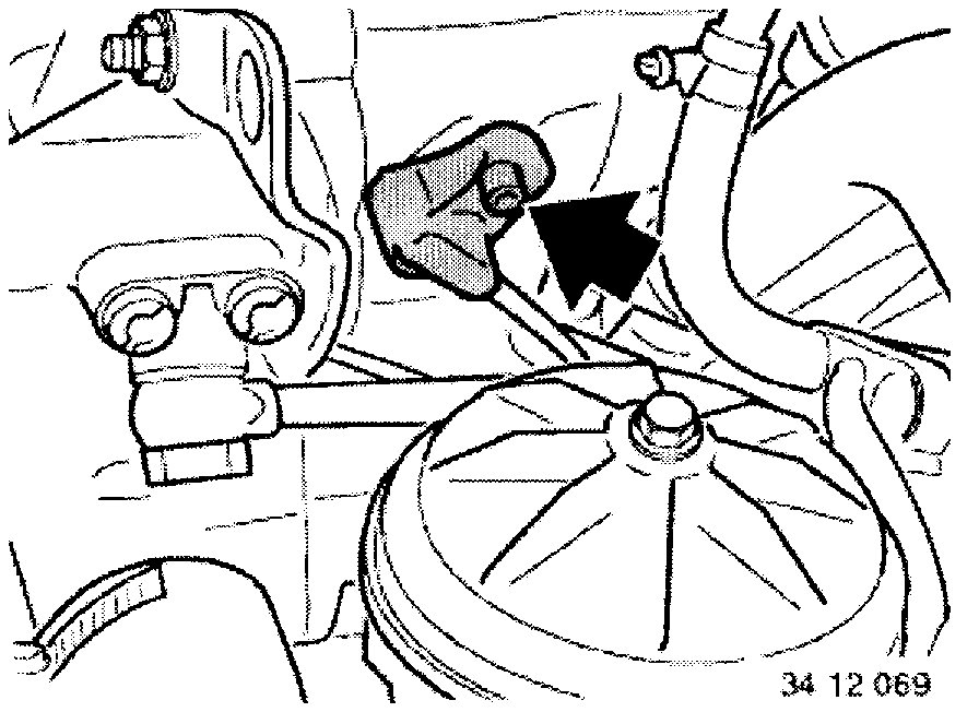

- Release screw on sensor.
Tightening Torque = 5.0 Nm.
Installation Note: Check gasket and replace if necessary.

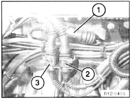

pic 7
- Disconnect plug-in connection(3). Plug connection illustrated here with intake manifold removed.
Installation Note: Interrogate fault memory of DME control unit, check faults in memory, rectify faults in memory, rectify faults and clear fault memory.

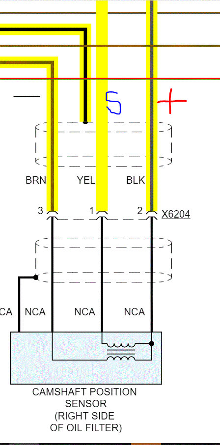

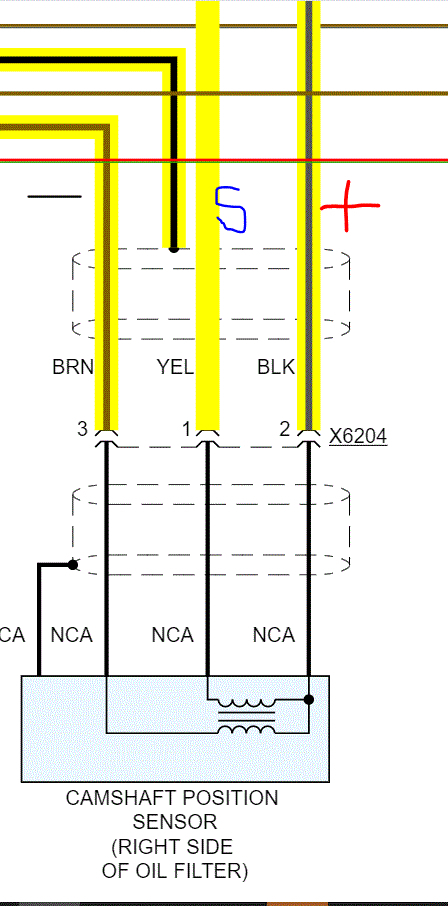

Do me a favor. We need to check things at the connector. The brown wire is ground to the PCM, the yellow is the signal wire to the PCM. The black wire is power from the PCM.
Check for those things at the connector. If they are good, then something is throwing off the timing between the crank and cam sensors. At 180,000 miles, the chain could be stretched.

Sure, with a test light okay? How would i differentiate between the positive and the signal?
Jun 19, 2020 at 12:07 PM
  • 110,244 POSTS
Naser, the power wire is the black one; the signal is yellow. A test light may make things a bit tricky. As far as power, (should be around 5v) the light should turn on when the key is in the run position. Checking signal is different and I don't think it will work with a test light.
Make sure to check for continuity to ground as well.
