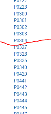

I bought a 20p8 Nissan Sentra with a service engine soon light on. Code P320. I put a new cam position sensor in, but it would not start with the new sensor (AutoZone).
So bought a Nissan sensor and it does not start with the new sensor. Put old ones back in and it will start and run. Idea?
Apr 21, 2022 at 5:27 AM
  • 110,248 POSTS

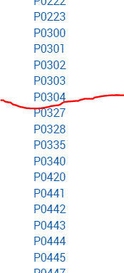

I need a little more info. The code, P0320, isn't listed for this model. Also, you mentioned replacing the cam sensor. A p0320 is related to a crankshaft position sensor or the engine speed input circuit.
Do me a favor. Check to see if there is spark to the plugs. Also, if you have a live data scan tool, check to see if there is an RPM signal when cranking.
https://www.2carpros.com/articles/how-to-check-for-ignition-spark
Also, take a look at the code list below. Note there is no P0320 listed for this model.
Let me know what you find.
