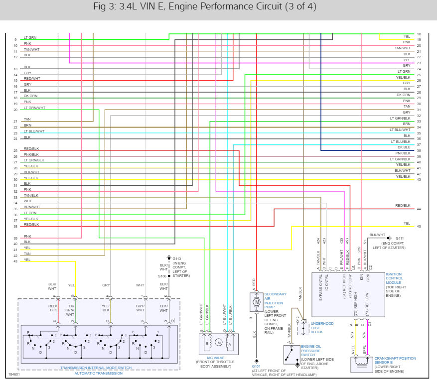

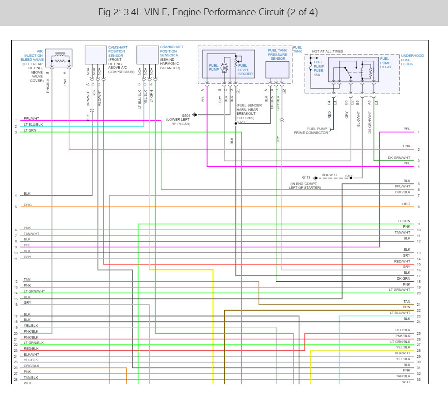

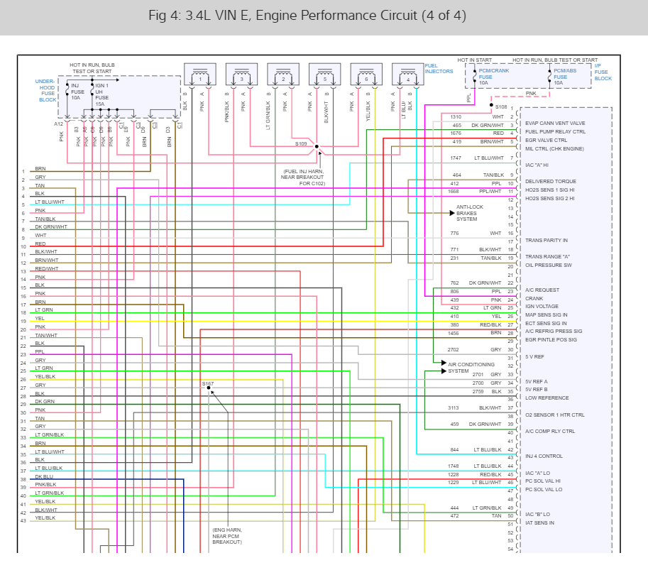

Could you please tell me which wire is doing what in the cam sensor circuit? I have a red/white, black and brown/white wire. Need to see if i have an open in one of the wires because i have a code P0341.I have replaced the sensor but it did not help. Thank you very much, Fredrik
Aug 31, 2017 at 7:15 PM
STEVE W.
  • 15,345 POSTS

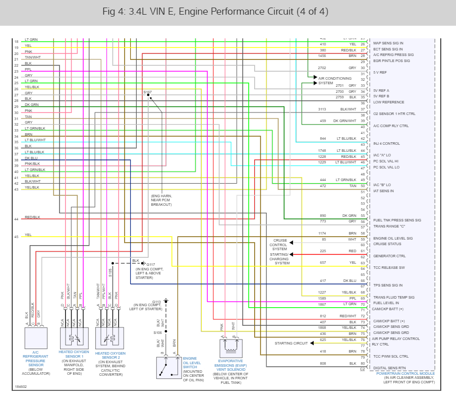

Red/White = twelve volt ref. Black = low ref (ground). Brown/white = square wave signal (becomes a black wire after the connector). This guide can help you test the wiring with the engine wiring diagrams below.
Check out the diagrams (Below). Let us know what happens and please upload pictures or videos of the problem.
