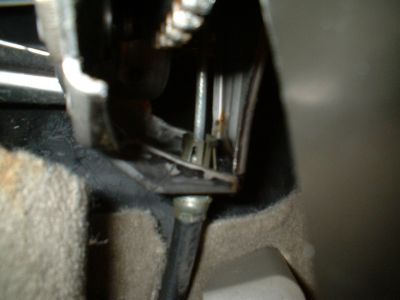

I need to replace the foot pedal assembly. I have new assembly. Have removed the three bolts hold it and now the cable is held in place with a cable sheath that is attached to assembly with an expansion clip that cannot be accessed to compress.
How do I remove the cable sheath from the asseembly frame? [img:248f2a1a9b]http://www.2carpros.com/forum/automotive_pictures/149235_Brake_assembly_003_1.jpg[/img:248f2a1a9b]

pinch the prongs with needle nose plyers, do not brake them
