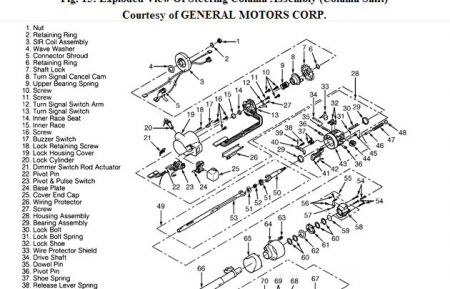

How do you fix the steering column if its loose
Thursday, September 16th, 2010 AT 9:41 AM
HMAC300
  • 48,601 POSTS
If you are talking about thecolumn loose at the top by the wheel then there are a couple of htings. It could be the bearins in the columnor shaft are loose as it's probably a tilt wheel or the collar is loose and flopping around. the whole top part of the column has to be disassembled and boldt tightened then put back together.
https://www.2carpros.com/forum/automotive_pictures/406719_steering_column_2.jpg
