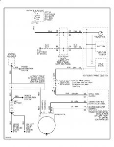

....when I first start my truck, the battery light comes on and the voltage gauge shows 8 or 9 volts. after driving for a few minutes, it goes up to normal 14+ volts and the light goes off. problem does not surface again while driving, only when it is started again......suggestions????

Test at the back of the alt (big wire) with a meter when first started to see if the alt is actually putting out but the gauge is slow to come up or if it isnt charging. Could be a wiring or gauge issue

The alternator is not putting out when first started. I didn't test, but lights are dim, so not guage problem. After about 15 minutes the alternator appears to work, and stays working until next time when car is cooled down.
May 29, 2009 at 1:50 AM
2CARPRO JACK
  • 11,533 POSTS
Sounds liek it may be thealt then, but hteproblem is that the alt is controlled by the PCM, so hopefully it isnt an issue with it.
https://images.2carpros.com/forum/automotive_pictures/1639_alt_1.jpg

An 02 with 145k, an alt wouldnt be out of the question, far more common than the PCM.Usually if the PCM sees low voltage it will set a check engine light.usually ascan tool would be used to see what kind of system voltage the PCM is seeing to determine which it is.I doubt the belt has anything to do with it.

Final comment. Three times now I have started the truck, the voltage gauge is reading around 10V, I give the alternator a rap with a hammer(not hard), and the guage shoort right uo to normal. Whats up with that?
May 31, 2009 at 8:07 AM
2CARPRO JACK
  • 11,533 POSTS
Ah, the old hammer test.....lol sounds like a bad connection in the alt

lol a bigger hammer would be cheaper, but it sounds like you need a new alt.Bad connections can either make contact when warm/hot or lose contact, depending on the situation.That is how you used to check ECM's back in the day, slap them with your hand, if the car reacted it needed a new one
