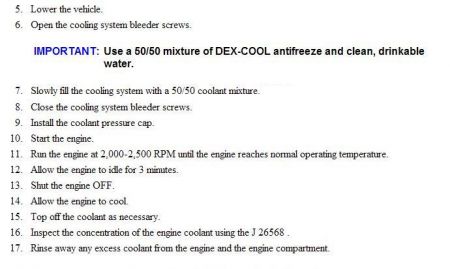

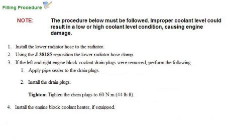

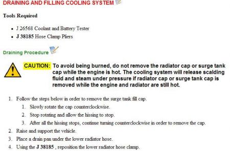

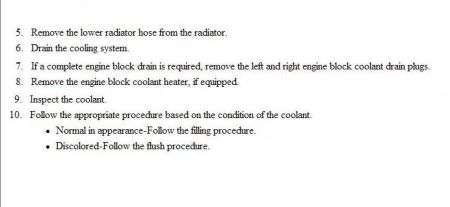

How do i drain the anti freeze from my truck and how do i fill it back up.They say if you do not get the air out you could burn up the engine.

https://images.2carpros.com/forum/automotive_pictures/261618_Noname_944.jpg
https://images.2carpros.com/forum/automotive_pictures/261618_Noname2_258.jpg
https://images.2carpros.com/forum/automotive_pictures/261618_Noname3_94.jpg
https://images.2carpros.com/forum/automotive_pictures/261618_Noname4_50.jpg
Sep 7, 2009 at 1:31 PM
