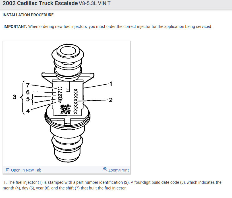

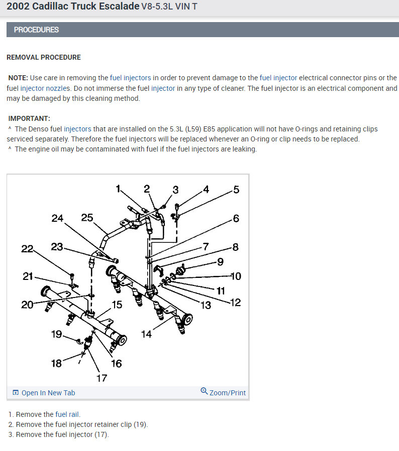

It is leaking gas. It sat for about a year or so. Not sure if maybe that may have something to with it. It's leaking from the front.
Oct 1, 2010 at 2:35 PM
SQM
  • 6,383 POSTS

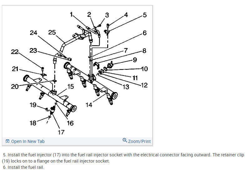

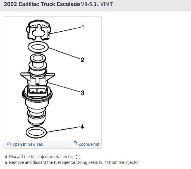

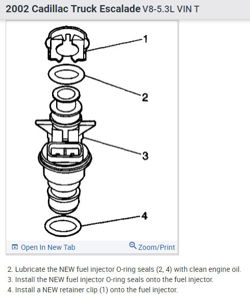

It sounds like you might have dried up injector O-rings and that's why its leaking.
You will have to replace the O-rings in order the fix that leak.
There are O-ring kits that you can purchase for any auto parts store, and you can use those to replace the worn O-rings.
Use care in removing the fuel injectors in order to prevent damage to the fuel injector electrical connector pins or the fuel injector nozzles.
https://www.2carpros.com/articles/how-to-replace-a-fuel-injector
